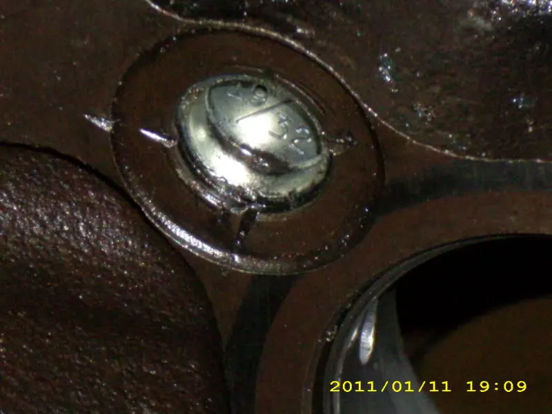

Take a flat blade screw driver or a flat blade punch and stake the press in plugs in around the edges in three spots, this will help retain them.
