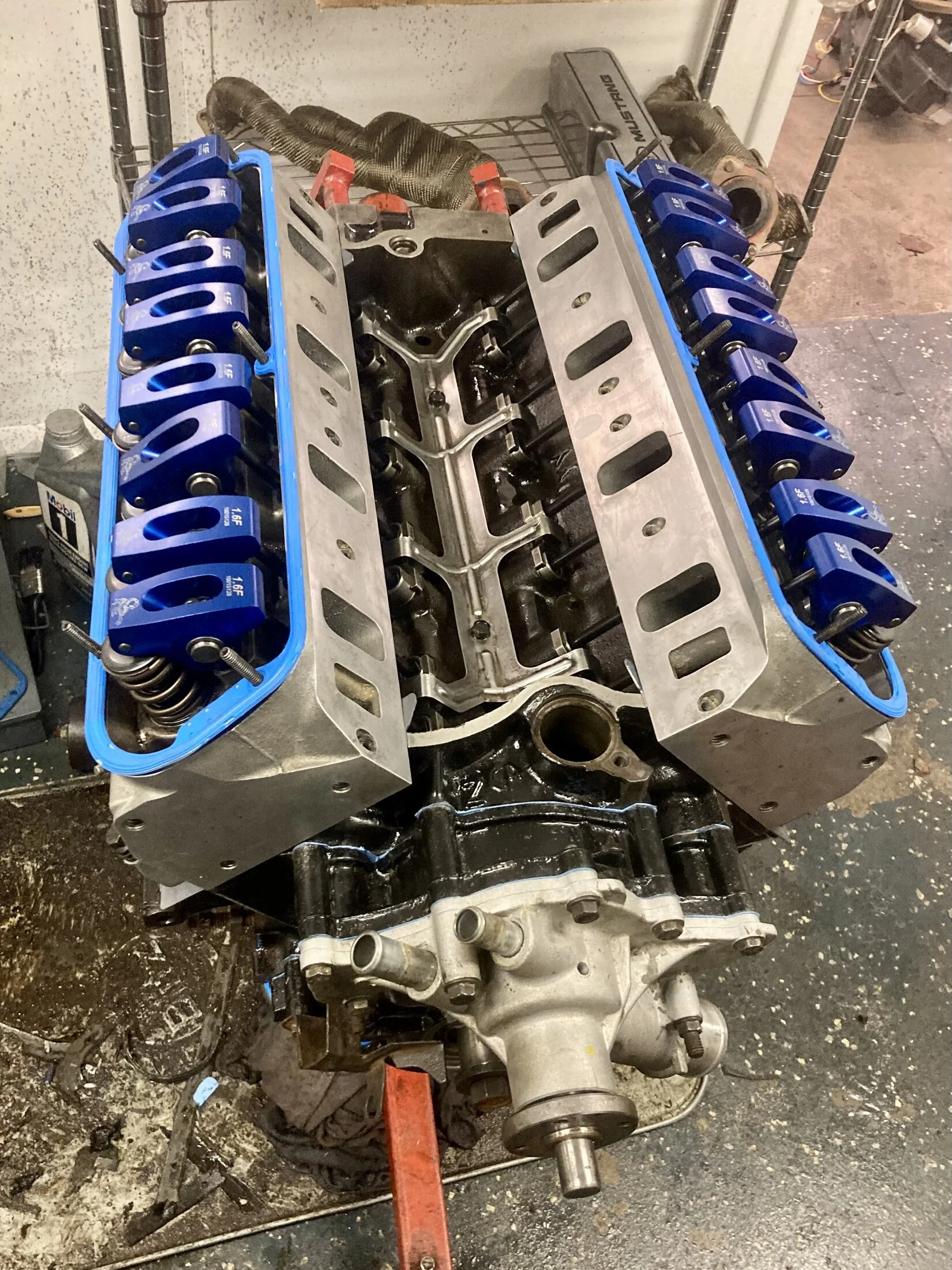

Just finished rebuilding the 5.0 for my son’s 1995 GT (Trick Flow Cam, Keith Black -3.00cc Pistons, Blueprint Cylinder Heads, Ford Performance R302H Lifters, Roller Rockers, etc…). The new, taller valve covers both have the breather holes in them. The lower intake (GT40) also has the PCV hole in the rear (and we have the OEM PCV).
My Question is, do we run the PCV to a catch can (using the lower intake position in the middle of the motor), run only a single breather in one valve cover (and which side), run the PCV and a breather in both valve covers, PCV and a breather in only one valve cover (and plug the other), only run breathers and cap off the PCV, or what …. and why?
Thanks so much for the help with this.
