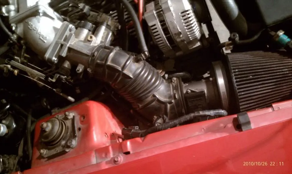

I have the following air intake on the new 95 stang I just got. (see pics)
It blocks the oil filler plug. Can I convert this to something a little more friendly?

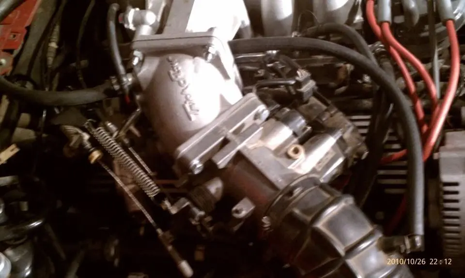

1. A 3/8'' spacer is needed to clear the EGR when using a aftermarket intake manifold.
2. The TFS elbow there is needed to use the 94/95 TB set up. However you can convert to a fox body TB set up and still utilize the internal EGR provisions depending on what "cobra" intake you have. Or you can do what everyone else does and delete it.
3. You should be able to heat and bend the fill tube.
I used a 70mm Accufab TB and Spacer, Fox Throttle cable and bracket, Fox IAC Valve, Fox egr and finally the heater tube from a fox body with the coolant line port (to retain stock fox body cooled EGR passage in spacer). Essentially i converted the system to an internal style EGR system unlike the 94/95 which is though the port on the pass side header. All of this was done without using a spacer.

Here is what I have. The oil fill plug is located right under the IAC valve. My EGR tube is disconnected from the exhaust but the plug and vacuum are still hooked up. The check engine light is not on.

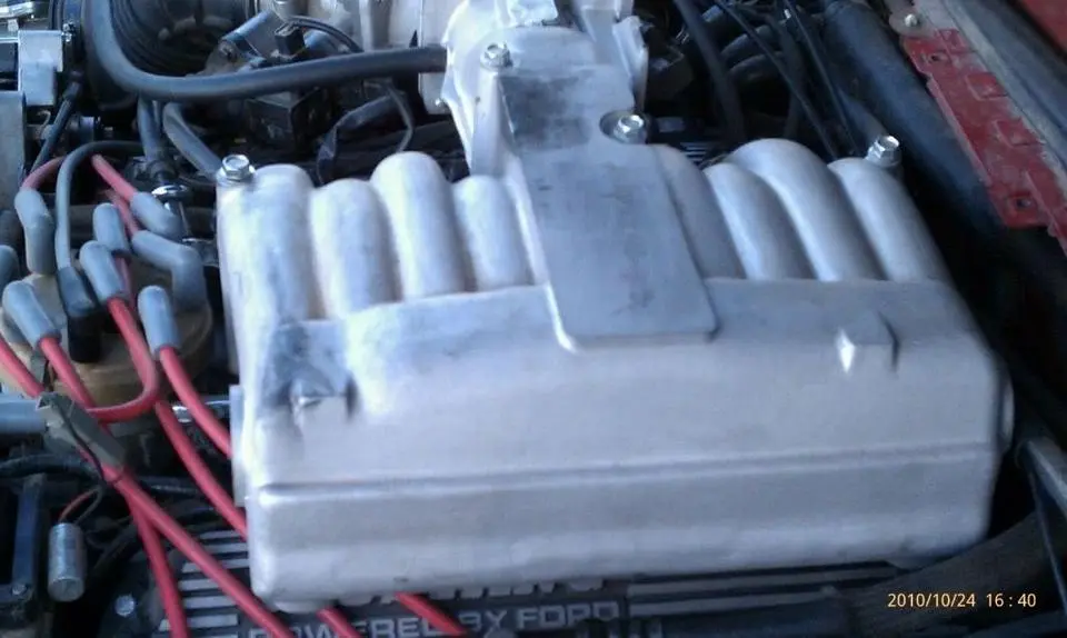

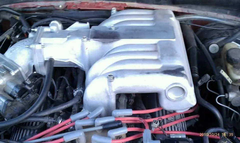

I have included picture of my intake. Can someone id which Cobra intake I have?

The valve covers are designed for a Fox Body Mustang, and not designed to work on the 94/95's with the elbow.
You can try and make your own air intake, most likely the cheapest option, and see what you can come up with.
But, by looking at the pics, the only other option might be to convert to a Fox style throttle body.
