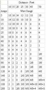

Be sure that the cable from the alternator is of sufficient size to carry the full output of the alternator without any problems. See the chart below, and measure the cable length as part of you calculations.
Wire size current table:
53745d1205096904-how-determine-proper-fuse-wire-size-wire-gauge-current-capacity-lenght-chart.gif
yea gonna be running some 4/0 back to the battery, biggest wire i could find. have all the fuses and fuse blocks ordered. already have a 0 gauge in there for all the grounds and positives to solenoid n such. running positive from alternator output with 4/0 and negative from mounting bracket with 4/0 to rear battery
