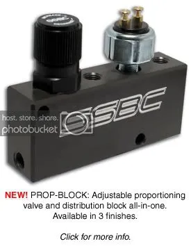

2Blue2 will be trying this sex one when I can find it Mod Dude Mar 5, 2019 4,450 2,918 163 Oahu Aug 15, 2019 #2 Aug 15, 2019 #2 David A said: e. Do I need a different distribution block or proportioning valve. Click to expand... Yes especially if running big and littles and they have a bracket to hang it off the MC. The SSBC PV is slightly better looking Will also need residual pressure valves, 10 psi for disks and 2 psi for drums. and at this point put a line lock in for fun too, damit!
