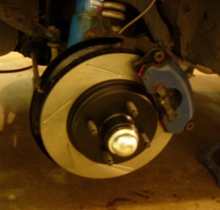

I installed all the parts listed below and will post pics soon. I bled the system with both a 2 man system and then a pressurized bleeder, but the brake pedal still doesn't feel right. When I apply the brakes, the pedal moves down until its pretty much even with the gas pedal (cant remember if it went that far before), and it doesn't feel like the brakes are doing much until the pedal is down that far. The brake pedal also feels a little spongy when I pump the brakes and the car is off. Any input on this would be greatly appreciated. Thanks in advance.

sorry it took so long to post pics i have been very busy with my new job and could not find the cord for my camera.
