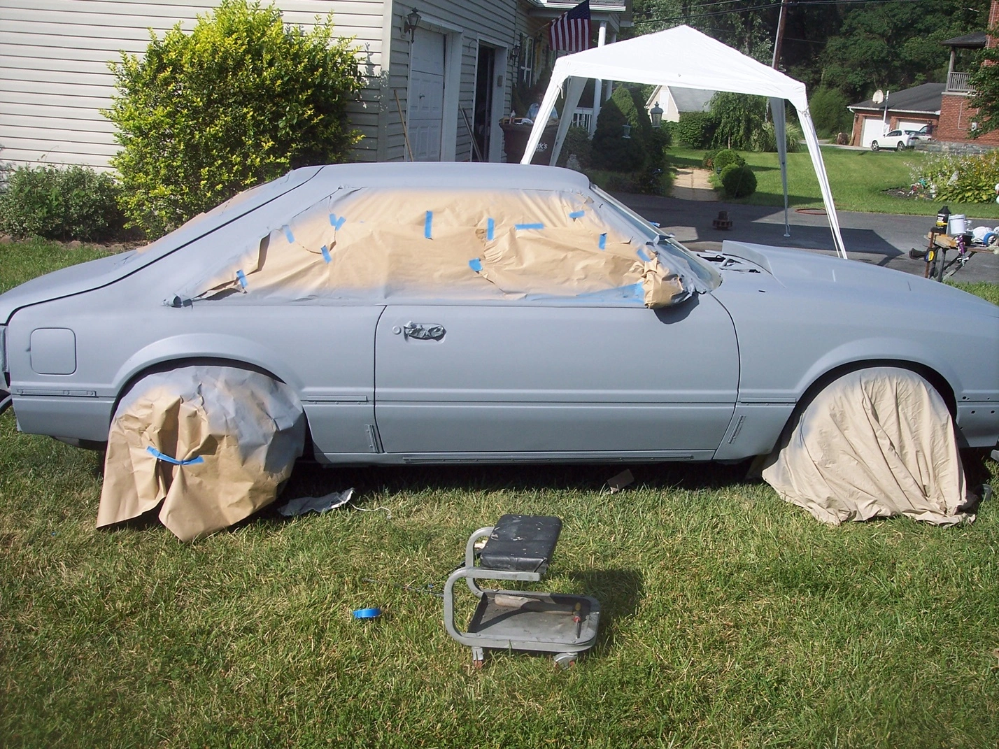

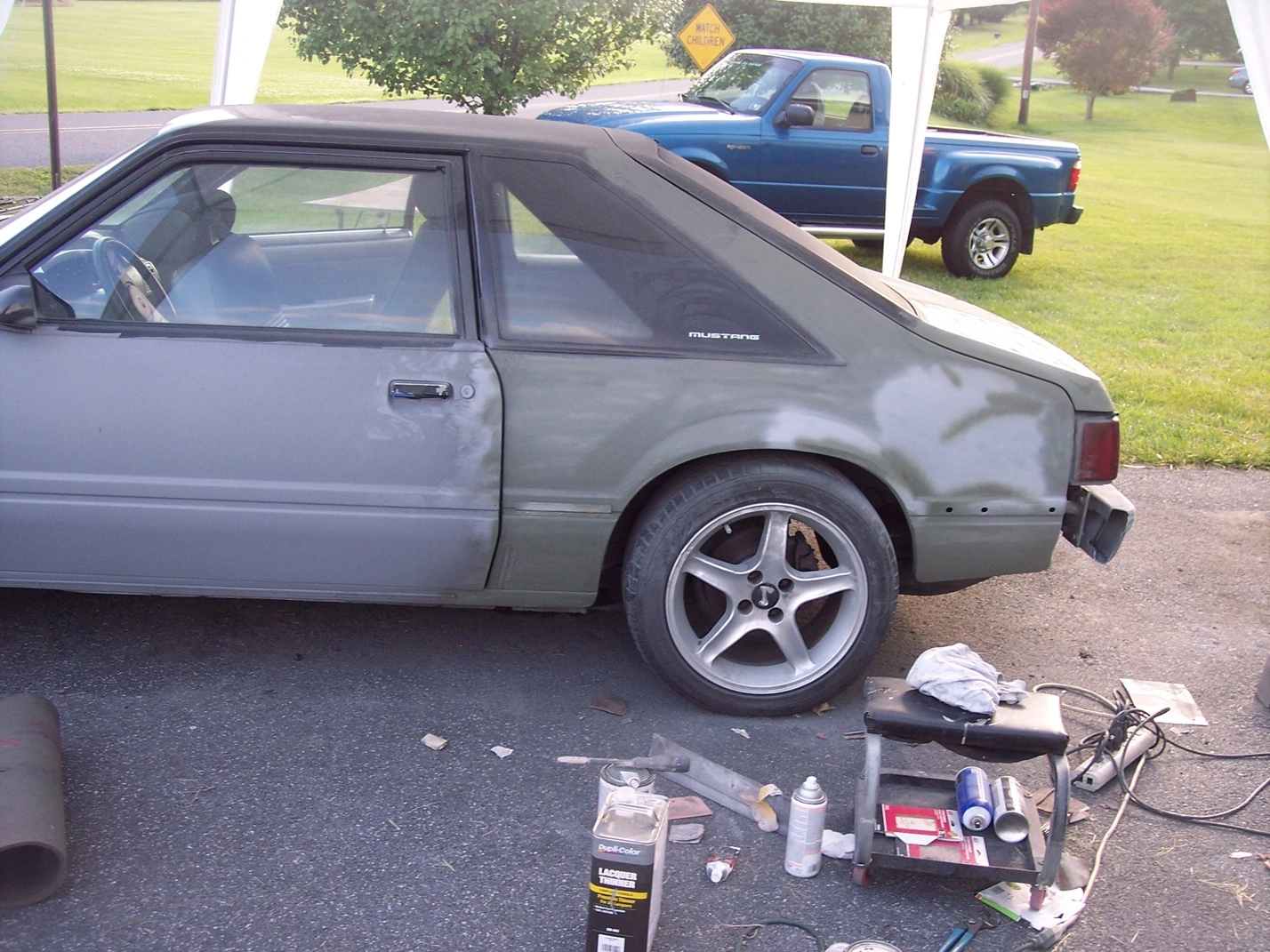

I have finished sanding the entire car down to bare metal, shooting it with epoxy self etching primer and then spraying on a good gray 2k primer and that's where we are right now.
I'll leave it in primer till the weather cools off then I'll pull it off the road to finish the final paint prep and spray it with a candy apple blue, that's my plan right now anyway.

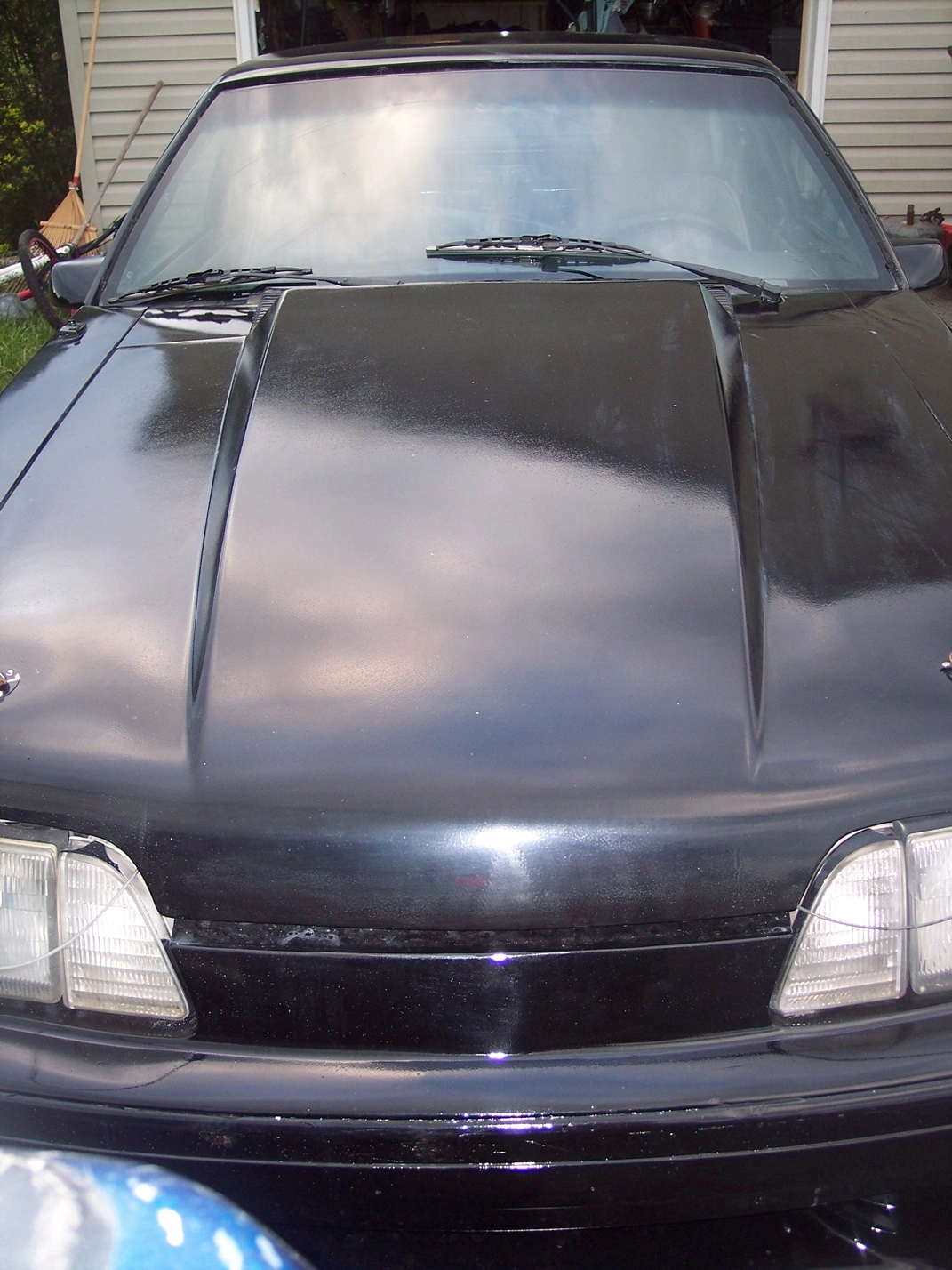

Wow that hood pic shows how caked on the old paint was. It's a lot of work now, but I am sure you're going to have one nice ride once you get it all back together. Nice work so far. Keep us posted!
That paint looks like it would have been a bi tch to remove! Keep trucking and post pics for us.
PS - Check out @madmike1157 's thread and how not to use one of those canopy's for painting...

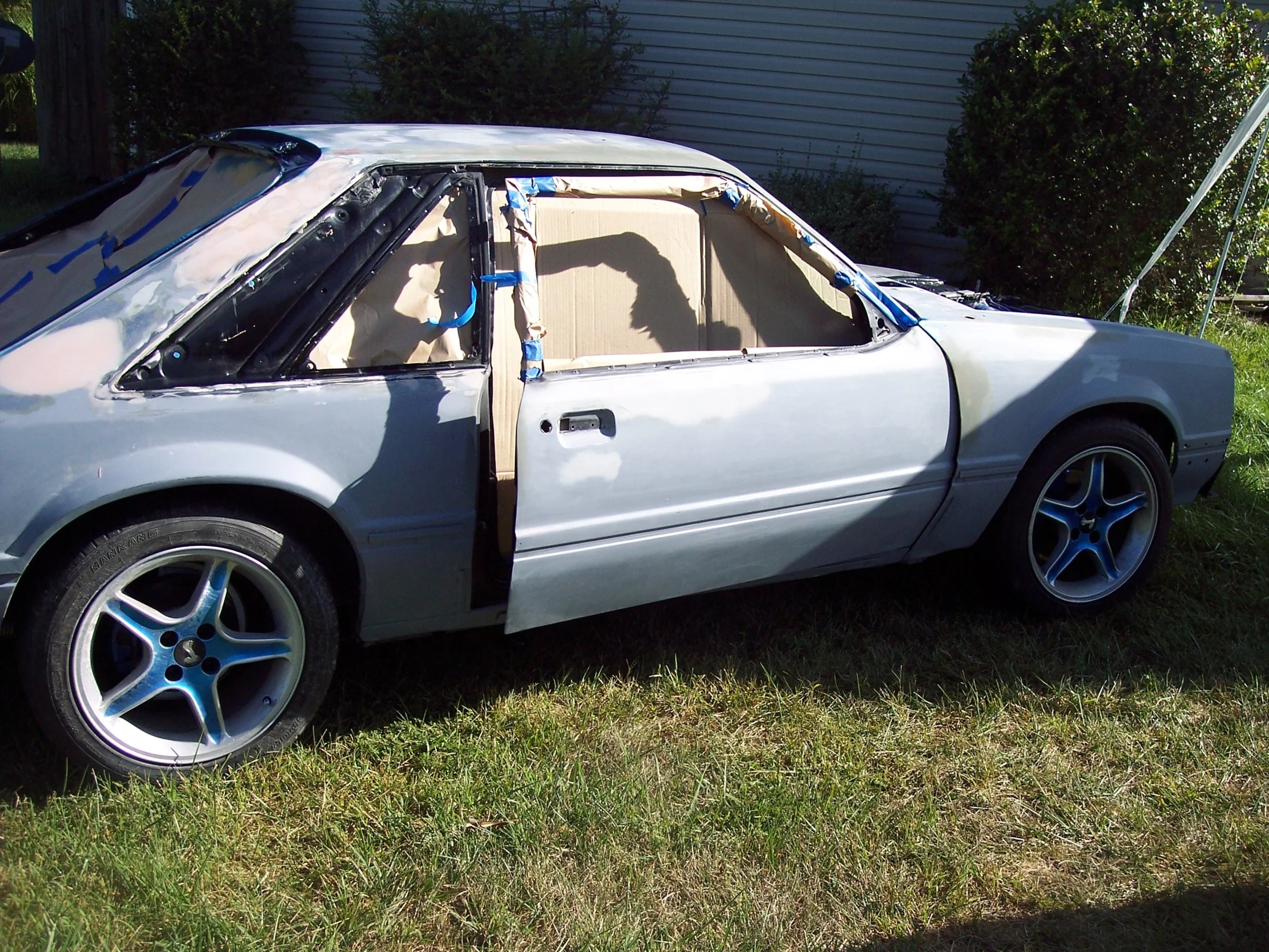

Yea It was thick, I don't know what it was but it didn't come off easy. Especially on the rubber parts, paint remover wouldn't touch it. but it's all off now and have most of it back in primer. Things are moving in the right direction.

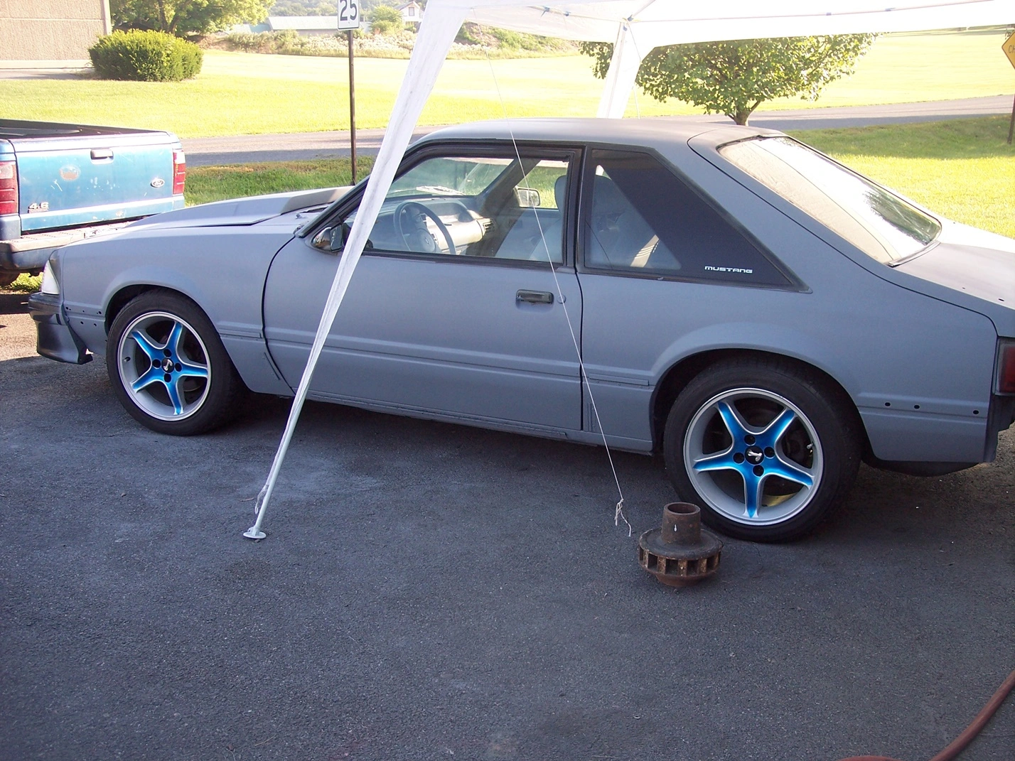

BTW, I really dig the blue on your wheels, nice accent.
Hey thanks, I was caught up one evening and I had been looking at the cobra wheels (which I already liked) and still had a couple hours of daylight so I said what the heck, maybe pull one wheel and see what it looks like and that's what I came up with and I liked it. It doesn't look so great with the car in primer, kind of like lipstick on a pig.

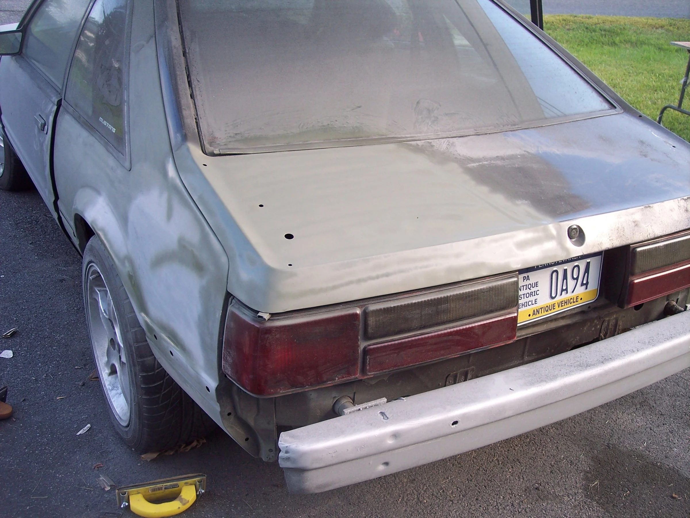

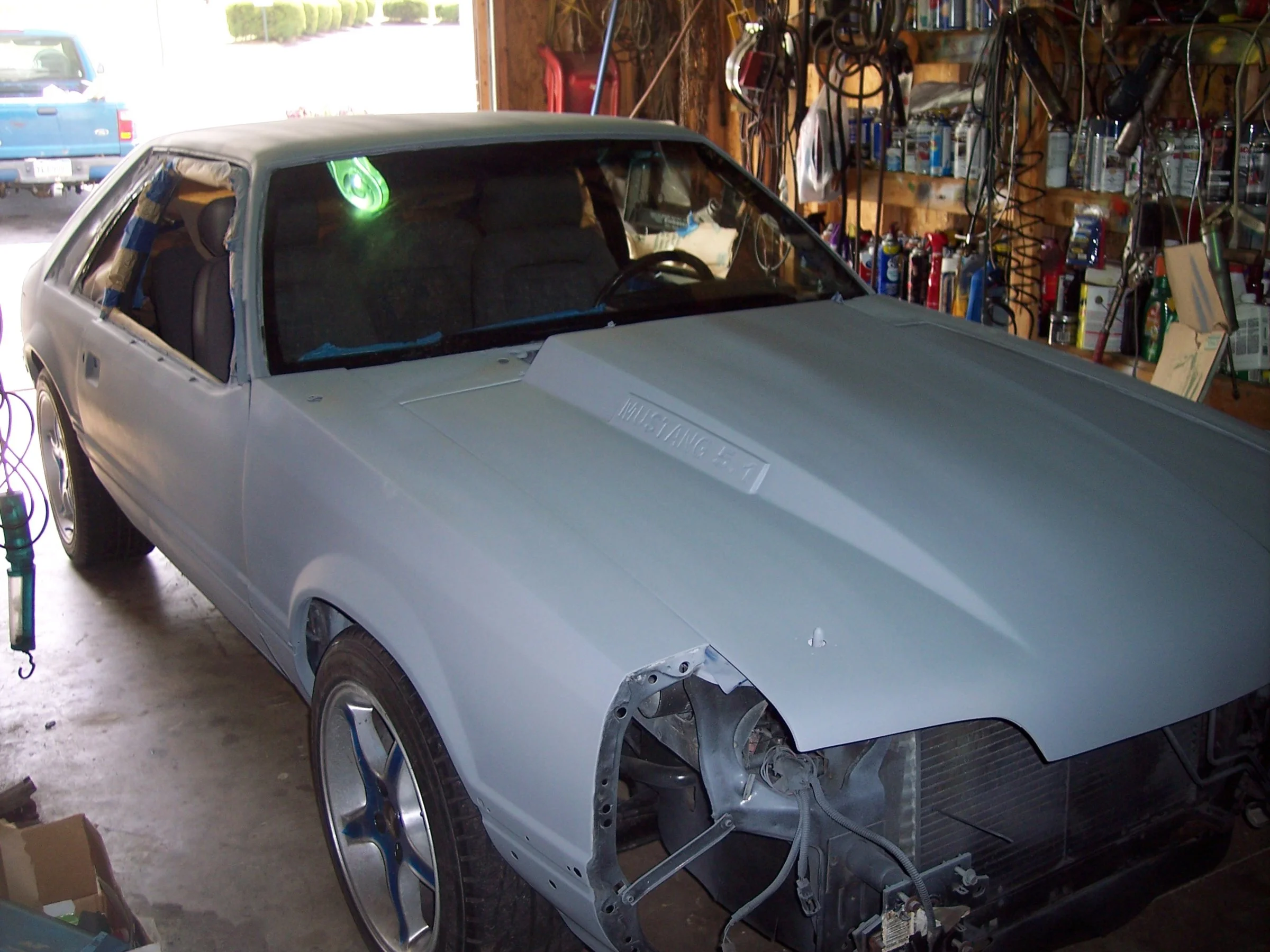

102_0320.webp Been plugging away with the car, I have done all the body work, reprimed it and blocked it down with 400. looks good now, I also pulled the motor out this week to begin to freshen up the engine and engine bay. Motor is good no need to disassemble just pulled the intake and valve coves for some fresh paint and trim. Engine bay is another story, I'm going to try and shave and hide as much as possible, should be interesting.
Oh, btw I have been talked out of doing the candy color, talked to a couple of suppliers and they warned me that not only is it difficult to paint but it fades fast in direct sunlight. Mostly for show cars that are garage kept and don't see the sun to often. Bummer but not going to waste a lot of time and money on something that won't last. Finally settled on a Honda metallic / pearl blue called agean blue. I like it and I think it will look good on the car. Still waiting for cooler weather, it's been in the upper 90's for a long time here in south central pa.

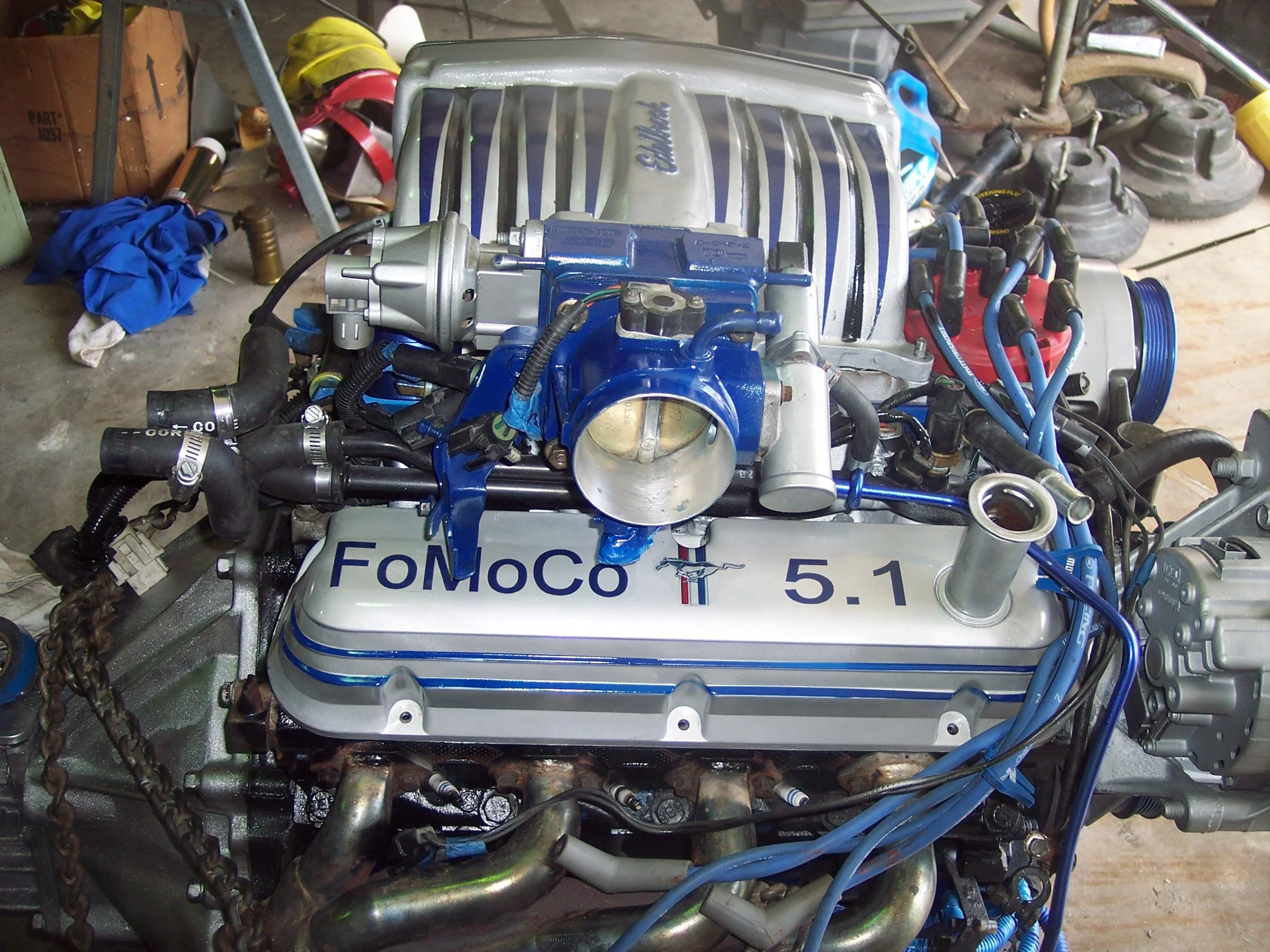

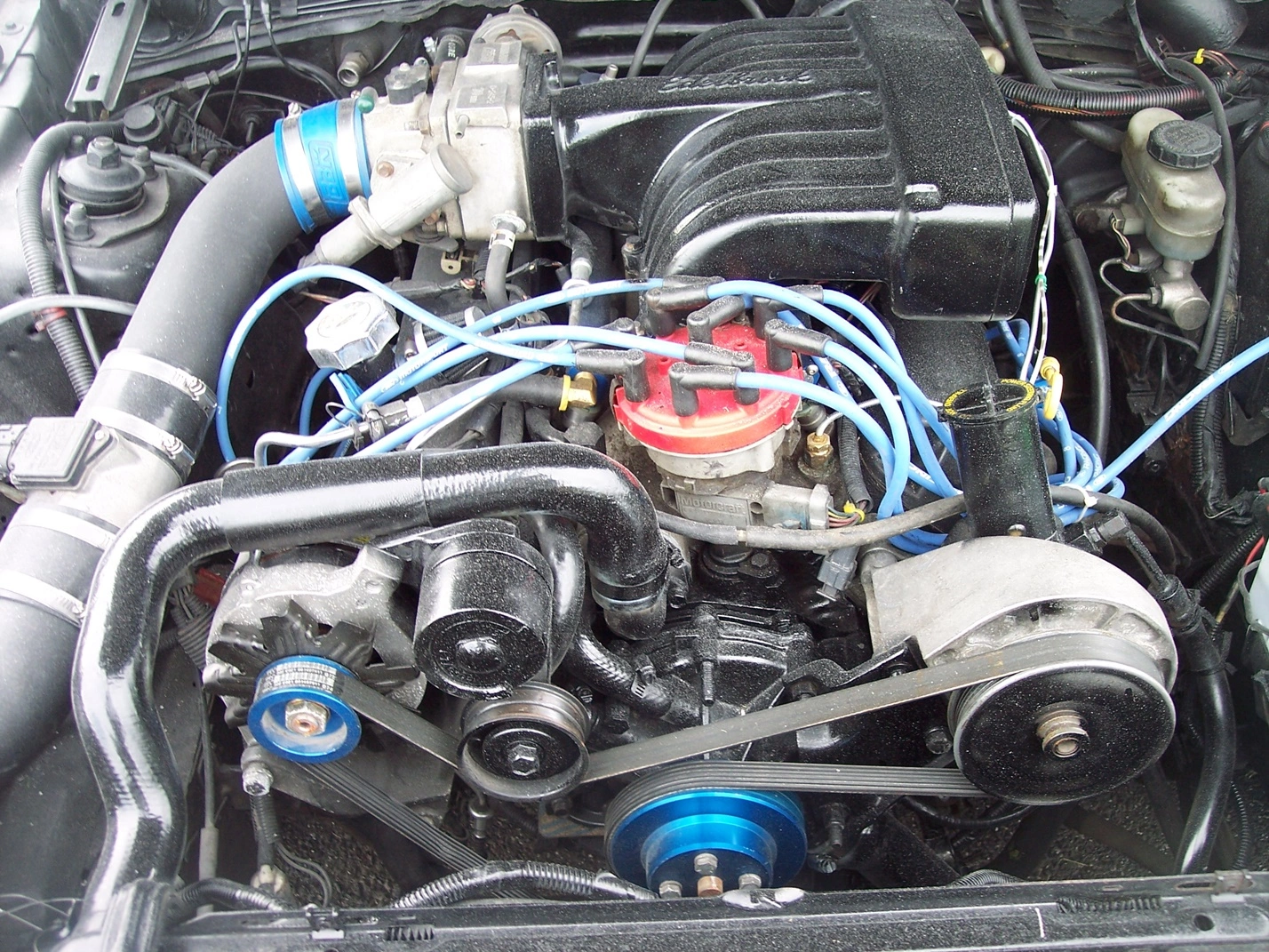

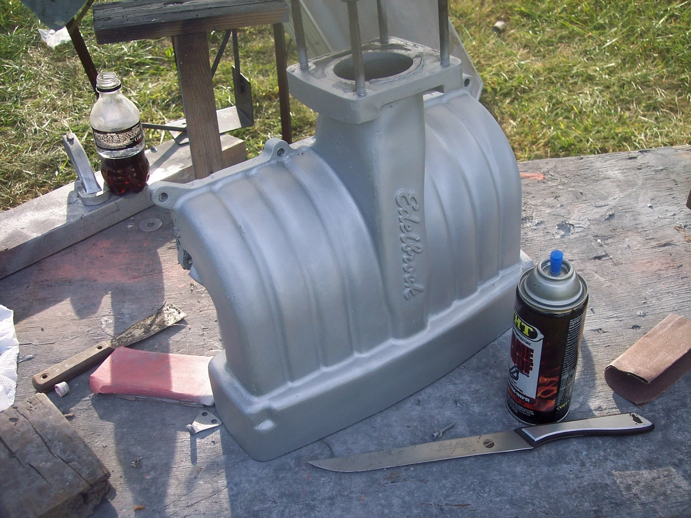

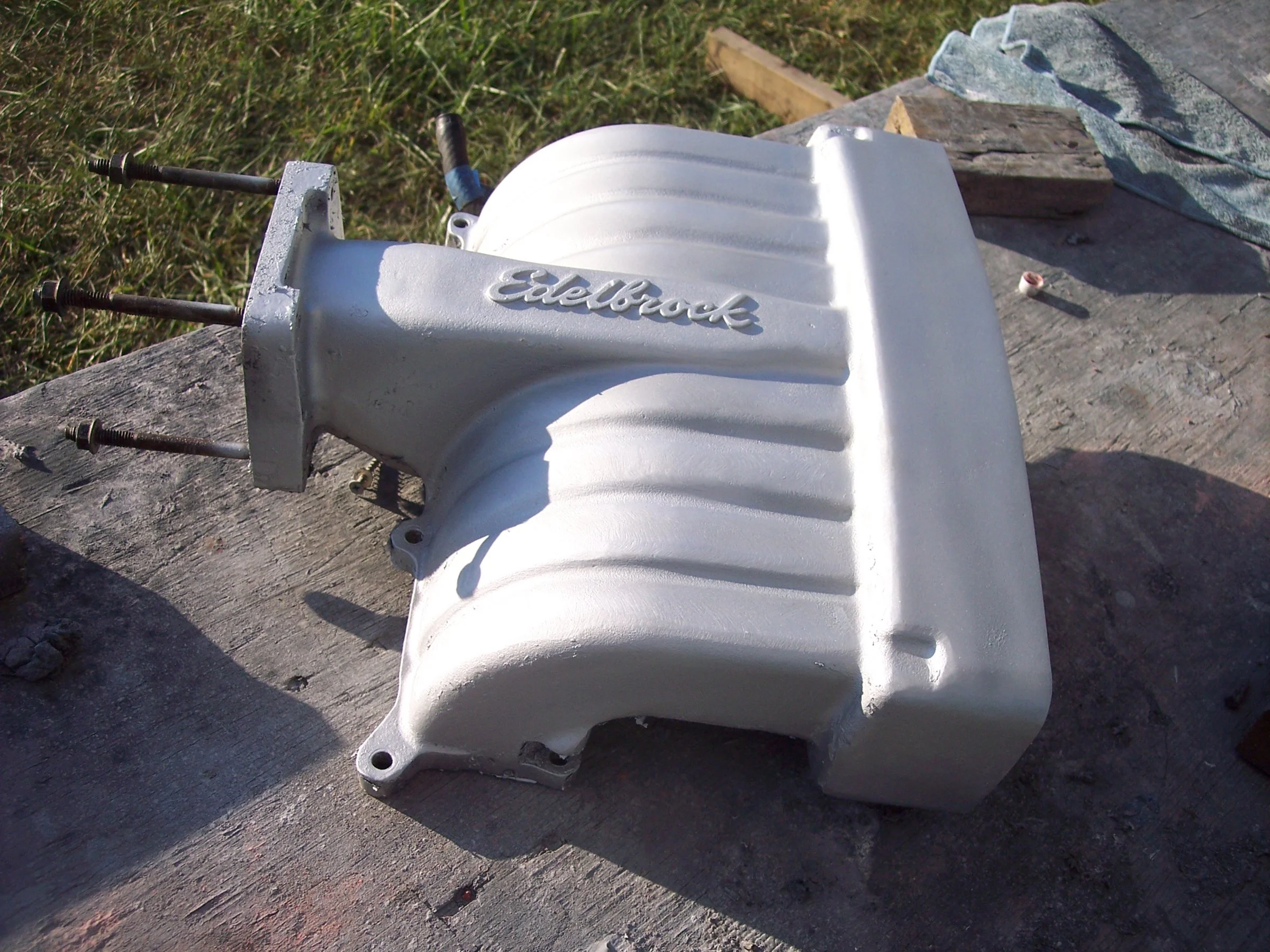

Finished the Edelbrock intake today and the valve covers. I think these were factory aluminum valve covers, nice and heavy.
they came out pretty good I think, power washed the engine cleaned it up and painted it also, now to address the engine wiring and clean them up.

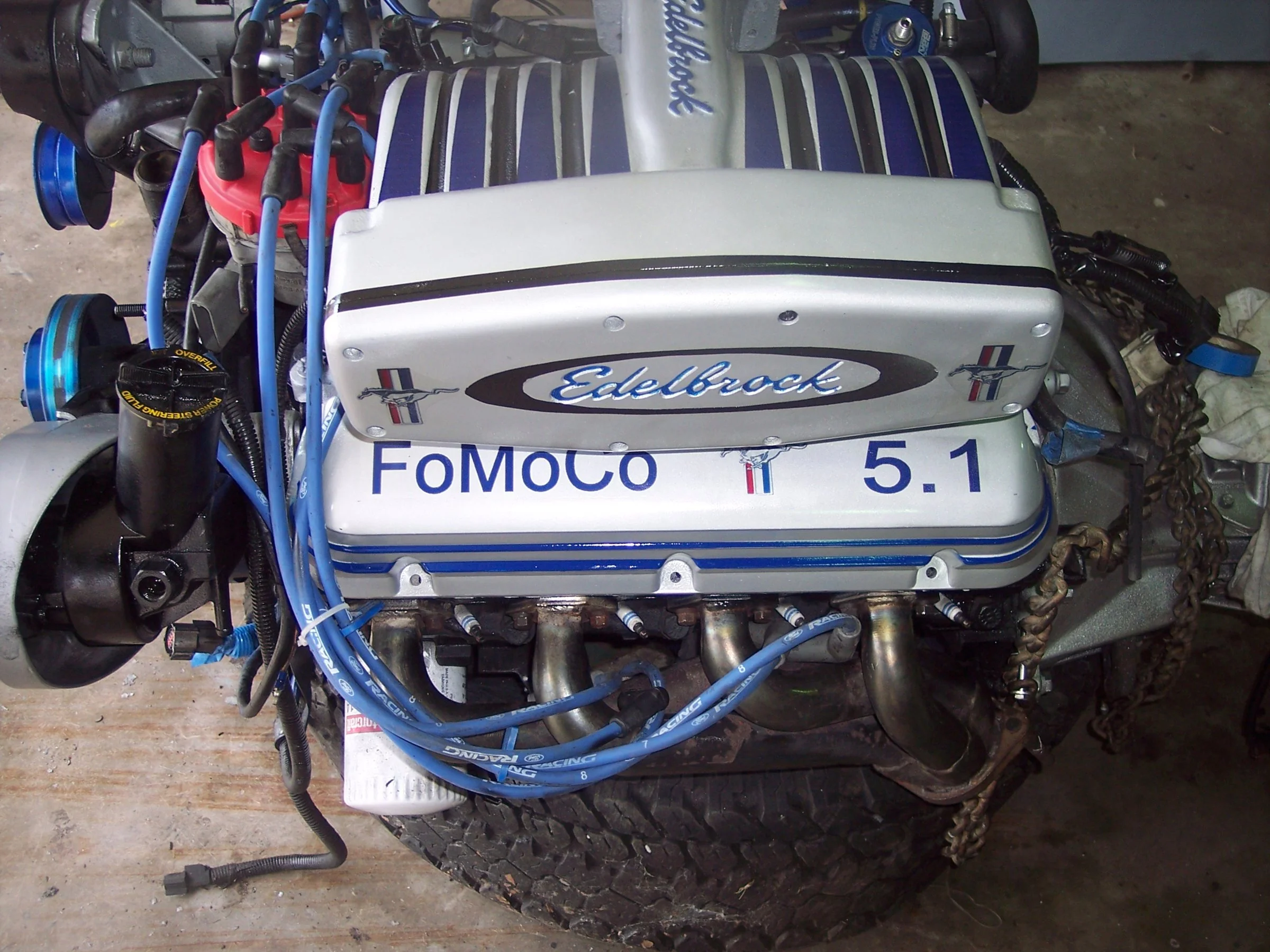

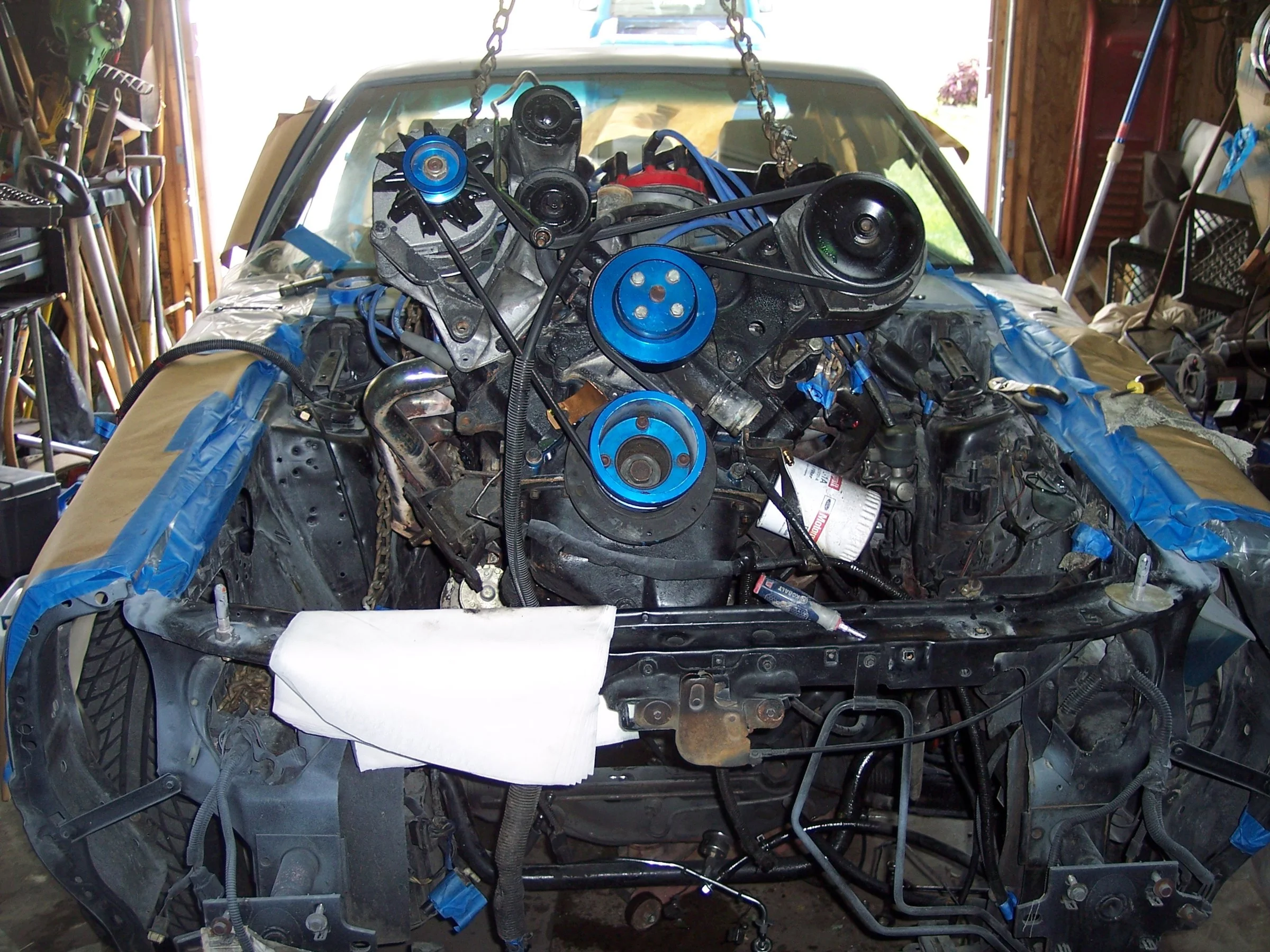

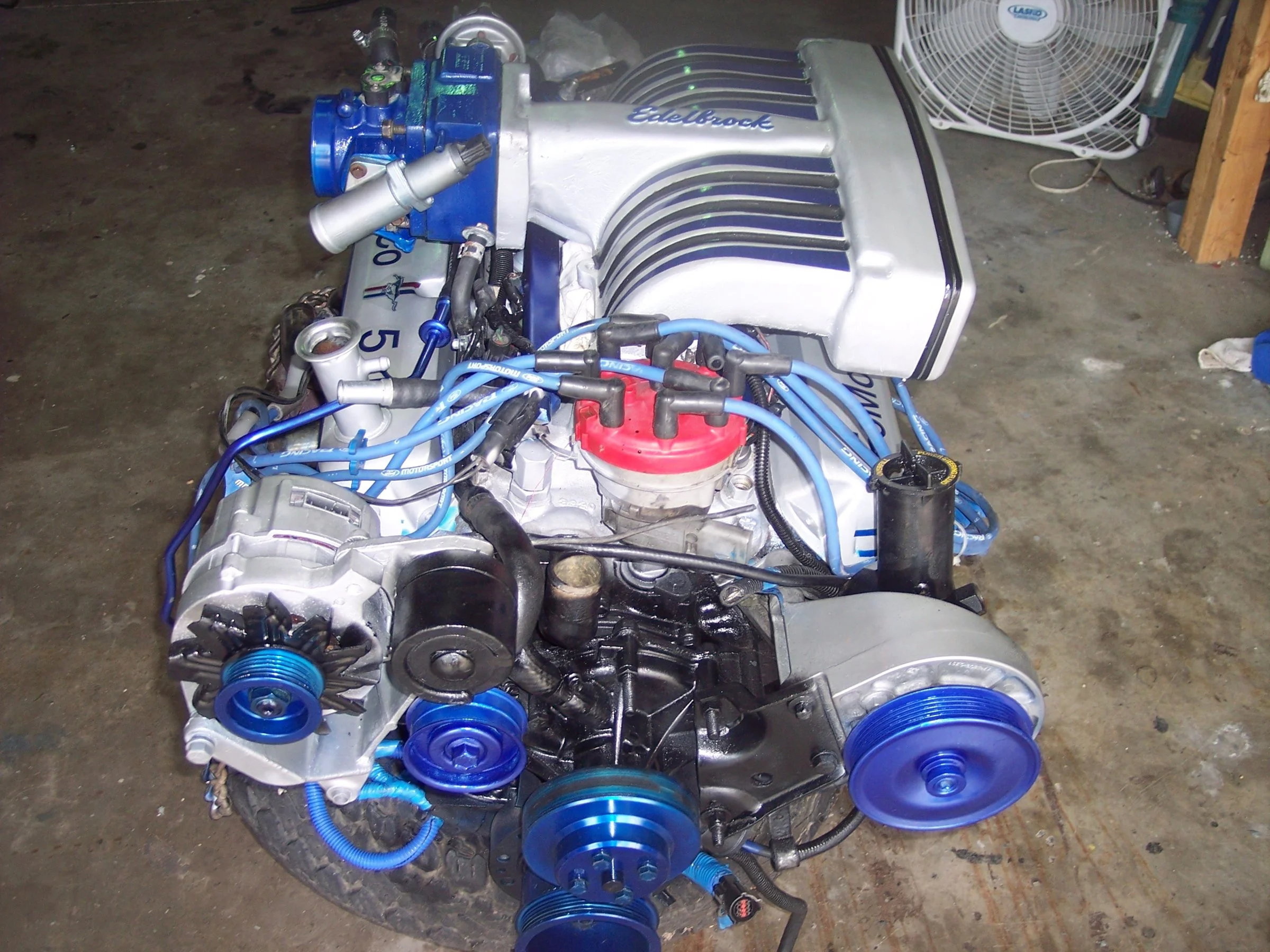

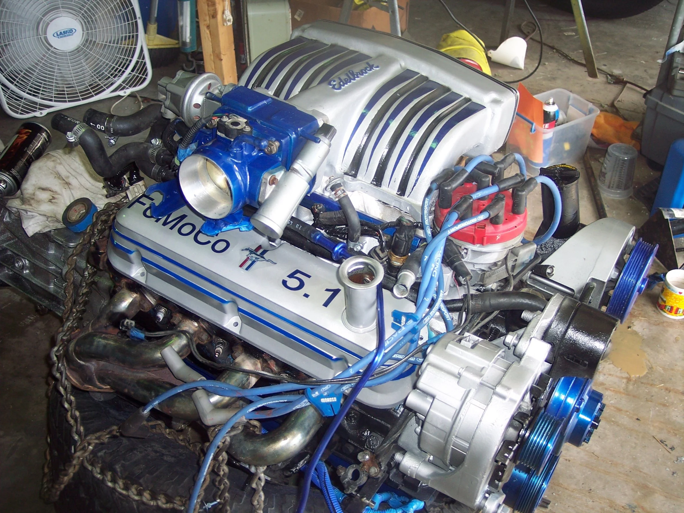

Worked on the engine today and set it all together to see what it's going to look like and I'm happy the way it turned out.

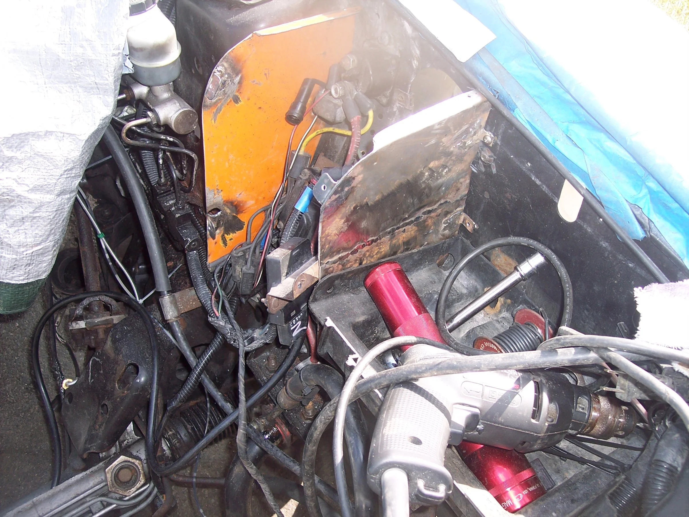

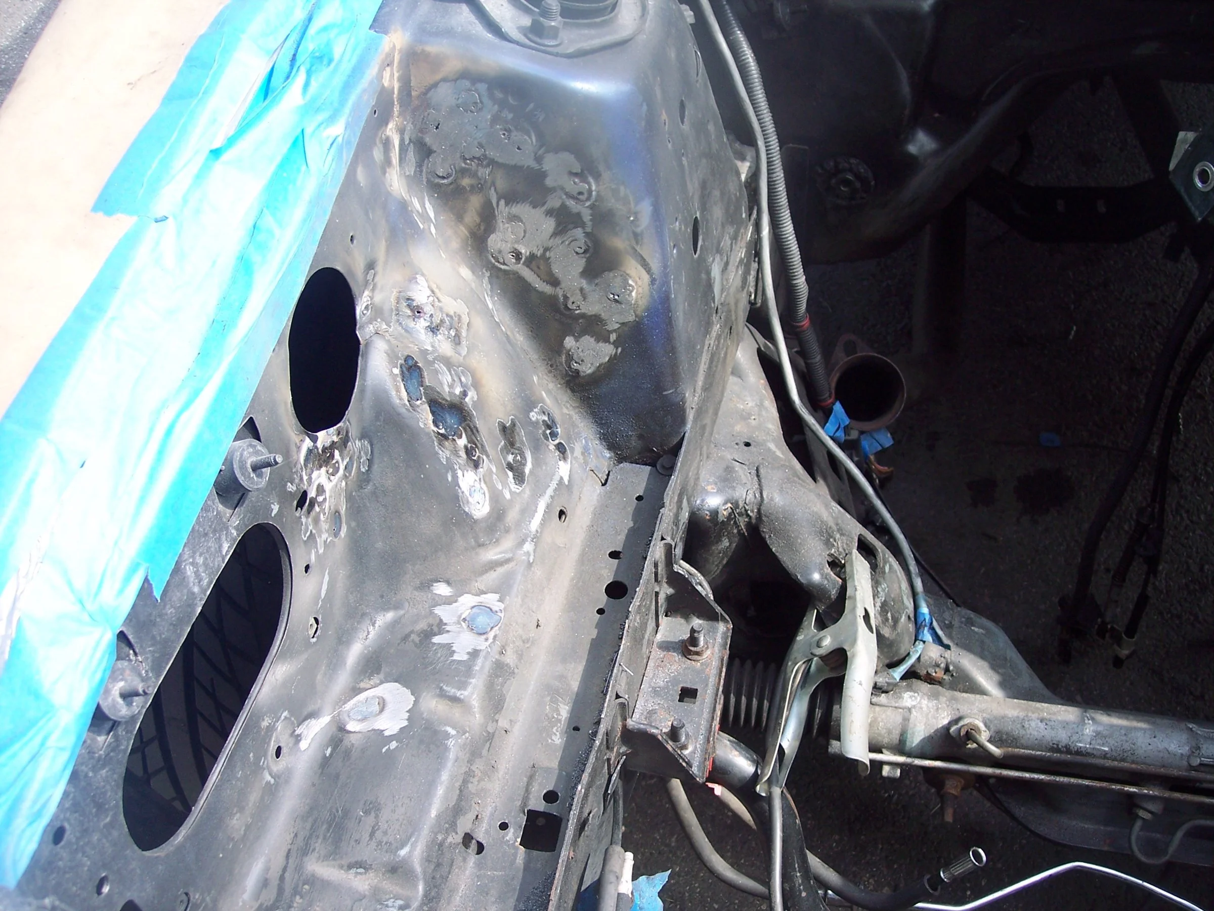

Yes I'm going to do some engine bay shaving but nothing to drastic, previous owner removed a lot of smog equipment and a/c from the engine but left a lot of loose wiring and vacuum hoses hanging around. Just getting rid of all that will clean it up quite a bit. Couple of vacuum solenoids on passenger fender well had to go with associated hoses and wiring, that cleaned up a big area, bracket on firewall that held the a/c equipment, it's gone. A zillion little hole need to be welded closed and a few big ones.

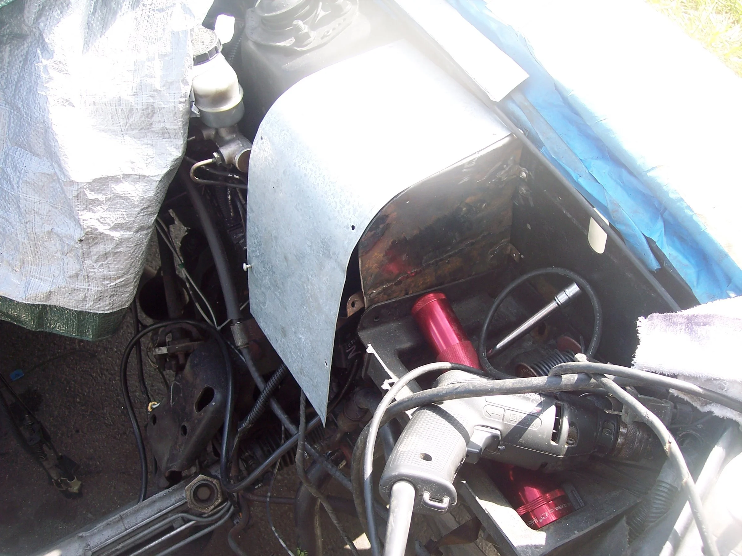

Still looking at wiring layout and looks like I can hide a lot, I'm going to fabricate a box enclosure next to the battery box ( I'm keeping the battery under the hood) that will enclose the starter solenoid, coil and wiring connectors plus the windshield washer filler neck. This will look nice and clean yet hide a lot of loose ends.
There is still room for improvement and I'll play it by ears as I go.

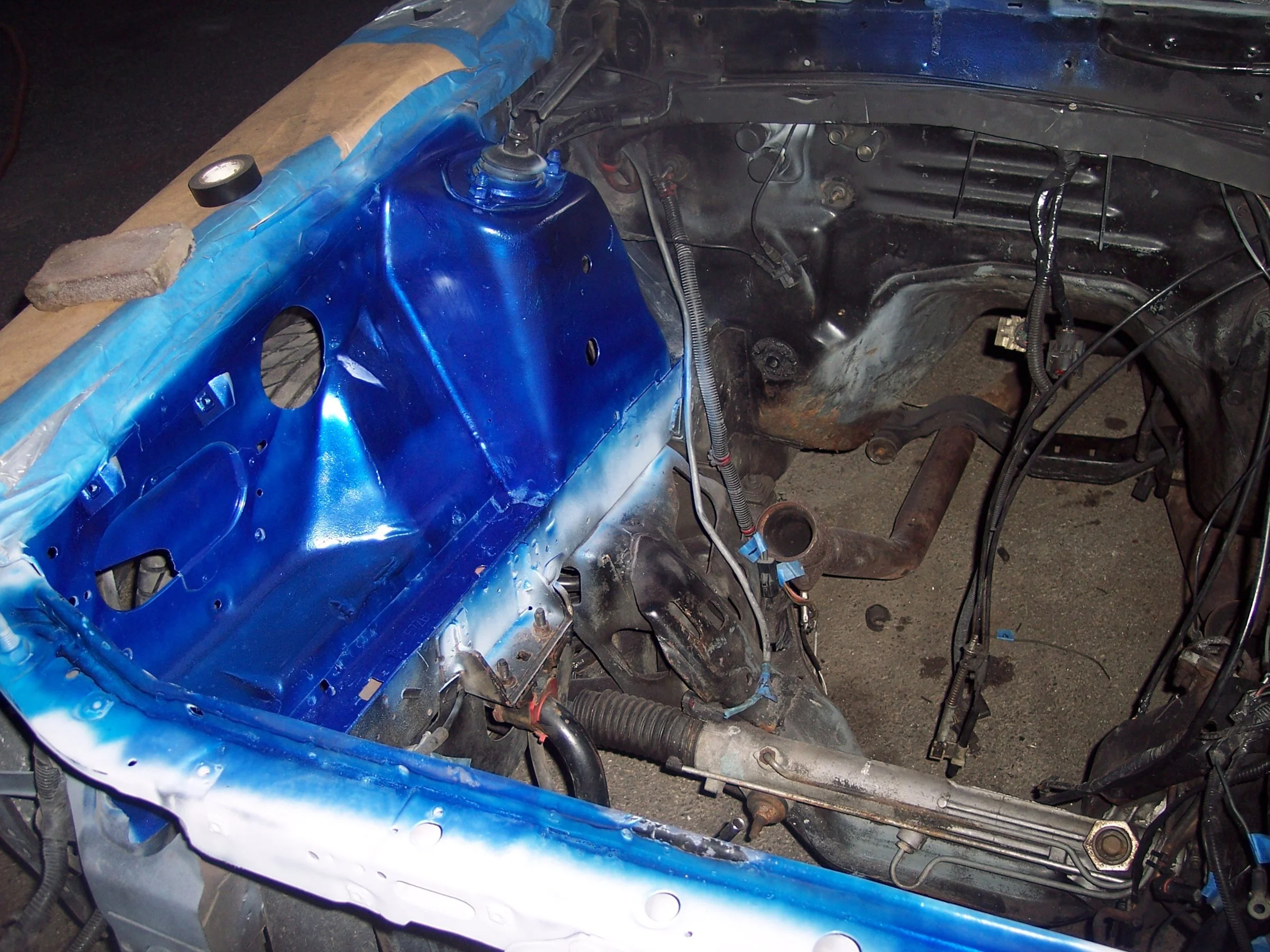

Been working on the engine bay this week and I think it's ready for some paint.

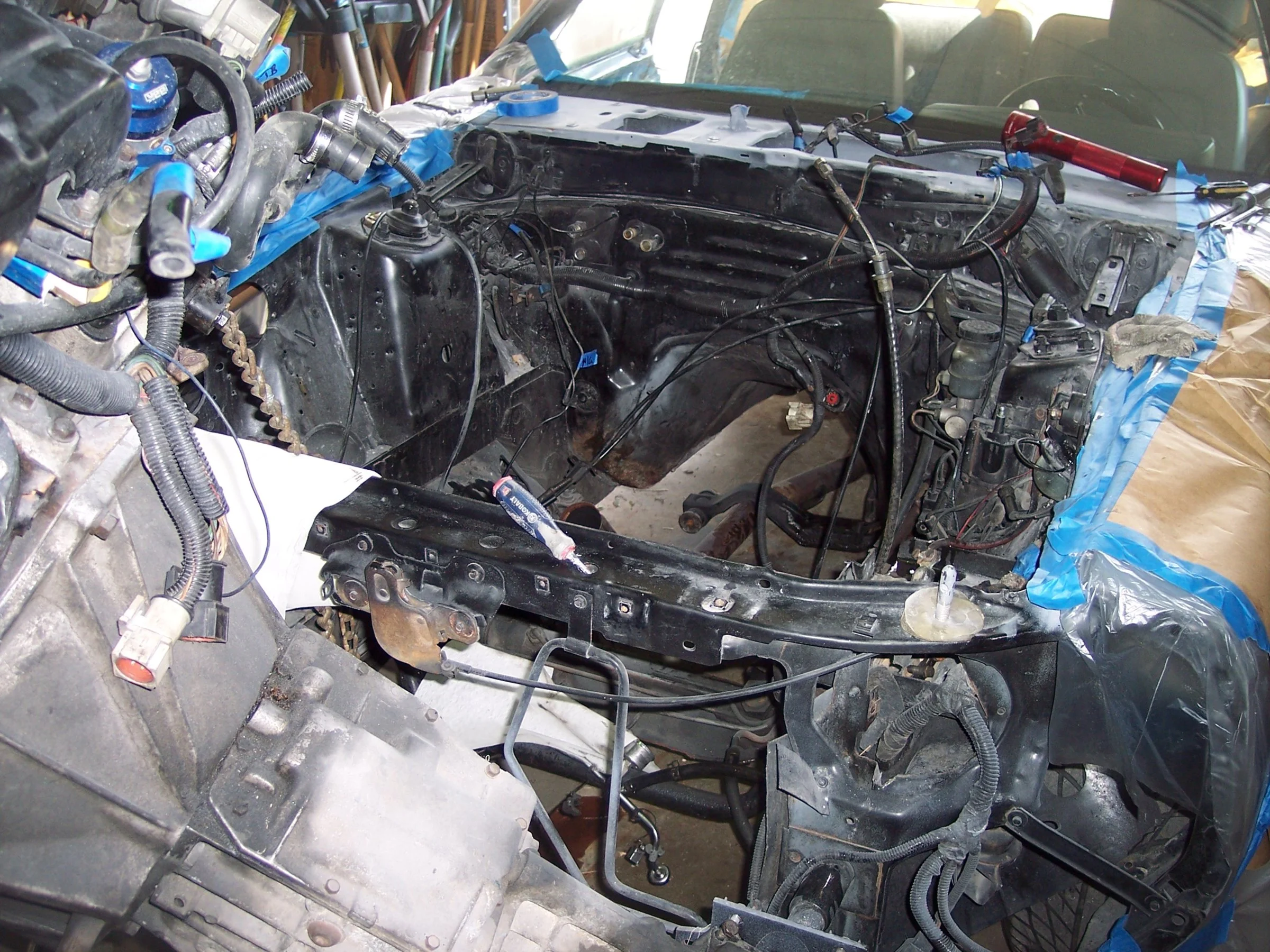

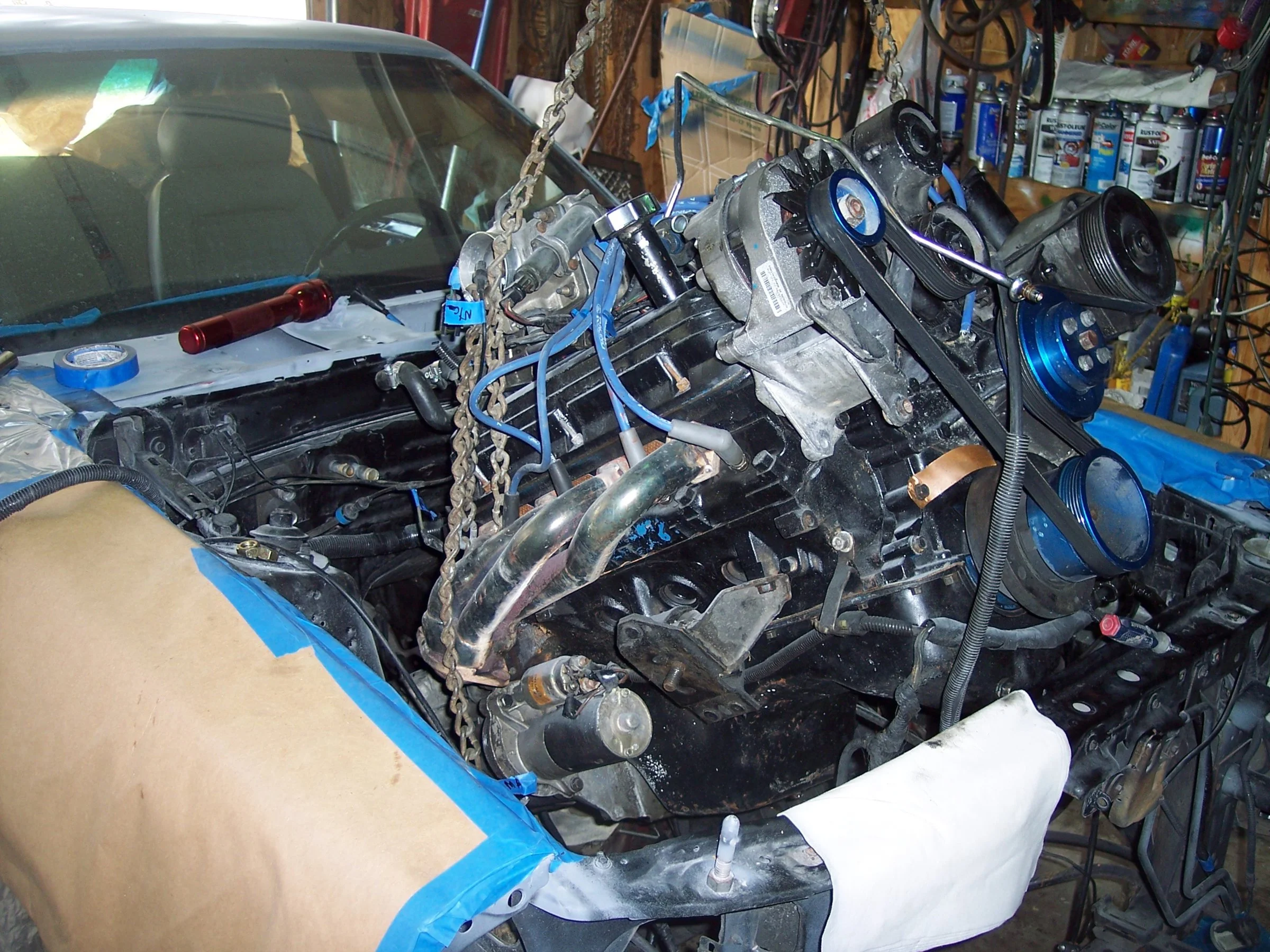

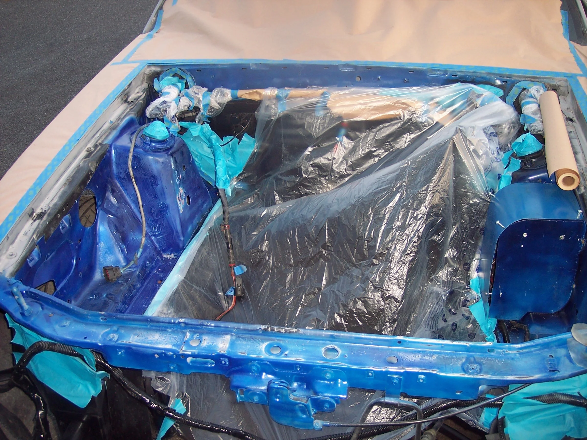

Didn't do anything in depth here on the engine compartment, welded up a few hole and moved some wires around to a less obvious spot. I did fabricated a small enclosure to house the starter solenoid, coil and MAP sensor, I think it looks cleaner and all the wires are hidden. also relocated the windshield washer reservoir to the front passenger side inner fender well. had to extend the wiring but the hose was plenty long to reroute to the other side

Going to shoot some paint tomorrow in the engine bay and around the lower edges of the body where the ground effects go, once I get the paint behind these areas I can hang all the ground effect panels to get ready for paint.
