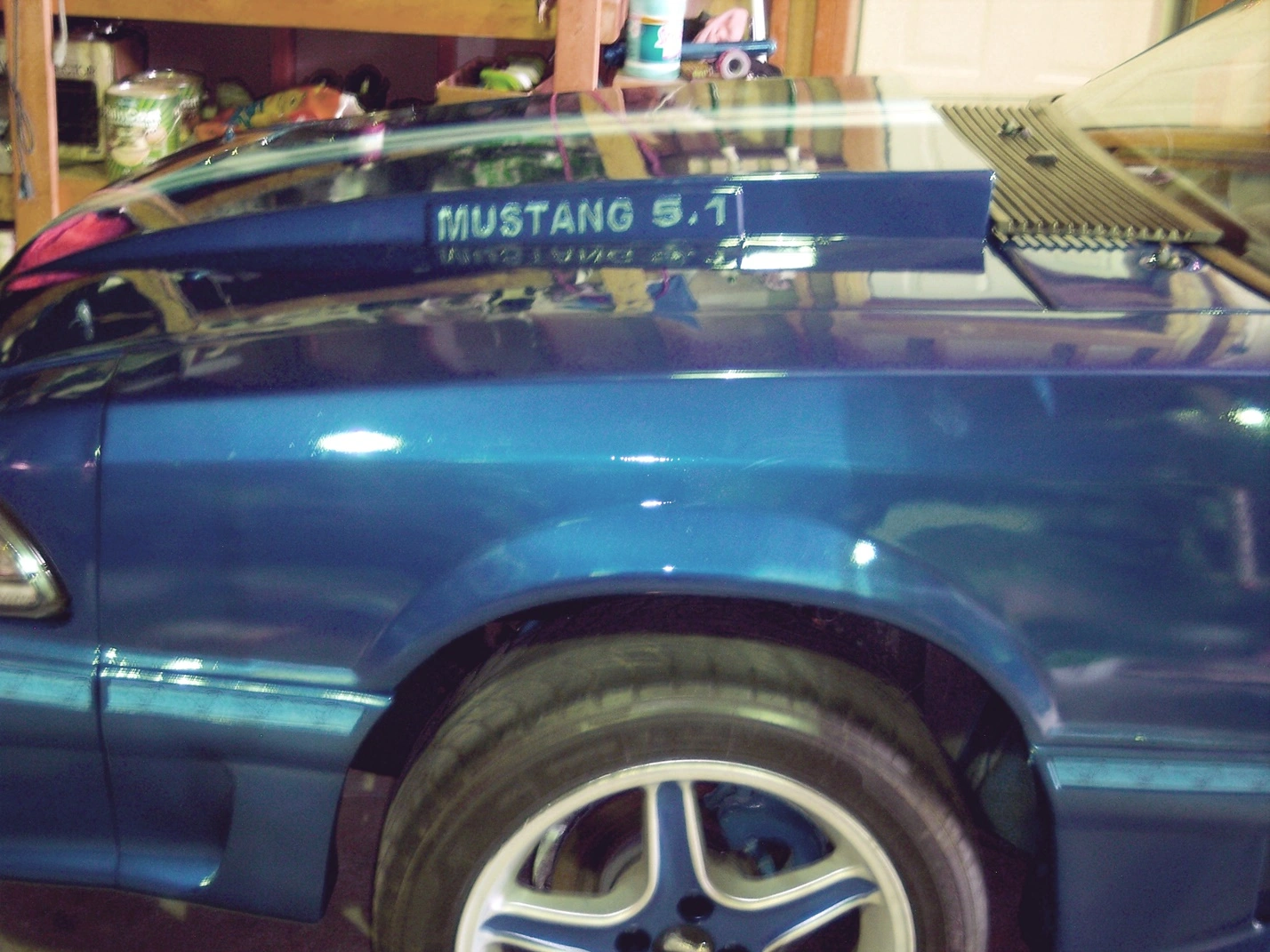

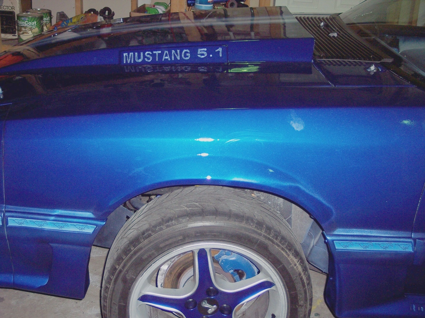

ok been putting it back together, put on the window trim, mirrors, new window runner and quarter windows. Makes a big difference. I'll wait on the windshield and rear window till I sand and buff. 10 days should be long enough.
While I had a few minutes I thought I'd do the wheels in the correct color.

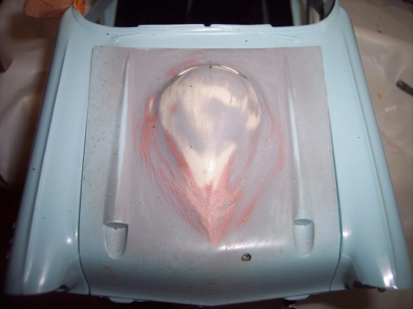

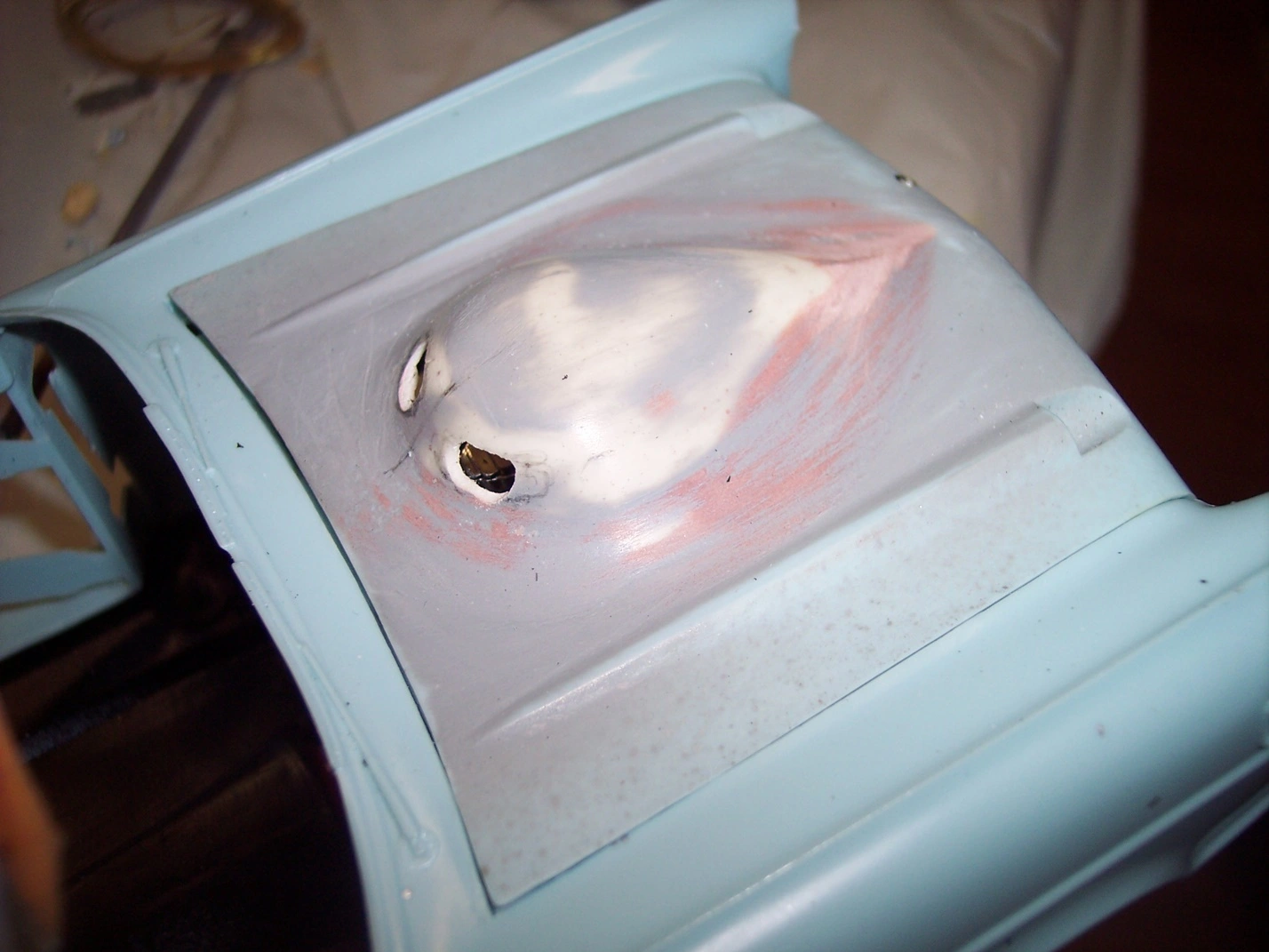

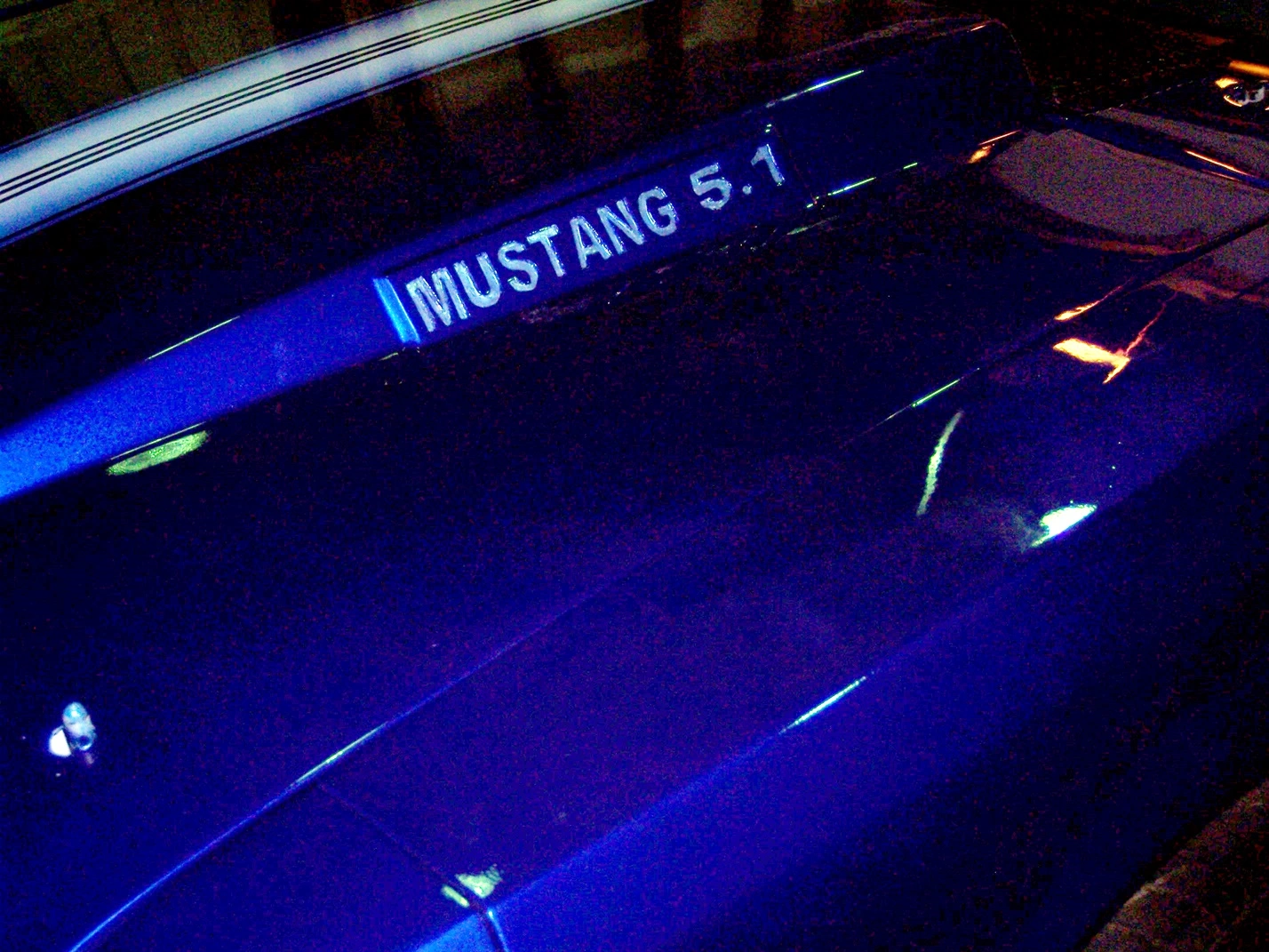

Hey madmike, since you didn't like my horses what do you think of my hood?
I'm guessing you are putting a 306 in it? lol
I dig that color man-looks like it layed out really nicely

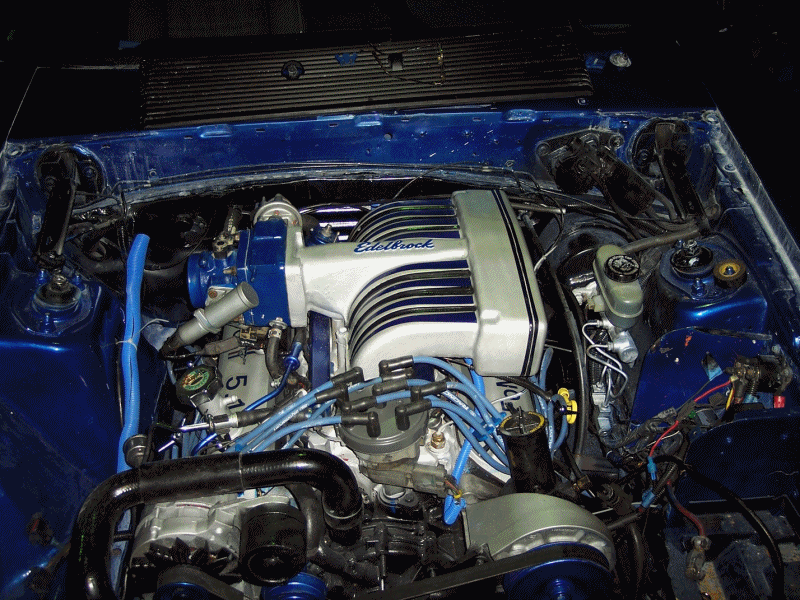

Yahooooooo! The engine is back in it's home, sat it in today and started hooking things back up. It went in like it had eyeballs, dropped right on the motor mounts first shot. Not bad for doing it all with one person.
Took some photos of the install but now I can't find them on the sd card ????? I should have it running tomorrow. I'll get some more pic's.

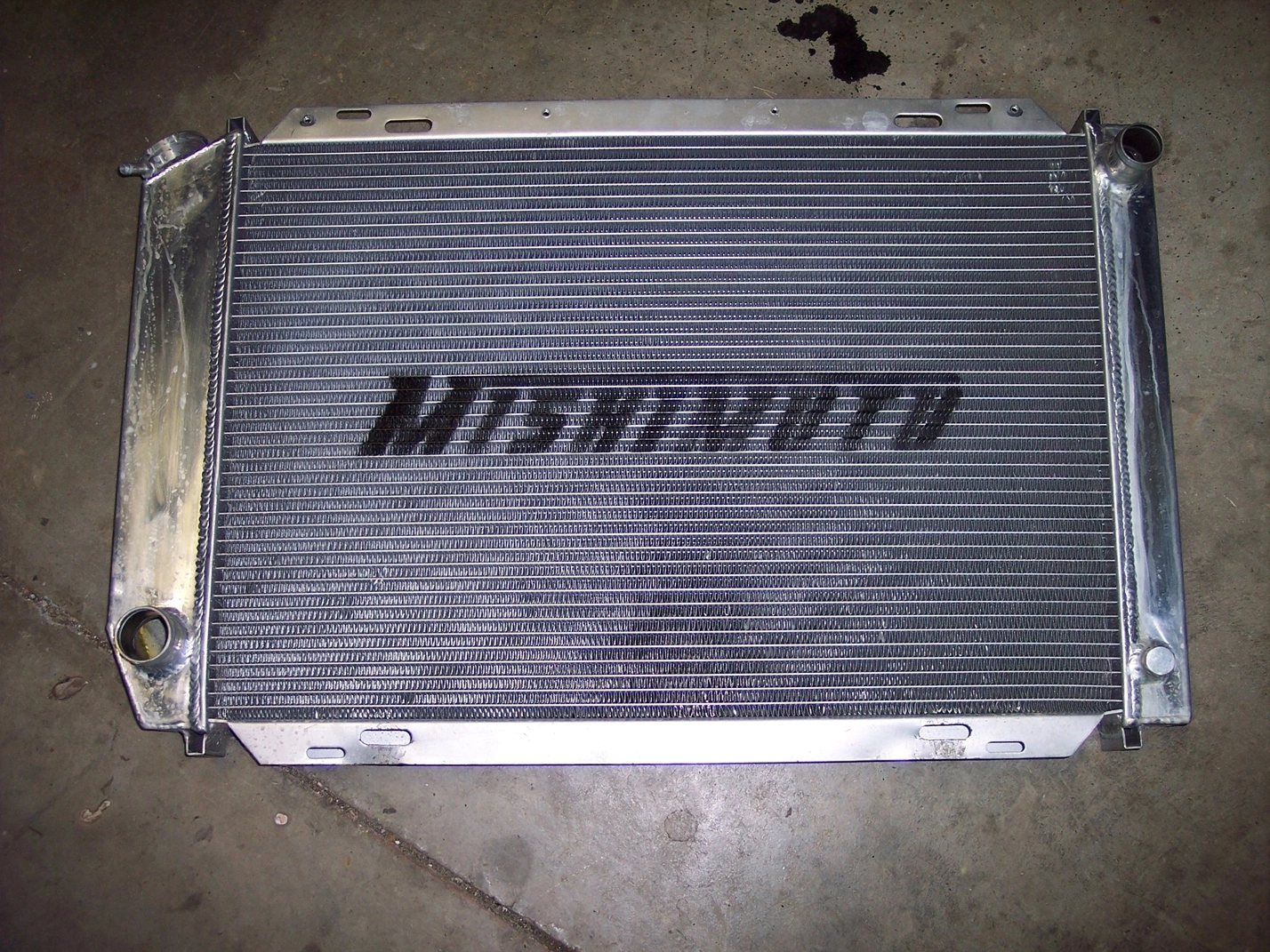

Well it didn't work out today just didn't have the time but I did run down an awesome deal on a Mishimoto heavy duty aluminum 3 core radiator.
For $80

IT'S ALIVE !!!!!!!!!!
Well it's finally running again and it sure feels good to hear it again.
Installed that 3 core aluminum radiator with shroud and 16" fan.
Replaced the speedo cable (again) and it's no fun.
running a little rough at idle, might have a vacuum line open somewhere.
All in all it was a good day at the office. :lol::rlaugh::banana:
