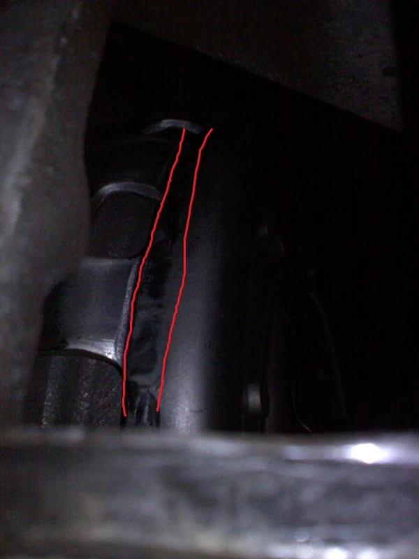

ok so i checked it out today and found what looks like some contact of something to the pressure plate. ill put a picture up basically the side is scraped like something is rubbing against it making that noise. im not sure what it could be since nothings really in the area where that scratch is might just have to take it apart again and check :( and yeh everything was torqued doing the star pattern and also tightend equally. i didnt notice any gaps between the bellhousing but i didnt look too hard ill check again in a little. and its an exedy stage 1 with a new flywheel/pilot bearing and throwout bearing. im really stuck as to what could be making contact with the pp im starting to think the clutch fork but i dont think it could get the angle to contact it like that. its odd too because it doesnt make any noise for about a minute after it starts it doesnt make a difference if i drive it or not. the picture was kind of hard to make out my phone has a terrible camera thats why that video was so bad so i underlined where the wear is happening.

I turned the engine over by hand and listened near the clutch fork cover and i didnt hear any sort of noise that would explain the contact on the pressure plate. i lookedd at it and there are some really deep scratches in it i looked around and couldnt see anything that could be doing it any ideas? i think im just going to drop the trans again this weekend and see what i can find

It sucks but that's probably your best bet. There may even be something rolling around in there that you can't see.
The marks in the photo look like normal marks from the stamping out of the pressure plate. Its hard to tell. I personally think the noise sounds like a TOB. I've had ones with a rough spot that sounded like that. Good luck brother.
yeh thats my terrible camera but i can tell you they werent there when i put it in and some are decently deep so im not going to be driving it until i figure this out. ive looked around and im starting to think it could be making contact with the clutch fork where it pivots. ill update this weekend when i take it apart again.
