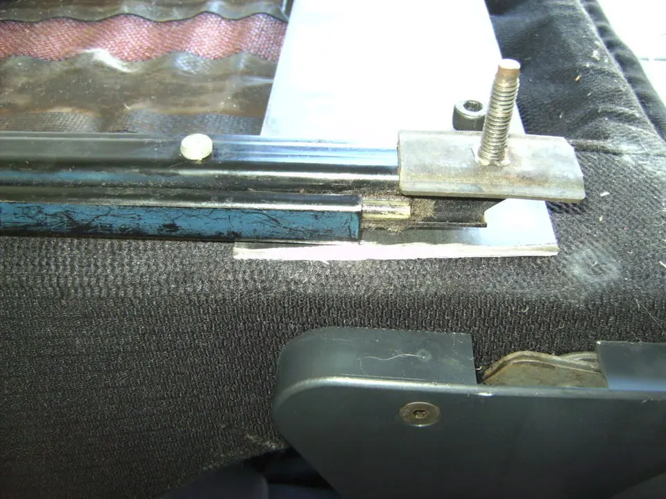

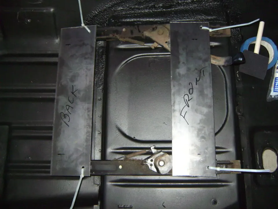

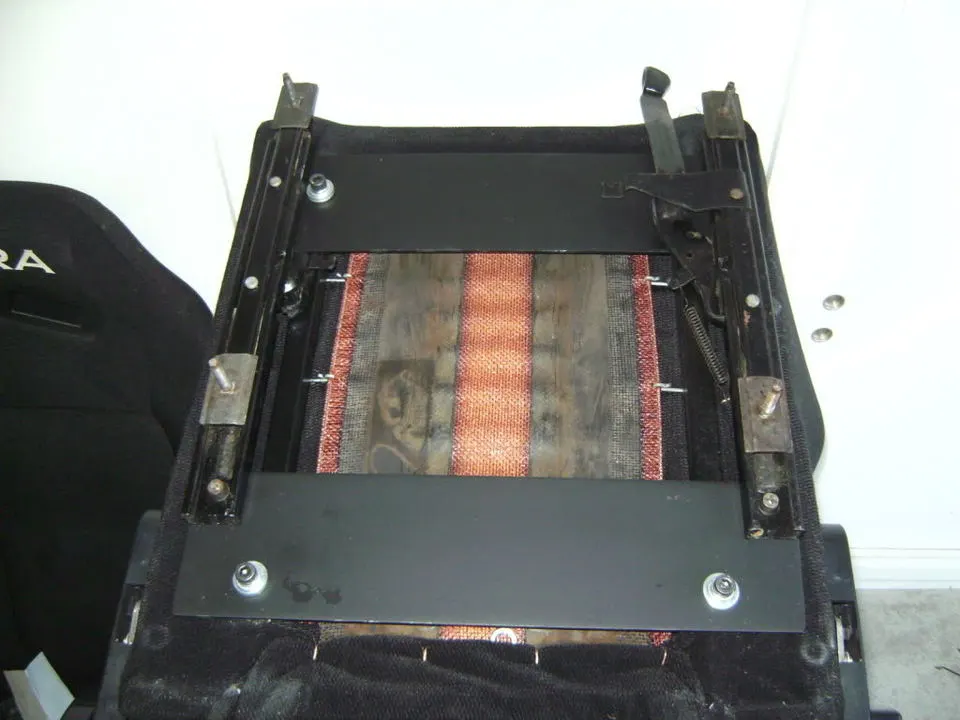

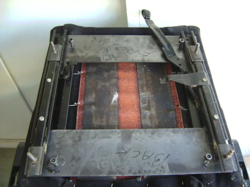

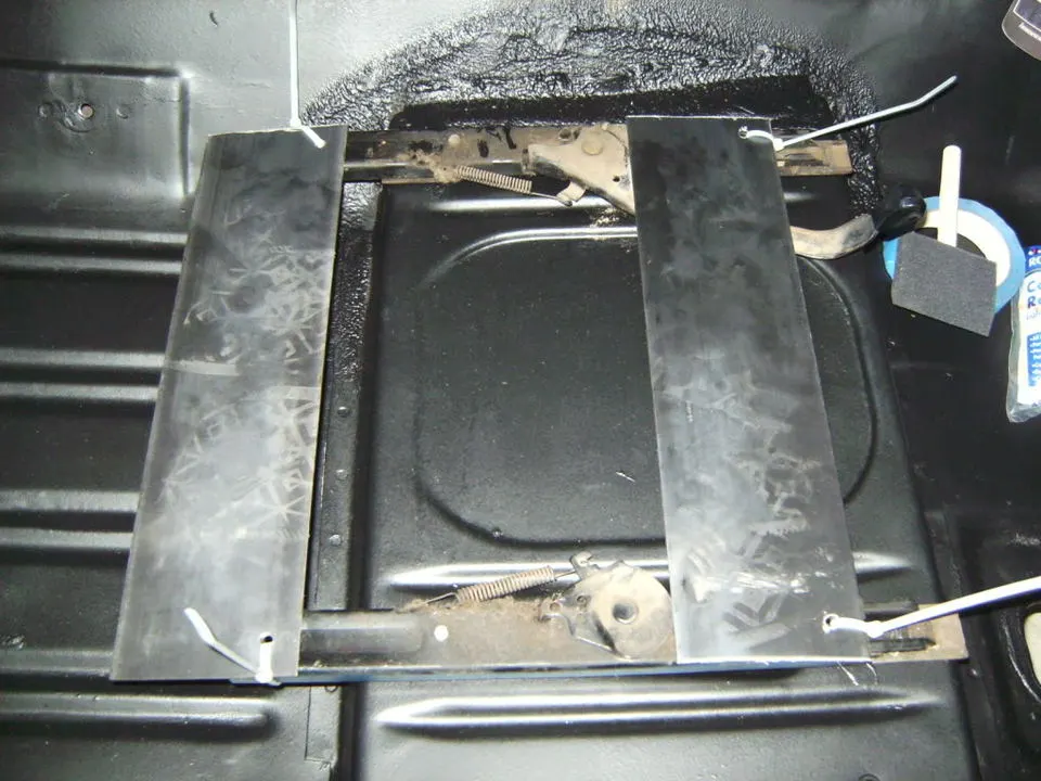

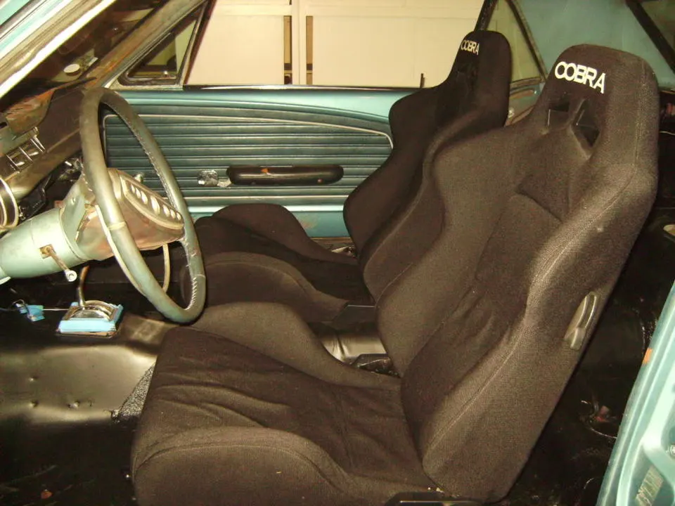

Well I managed to get the COBRA seats installed in my car. I used to factory tracks and made a bracket out of steel. One afternoon in the garage and they are in. I actually moved them back about 2" on both sides so I have to move the seat up one a little to be comfortable. Cant wait to get the interior back in and see it all come together. Hope you like.

Laying it all out with zip ties to see the fit.
Test fit on the seat:

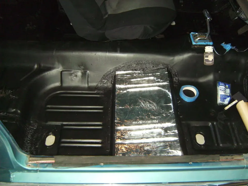

Layer of FATMAT on seat pan:
Completed bracket on seat:
New Passenger/Old Driver:

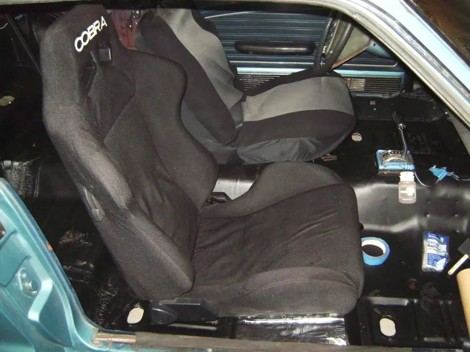

Completed install. Much more comfy then the worn out stock seats.
