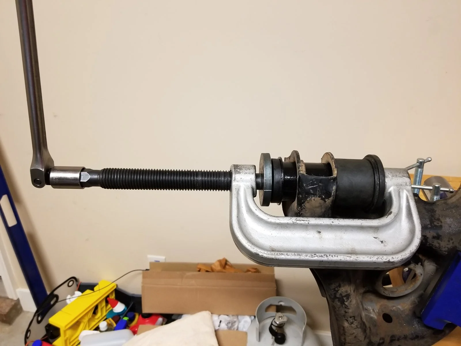

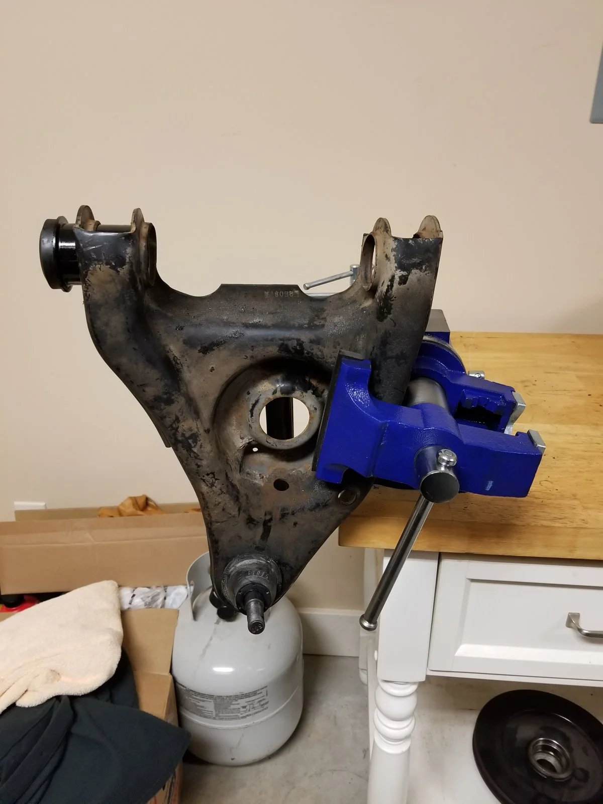

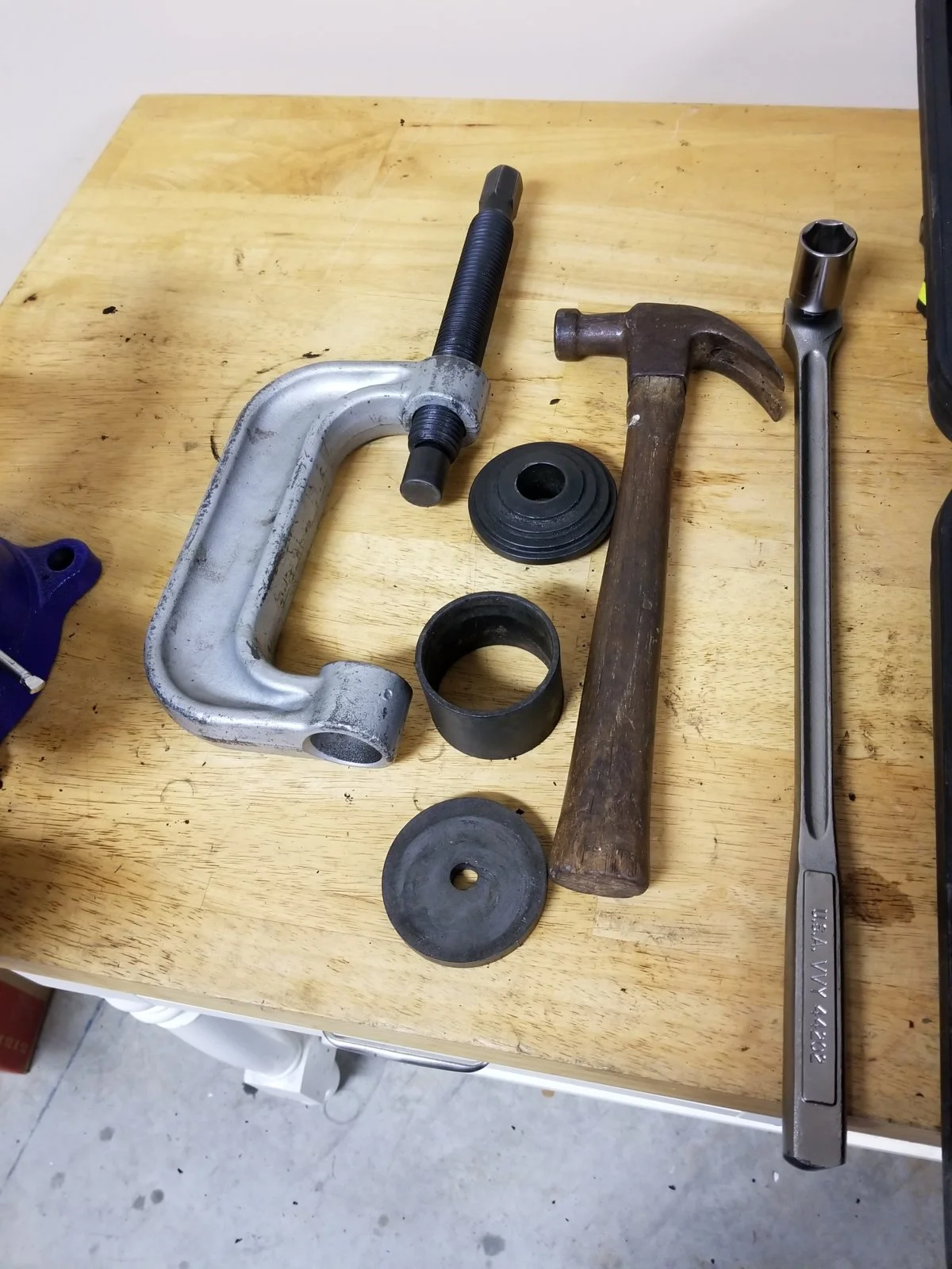

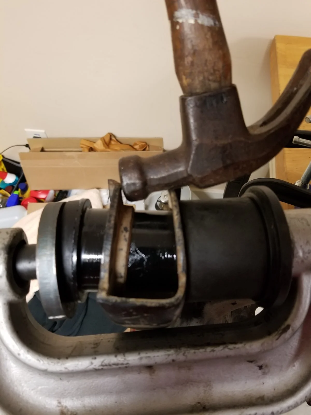

I found some pics that I took when I was rebuilding mine.
This is the ball joint tool and other bits I used to press the new bushings in.
Arm in the vice
Pressing the new ones in.
The outer part of the control arm wanted to bend in as I pushed in the new bushing so I just used a hammer to bring it back into position.
I bought the tool from Maximum Motorsports for pressing the upper control arm bushing in and out of the rear axle. That is where the flat piece of metal came from and now that I'm thinking about it again I believe that is the cup that I used. You can pick up the tool at MM for around $30.
If you get the tool all you will need is the ball joint clamp.
