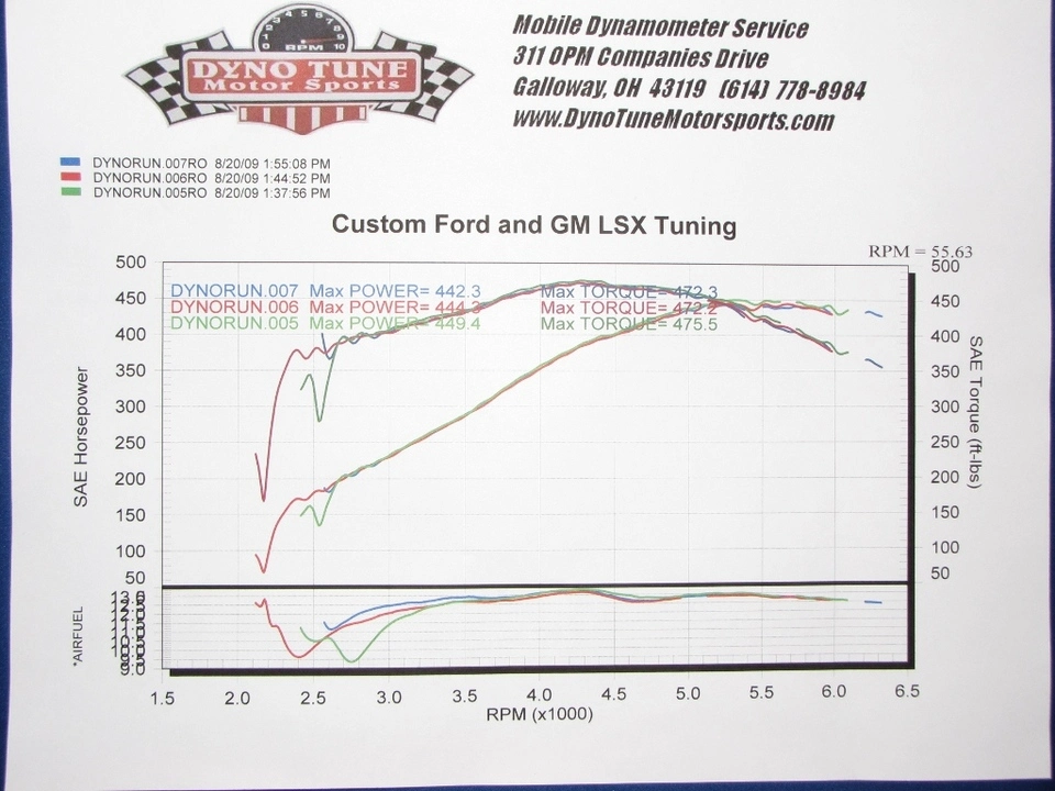

I gave up on tuning it myself so I had it dyno tuned today. I found the cause of all my tuning troubles tho....My wideband was waaaaaayyy off...The first pull with my tune showed around 12.5:1 on the AEM and the dyno WB pegged at 18:1 while the car made around 280rwhp :eek: Added 25% fuel and the next pull made 409rwhp. :cool: I now have the WB calibrated so it reads very close to what the dyno WB was showing.
I did have the timing pretty much right on tho. After he got the A/F tuned right the car made 449rwhp / 475rwtq. That's +10 on the torque and the same hp...My changes are port matched intake, switch to speed density, AEM EMS, LQ9 coil on plug setup, and 3" tailpipes instead of dumps.
Also, my old dyno says "Actual Horsepower", which I think is STD numbers? This one is SAE corrected, which is usually 5-10rwhp lower than STD. :)
Muuuuuuch better now :D I forgot how fast this car actually is until I drove it today.
It drives really nice too. I still need to fix some slight bucking around 1500 rpm and below, but other than that it runs very smooth. I'm happy with it for a change. :)

On one of the dyno runs the floor mat got pushed up under the pedal so the throttle was only open about 80-85%. The car was down 15-20hp and tq on that run. Do you guys think I could pick up around 10-15hp by installing a better flowing tb? I know the Accufab 80mm tb flows 200-300cfm more than my Holley tb. I don't know if a 90mm would fit on my intake since it had to be opened up from 75 to 80mm already.
