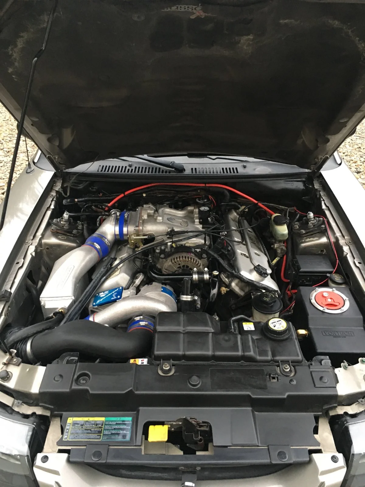

I’m running the v2 on my cobra and with supporting fuel mods and dyno tuned I hit 434rwhp and 392ft/lbs of torque.
He has a GT and you have a cobra. Big difference there. But those are good numbers but to be expected with your motor.
For sure but to give them some idea what to expect as far as gains go for his set up. Spent $700 just for the fuel supporting mods along with the cost of the charger kit plus the dyno tune. Now I need to upgrade the clutch. But I figured I would post my results even though it’s a 4v versus 2v to give some kind of expectation of what kind of gains he will be looking at
