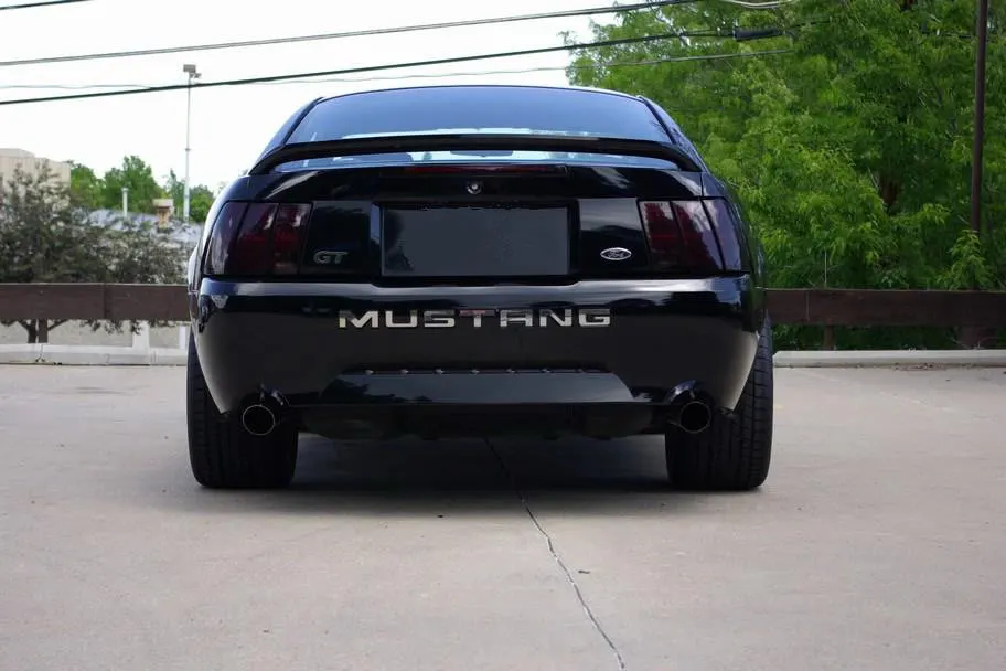

That will work fine - you could go 11-12" with a spacer, but at that point exhaust clearance becomes and issue.
I myself am running a 10.5" in the back with a 315 nitto NT01 with just a 1/4" spacer (nittos run narrow)...but I run an IRS :p
I've got 17X11 with 315/35 and have no issues, but I did remove my 'quad shocks' or whatever you wanna call em...and no spacers (in the rear - the front I had to use a 1/2 spacer to clear the Cobra calipers with 17X9 1/2 rims...
[/IMG]
I've got 315's as well and never had any clearance issues, 10.5" in rims.
I don't see a Supercharger, in your Signature... so how much did those wide tires slow you down??? I'm not trying to be disrepectful or a smartass, this is a legitimate question bro.
An old thread, but I think my question belongs here. So I am thinking about getting the 315/35/18 rear tires like on this build https://specsandmods.com/2004-ford-mustang-mach-1-new-edge-with-eaton-supercharger.html
I realize the off-set and backspacing plays a big role on whether it's going to rub or not, because from what I see there isn't much space in the wheel wells left with these tires. I want a nice and deep step lip, so what off-set should I choose? The rims I found are 10.5 with +22mm ET.
