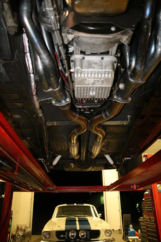

Changed to the 1 3/4 Accufab LT headers, and decided to run 3" under with an xpipe and 3" dynomax race bullets. It is just dumped underneath, pointed torwards eachother. Sound good I thing. Def not a daily driver type setup, unless you wanna lose hearing. lol
I would of ran it out the back, but the subframes and caltracs wouldn't allow it. If i had gone under them, it would of been pretty low to the ground for my taste and make loading in the car trailer a PITA for when we go out of town. Anyhow, it def sounds pretty mean now. Video does it no justice IMO.

Beautiful work!
The sound in the video kind of reminds me of what it would be like to stand in the middle of a stampede!
Be interesting to see how it affects your short times.
