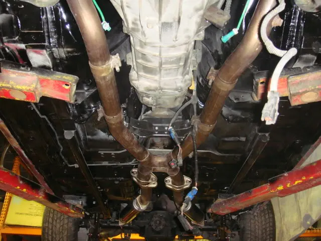

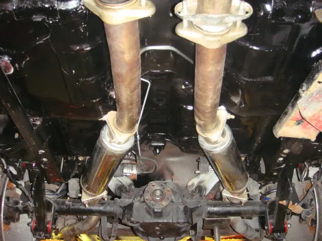

Don't go with Magnaflow Magnapacks. I have them on my 91 GT (which has a 97 Cobra 32V motor) They are way too loud with the o/r X-pipe and stock manifolds. L/T's will quiet it down, but I still don't see it sound good. My car is just loud. No tuned tone....just loud. Sounds like a POS with a hole in the muffler amplified 200 times.
This video does no justice. It's louder than this. You should hear it when I drive it down the road. And I still haven't taken it over 4,000 RPM's while driving.
http://s184.photobucket.com/albums/x258/svt32vdohc/4-Modfox/?action=view&current=MOV00807.flv
