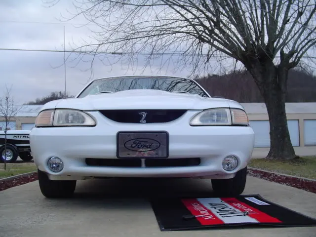

My BOI smoked fog lights are crap and need to be replaced. I can do either OEM Cobra fogs or do an Envoy fog light swap. Keep in mind either will be tinted to match the smoked headlights I have. Which fog light setup do you guys prefer? Price isn't an option, will end up to be about the same. Thanks.
Here are some pics of mine as is. If you look, the lights are much smaller and aren't centered in the cutout.

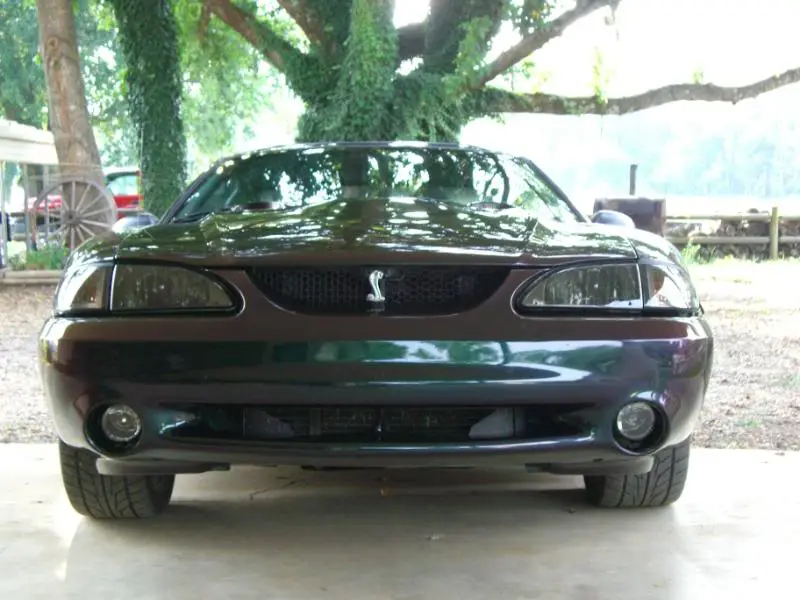

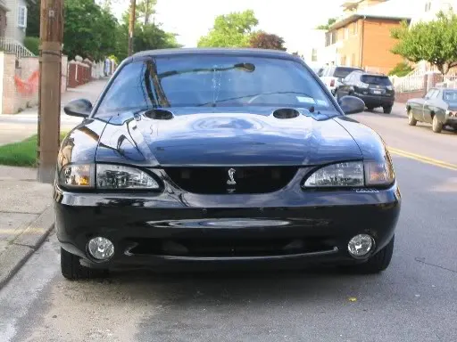

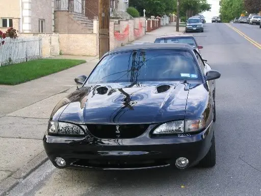

Here are a few pics from people who have done the Envoy swap. As you can see, they are larger and fit the opening much better than the OEM Cobra lights. Supposedly, the Envoy lights are brighter as well.
I have a file I can e-mail anyone interested: it is a detailed write up with pics. If you see my first picture (along with any other stock Cobra), the actual fog light isn't centered in the hole, and it is much smaller. Now, notice the other pics. They have lights off of a 2003 GMC Envoy (not sure if other years are interchangeable). Those lights fill the hole completely, so it gives a better look, and you also get better lighting. The Envoy lights use a 880 bulb, which can be ran off the stock Mustang wiring. The Cobras have a 893 bulb, only difference is the 893 is higher power rating. You have to make your own brackets for the Envoy lights, but it isn't hard, and as said, if you will post or PM me your e-mail, I will be glad to send the link. I just found out about this, but several on the Corral boards have done the swap.
