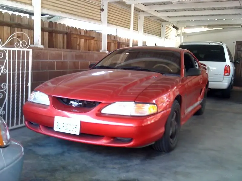

Well most of you don't know me. I've owned a Mercury Sable which I made into an awesome suspension corner handling bitch! I then bought a 1989 Ford Taurus SHO, and then finally decided to get a Mustang. I purchased a 1995 Ford Mustang GT with a 5speed. This thread is the for the transformation of the car from what it is, to what it should be. So far I've replaced the ignition plugs, ignition rotor, and distributor cap. I repaired the battery terminals and cables. I've replace the engine oil, transmission oil, and differention. I also replaced the fuel filter and cleaned the K&N air filter the previous owner had installed. Well since most of you don't even know what she looks like. I figured I would take a couple of pics of the car before I start it's transformation in the car sexiness hall of fame.
Anyhow, here are some pics... Enjoy!

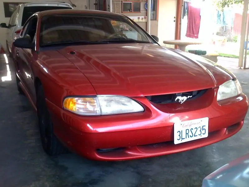

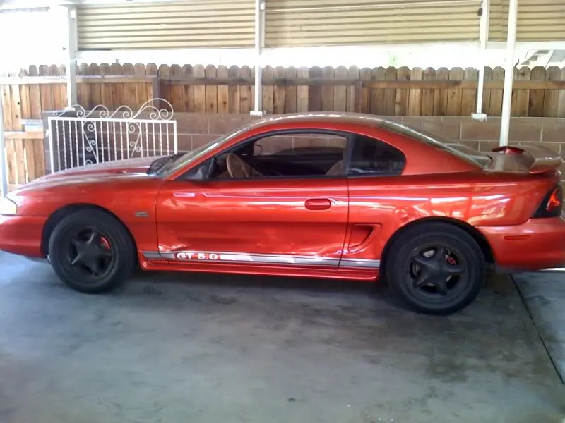

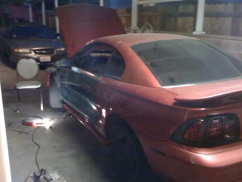

Notice anything in this pic?
Maybe the driver's door and rear quarter panel... That's where most of my skills will come into play ;)

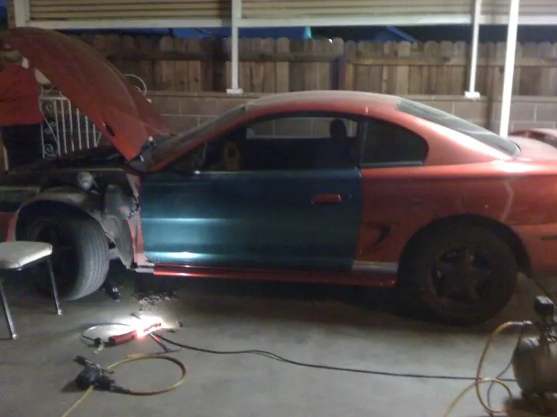

Here's the beginning of the transformation... A used straight driver's side door. $50 at Pick-N-Pull

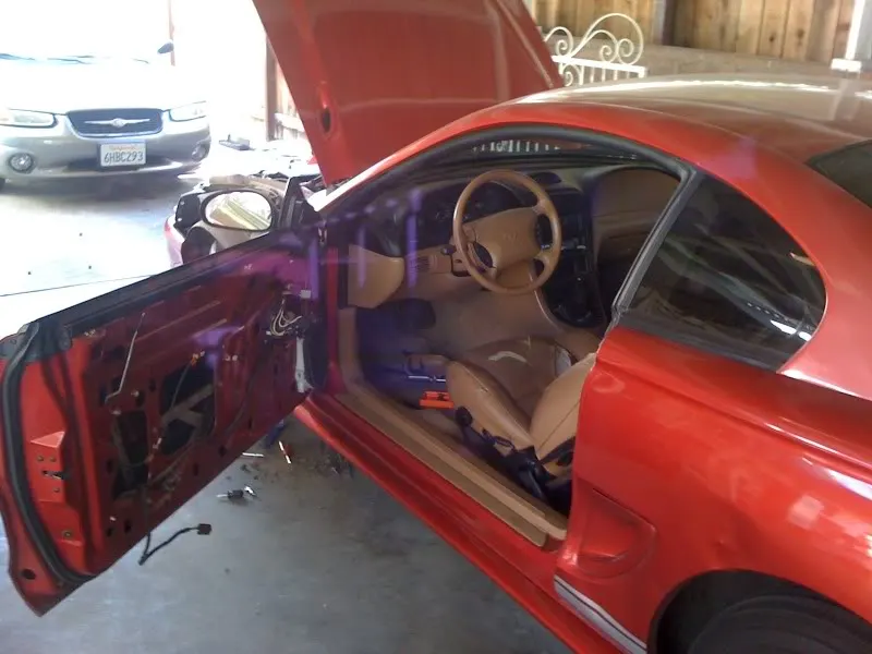

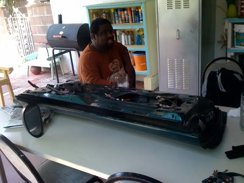

Ok well, I've been busy at work since we last spoken.

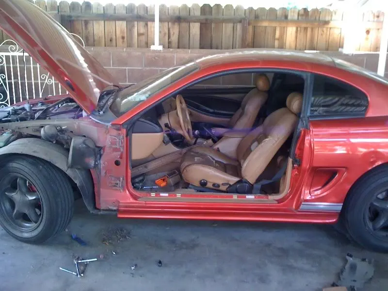

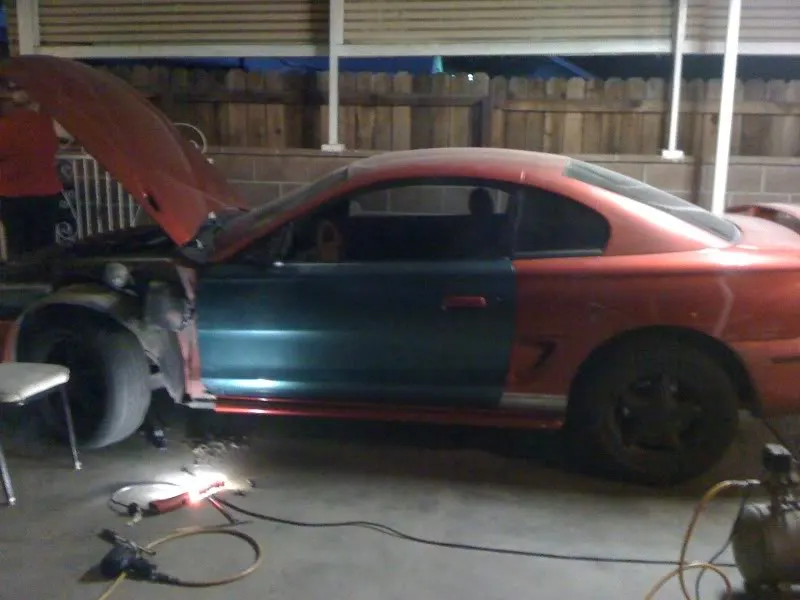

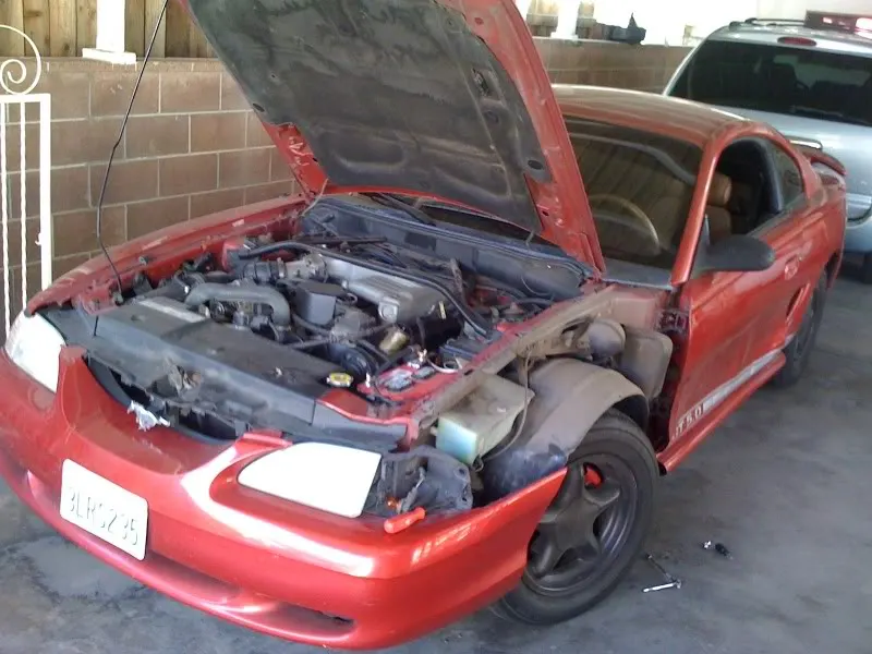

Here's the fender coming off in order to replace that horrid door.
Good bye door!
Hello straight door!

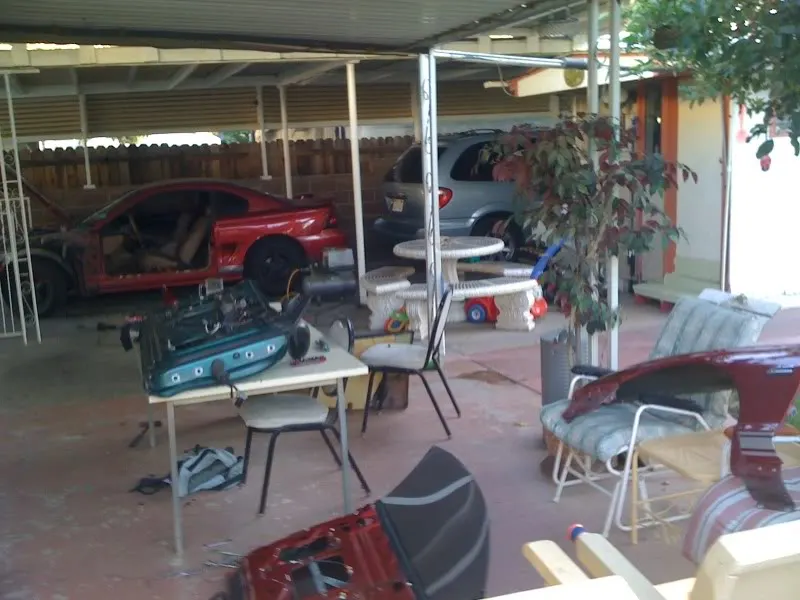

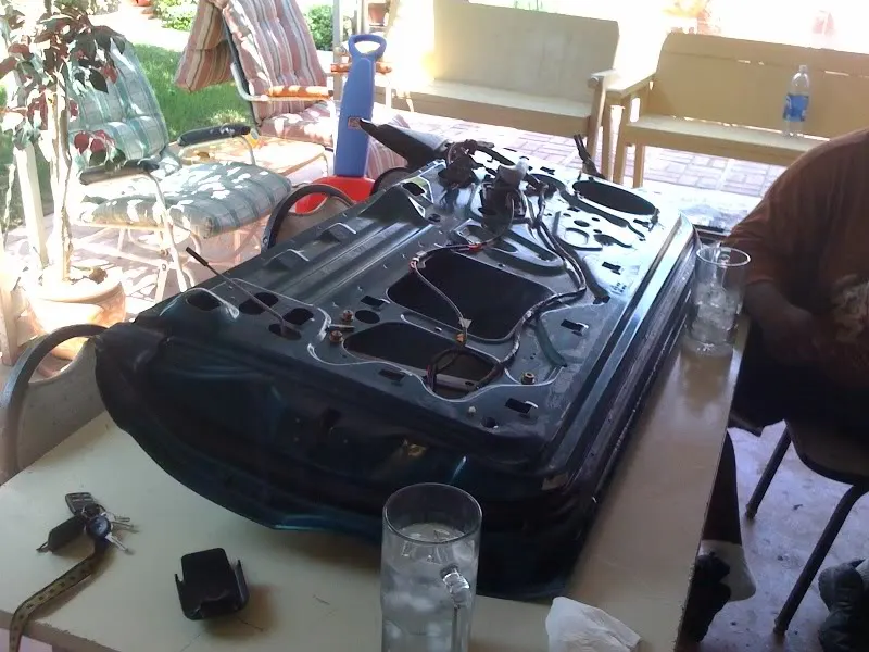

Well, the door I picked up was for a V6 Mustang. Now the difference between them both is, the GT door offered a couple of options like Mach 460 and a different latch assembly which turned on the lights if the door handle gets pulled. That was a pain in the ass to transfer all the stuff over. Plus the door did not include glass, had a cut wiring harness, horrible rivits that would not budge, and is green!
Here's a pic of the transfer over and the mess in the back yard.

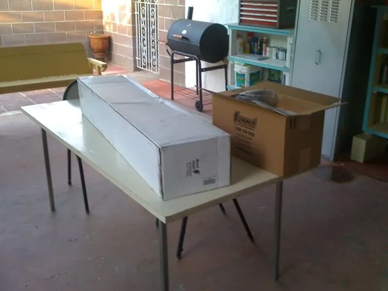

Well Christmas came very early for Sal...

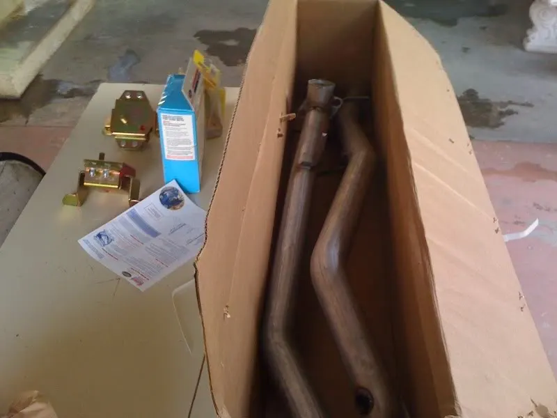

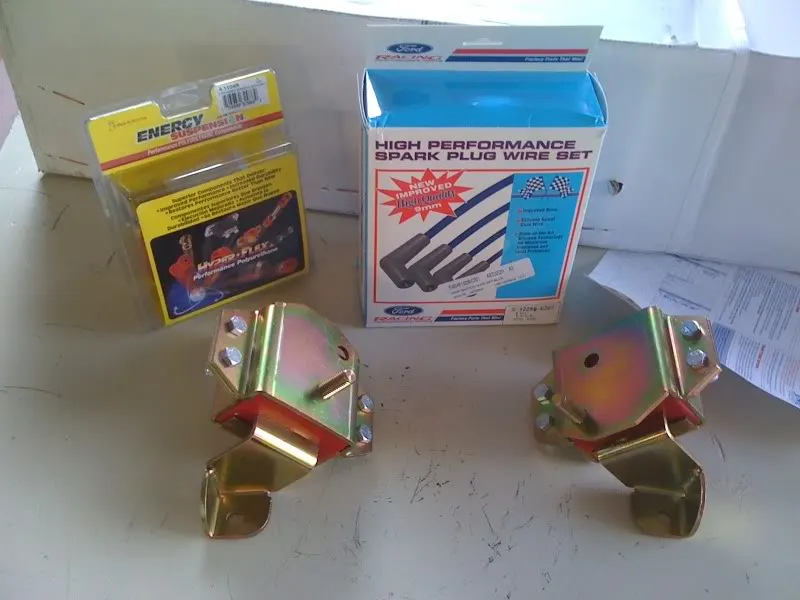

I bought a couple of items I needed and one I wanted to play with. I ended up buying Ford Racing 9mm wires, and energy suspension transmission mount and engine mounts. Oh also a Summit Racing catless H pipe.

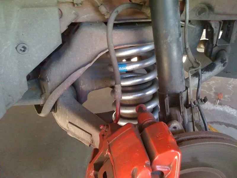

Oh I can't forget to mention I got BBK springs used from a local guy here. I painted them since I HATE the light blue look.
Although I did keep the BBK untouched just incase I decide to sell them.

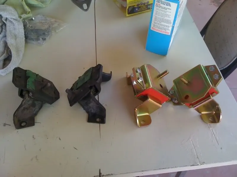

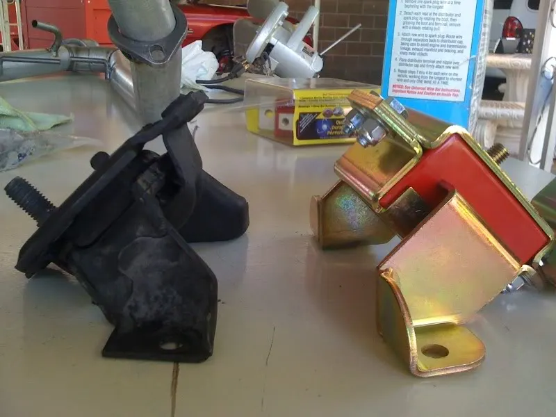

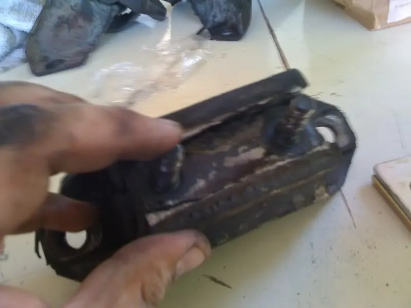

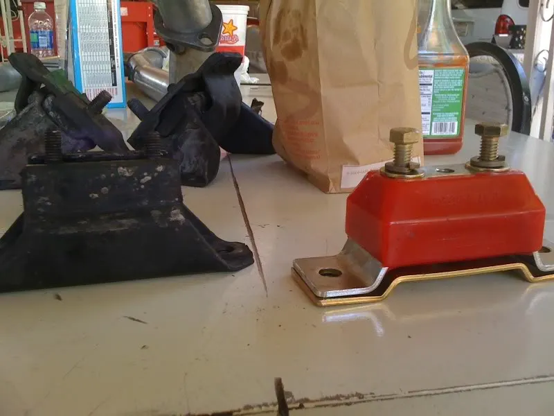

Here's a comparison of the two engine mount sets.
Yeah, those stock mounts needed to go! Prior, I would rev the motor and the motor was all over the place. Now she sits still and the rev rocks the car! I love it!
My mayhem in progress

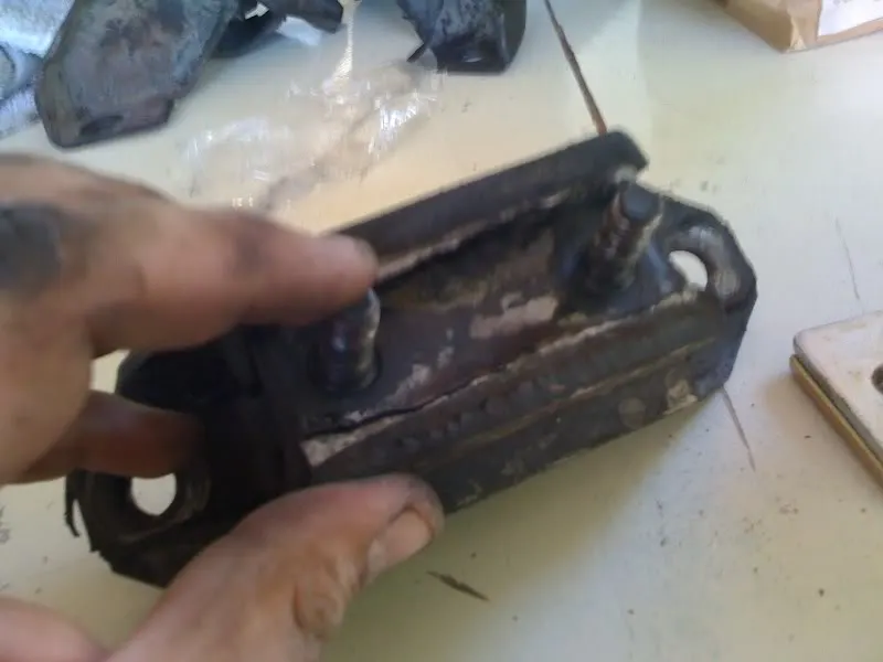

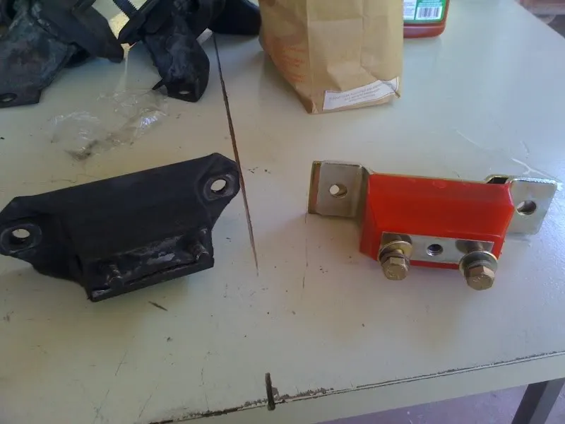

Here's the transmission mount comparison.
As you can see, I really did need a transmission mount.

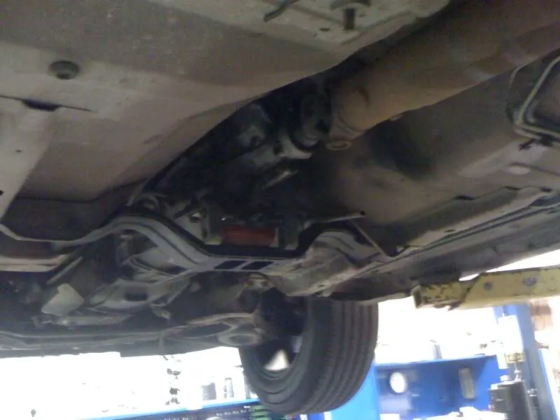

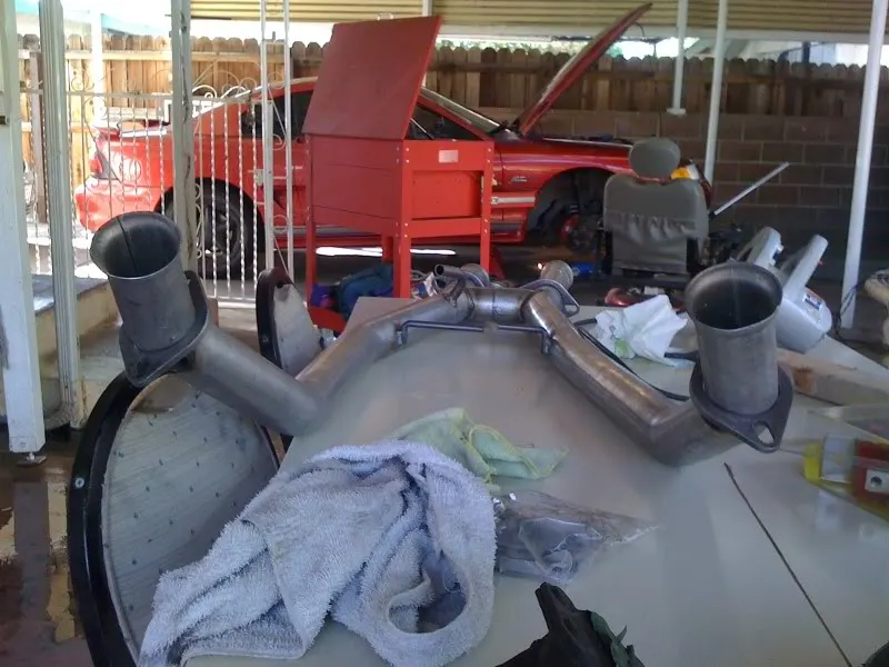

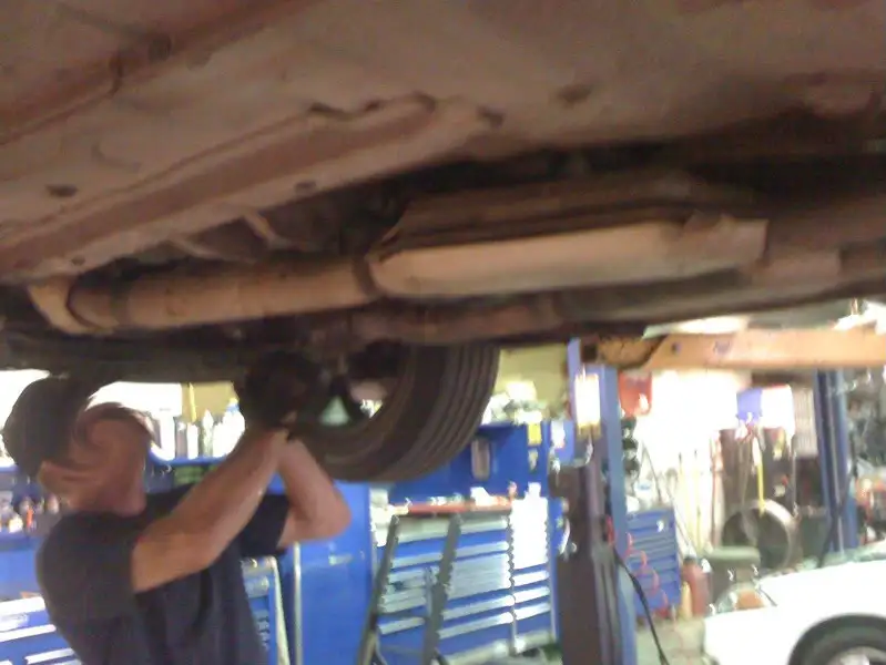

I found someone in Mexico that was willing to install the H-pipe. Here are some pics of what we did, and how we did it.

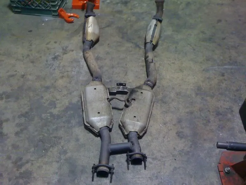

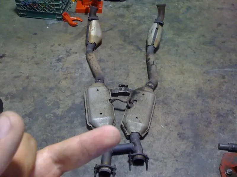

Stock H-pipe coming off...
Stock H-pipe off and sitting on the ground.

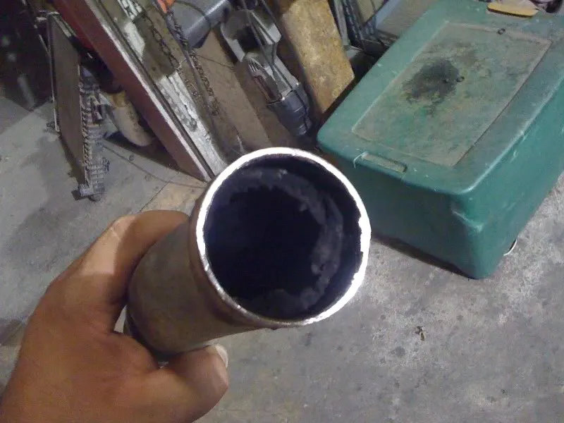

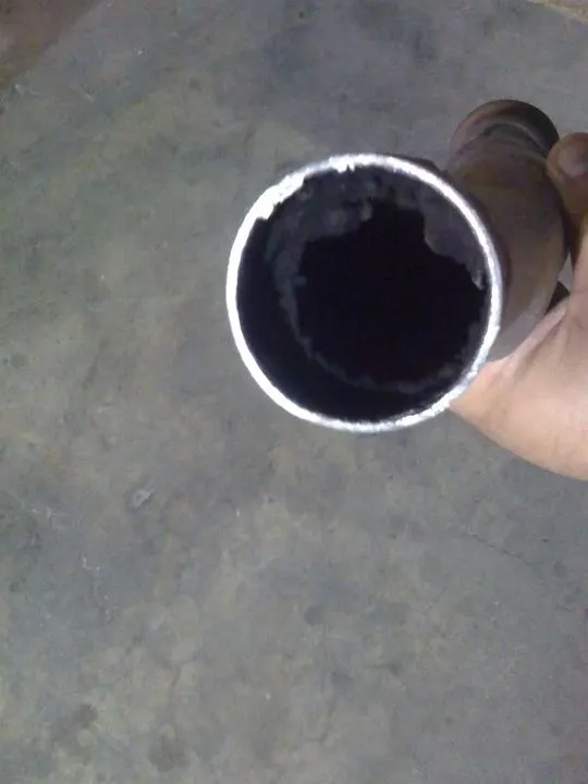

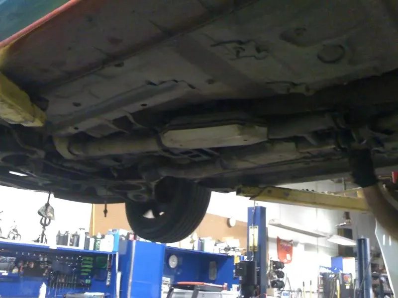

**** YOU CATS! ALL FOUR OF YOU CATS!
Here she is empty as can be...

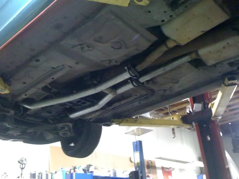

Anyhow, new H-pipe mounted at the exhaust manifolds and center hanger.

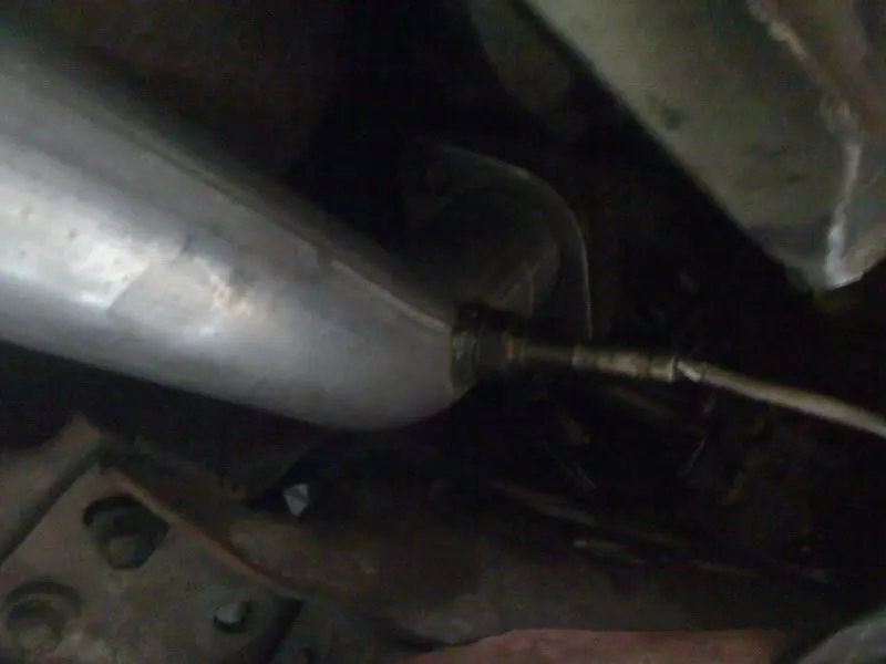

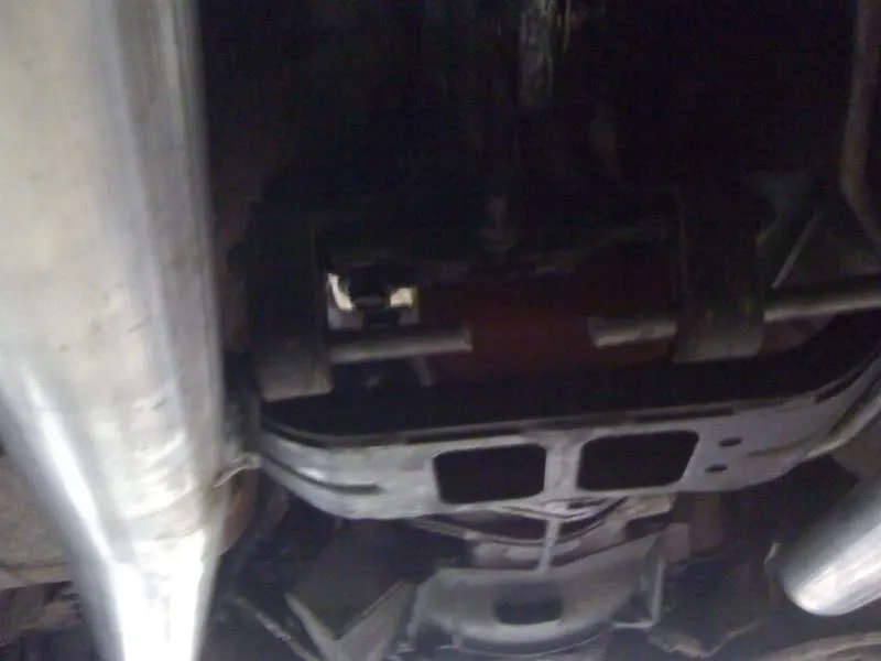

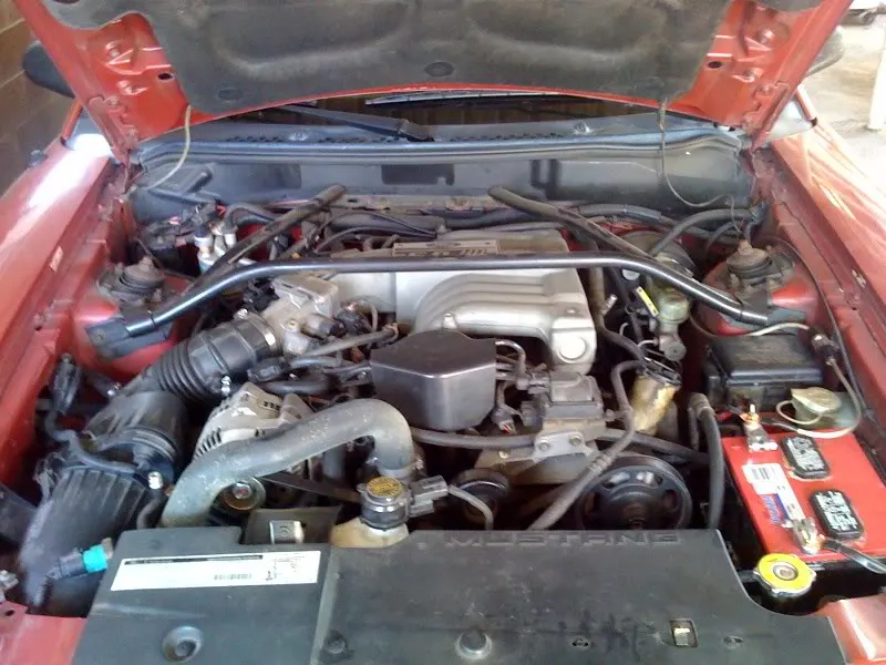

O2s installed...
A pic of the center hanger...

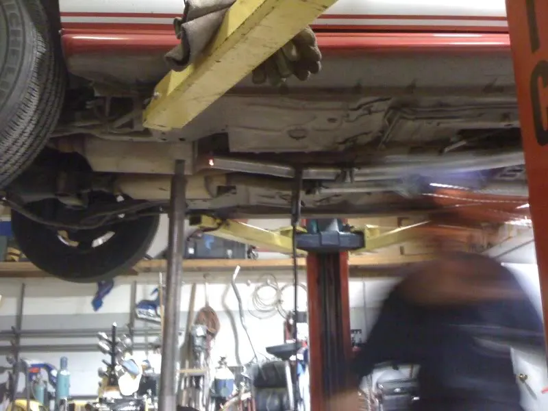

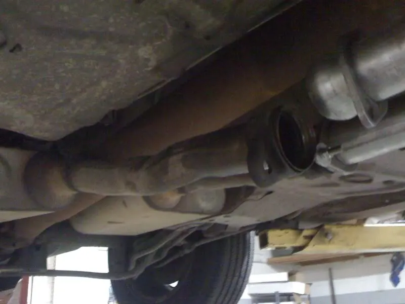

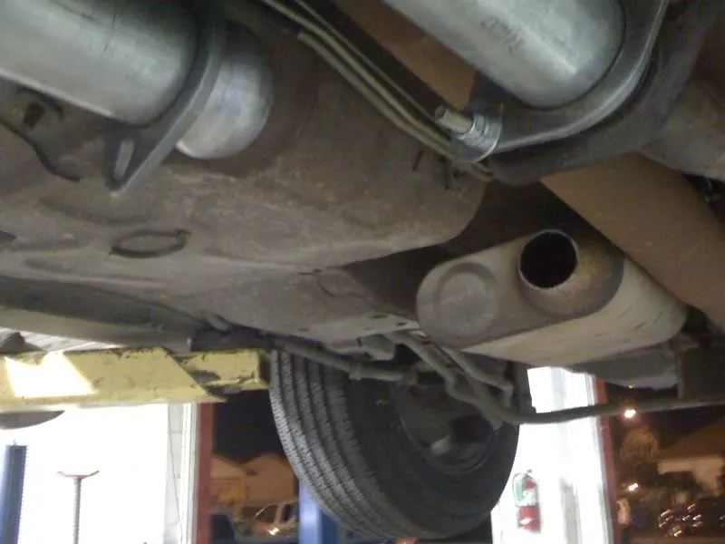

It all went smooth until...

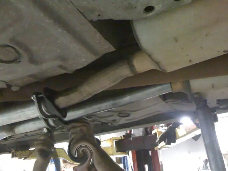

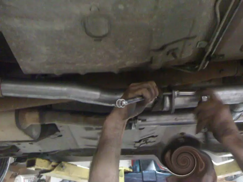

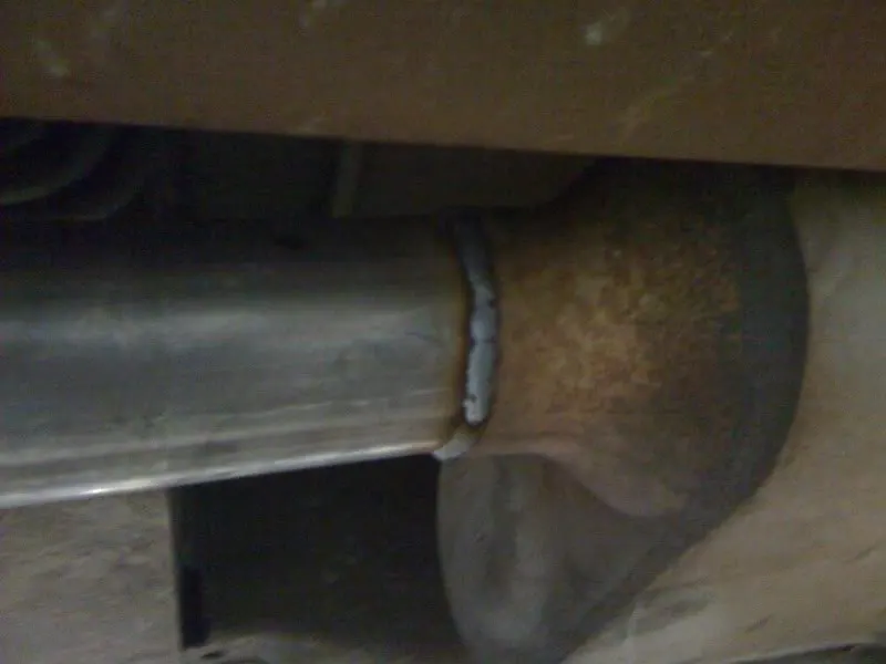

As you can see, the kid who owned it before me had these old school Flowmaster 40s installed, well when they were installed the guy who installed them didn't install this peice of piping correctly. If we got the flange to bolt up to the H-pipe, the muffler would be literally touching the drive shaft... Which is a big no-no.
Here's what we did instead...
We cut that ****er off! Anyhow, here's a pic of the amazing weld job the previous owner had done.
Welds like that were located all over the stock H-pipe, as if someone removed the cats then reinstalled them to pass smog.

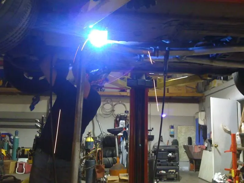

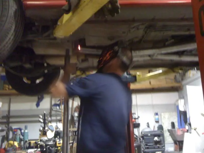

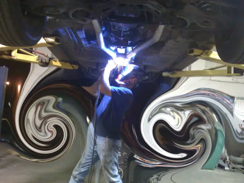

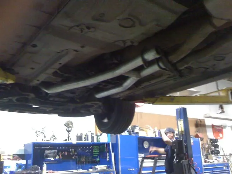

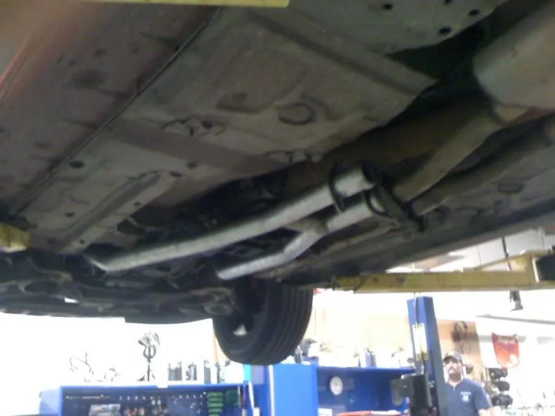

Here's some new piping getting installed...

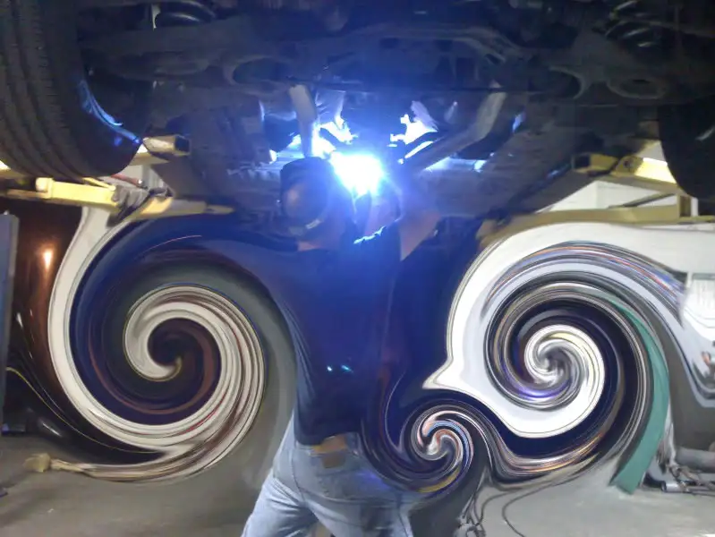

This guy, we'll call him Pablo... Pablo did some really good work! I think I found a new friend!
Now, all fun has to come to an end...
Very nice neat and clean welds...

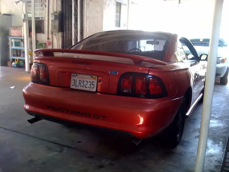

Here's the end result...
I started it, and MAN! I love the sound of this thing! NOW SHE SOUNDS LIKE A V8!
