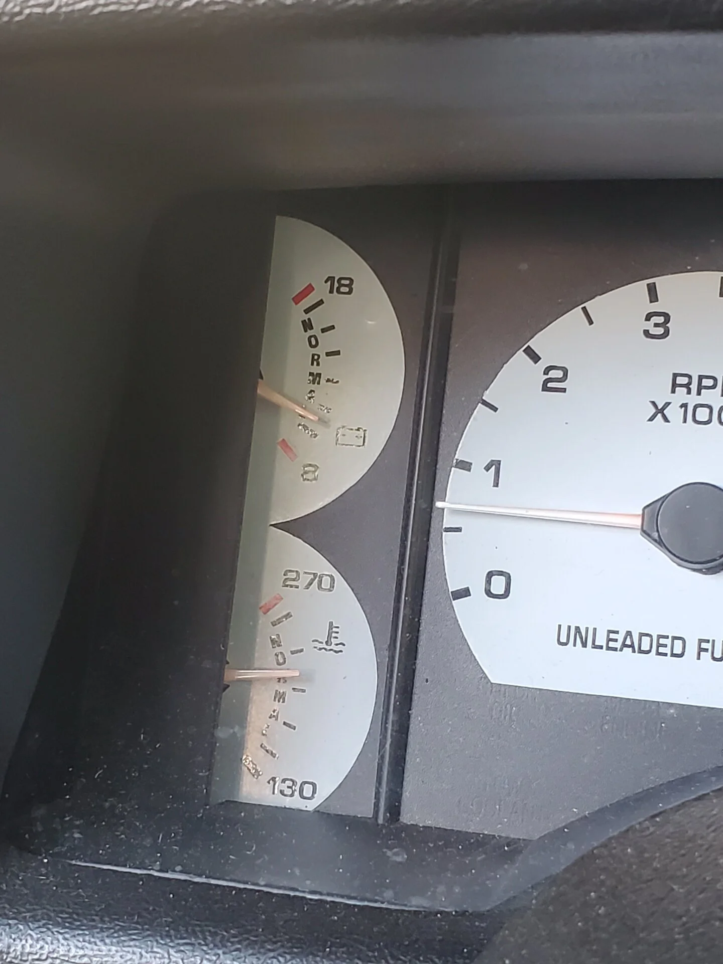

Ok so ran codes got koeo code 82 and 15.and my koer code was 12. I'm fixing to do the smog delete so that will take car of that. but I don't see why it doesn't have any low end power. It feels horribly slow, and there is no way it'll do a burnout. Not sure if this would make any codes come up or power loss but when I run my ac and everything my voltage drops horrible low, can a bad alt cause power loss like that?? I'm sure some of these questions sound stupid. But this is my first fox and jsut trying to figure it out

Put a volt meter on the battery to get a true reading. Good idea to do a load test while you are there, check volts at idle with nothing turned on then turn everything on and compare the readings.
