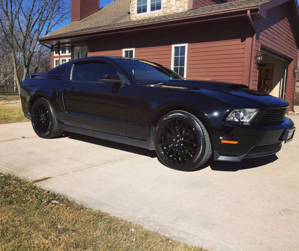

Hey guys just stopping in the say hi. In from northwest indiana just bought a 2012 mustang gt premium in in love with it. Quick question though sometimes my gears when I shift go in smooth as butter and others its harder to shift into gear especially at high rpms if anyone else could address this for me if appreciate it.

nice looking ride. How many miles on her?
