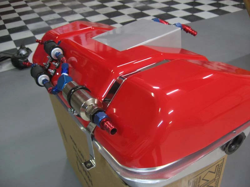

One external Walbro 255 will get you to 400hp and a little beyond, to the point where the stock bottom end will frag. If you want to go beyond that, you will need to run a dual external Walbro setup, run Bosch 044 pump(s), or an Aeromotive setup. Checkout Home - Glenn's Performance for some of the options. I bought their dual external complete fuel system with a sumped tank.
Let me just say that it the most beautiful fuel take i have ever seen.

that system is configured, as pictured, as a return style system but it doesn't mean that you have to configure it that way. The only cheaper system is to buy a used 03/04 Cobra fuel tank and run dual internal pumps via a Fiore Precision fuel hat. The 96-98 tank can only run a single pump inside and even then the pump location and pickup isn't sumped at all, meaning it can end up drawing air in a corner or when you are at 1/4 tank of fuel. I went the route of a single internal Walbro 255 made for my 96 Cobra but for my current build did a lot of research on the fuel modifications available for our cars. A customer of the shop where my car is being built blew 2 motors due to fuel pumps not being able to keep up with fuel injector flow and therefore going lean. For me, I decided that it is one area where skimping isn't worth the risks.
