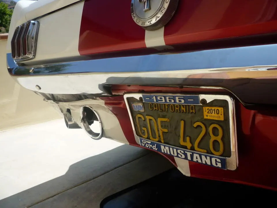

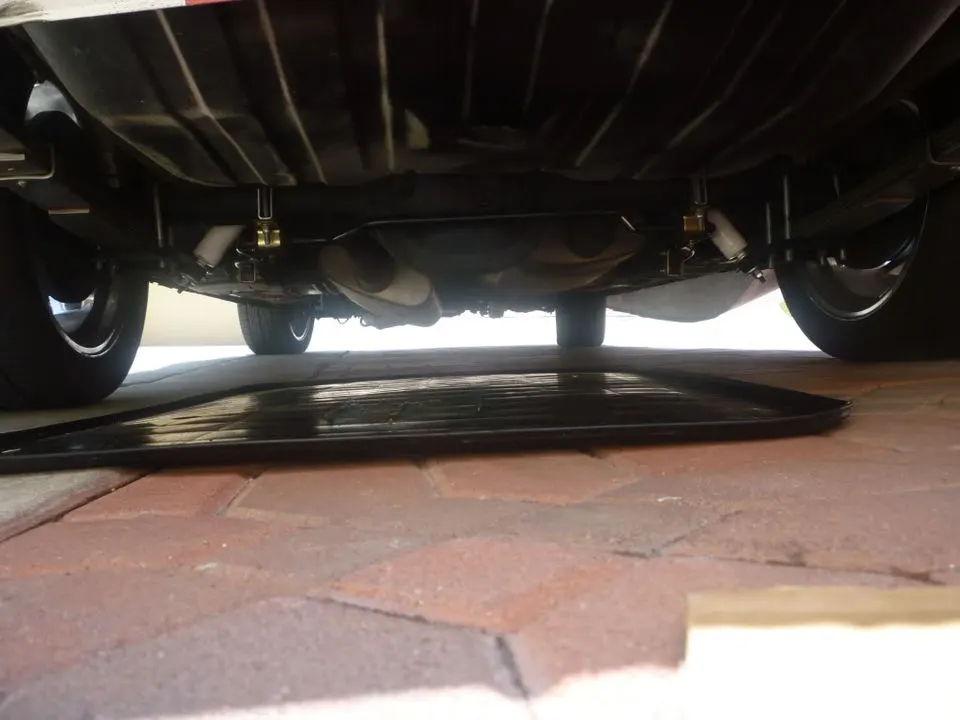

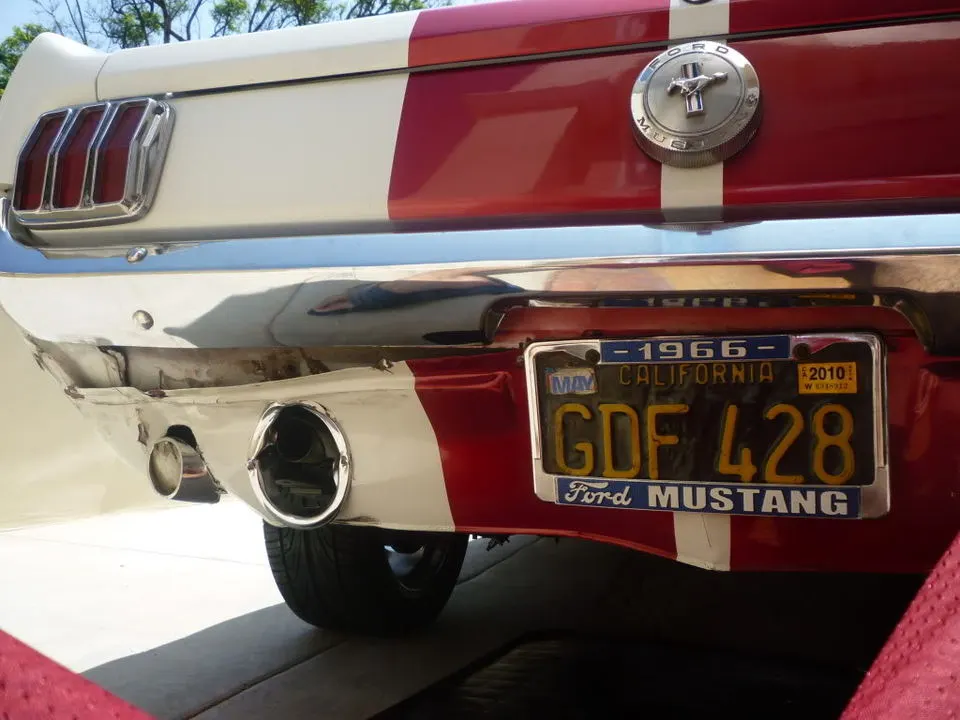

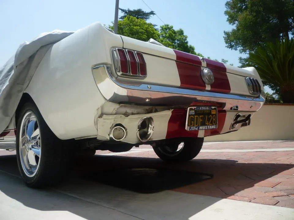

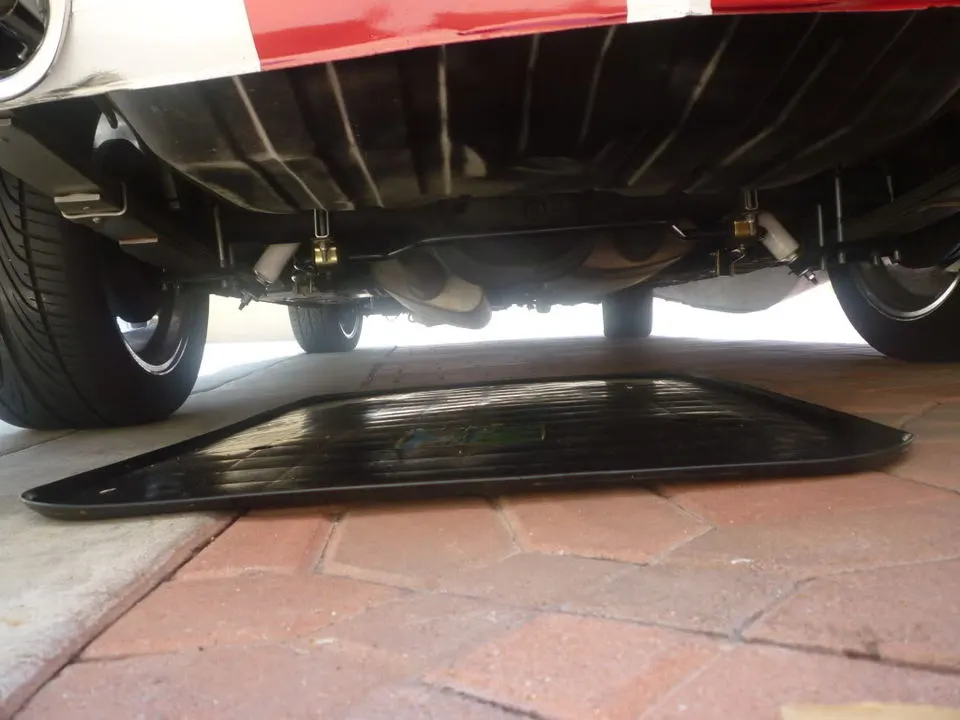

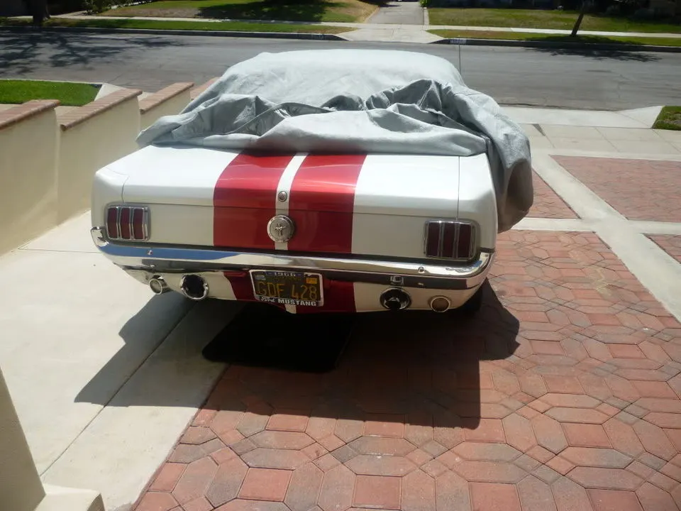

Hey all, had an accident today, I got rear ended on a busy street, got hit by a civic going 30 miles per hour and I was at a standstill; the rear apron is shot, my muffler got hit and got pushed in, and the gas tank punctured, the hood also got misaligned. Battery got knocked off its tray (granted it was held by a bungee cord; i was going to replace it with a proper hold down tomorrow) and the ground cable flew off, hence the car stopped running.

The accident wasn't huge, and i think one of the body's bolts is what actually punctured the tank, but its hard to tell what exactly happened while its all mangled on the car still. There were stupid people on the sidewalk flicking cigarette butts not too far away and if it landed close it would've gone kaboom. Which is just as bad IMO, a fuel cell would prevent the puncture from the first place which is the safety I'm looking for.
