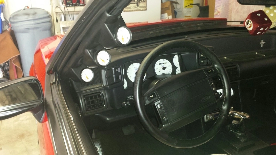

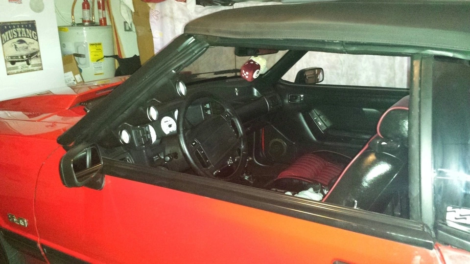

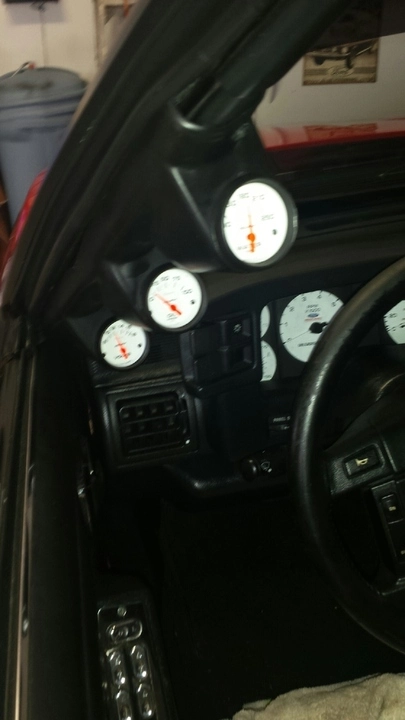

Installed Autometer Oil pressure, Water Temperature, and Volts gauges in a pillar mount pod. SInce I have a bad back, took me about 3 hours total including installing the new senders, routing the wiring underhood, under the dash, and installing the gauges in the pod. Overal, happy witih the results and nice to know for real what the car is doing.

I went with electric gauges as I didn't want to deal with oil lines in the car. I used the same grommet for the speedo cable and wrapped the wires in 1/4" loom. Used an add a fuse to # 12 ( key on for the radio) and tapped into the dimmer switch + for the bulbs.
Did you hook up your water and oil gauges in a way to keep your factory gauges working too?
Yes. got a 1/4" male x 1/4' female x 1/8" female fitting for the oil pressure sending unit. Hooked up the stock sending unit and the Autometer to that. Relocated the stock water temp sending unit to the pad on the lower intake by the passenger rear.where the EGR coolant line used to be. It will read different as it is not in the direct path of coolant but it functions.
