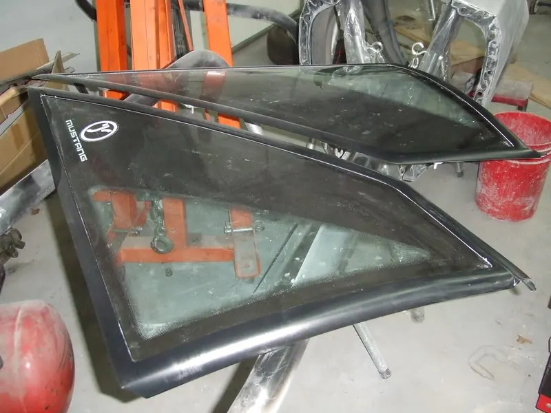

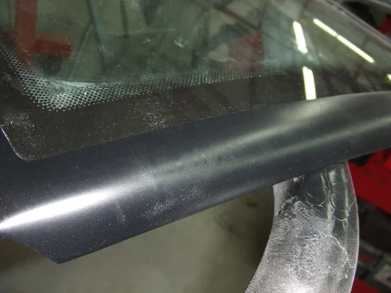

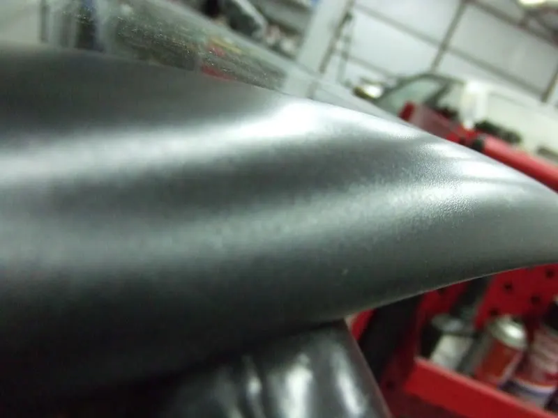

i redid mine as well. dryrotted pretty bad, took 3 cans of high build primer and one can of black trim paint. i don't have any before pics, but here's how they came out...
btw, all that white stuff is dust from sanding body filler.
Wow those look great i really need to do that to mine...what is the name of the stuff you used and where did you get it???Thanks
i used dupli-color high build primer and dupli-color black trim paint. you can get it anywhere, parts stores, walmart, etc. took about a can each...caking it on, sanding it down, caking it on again, some more sanding, then a final coat and sand followed by a couple coats of the trim paint.
