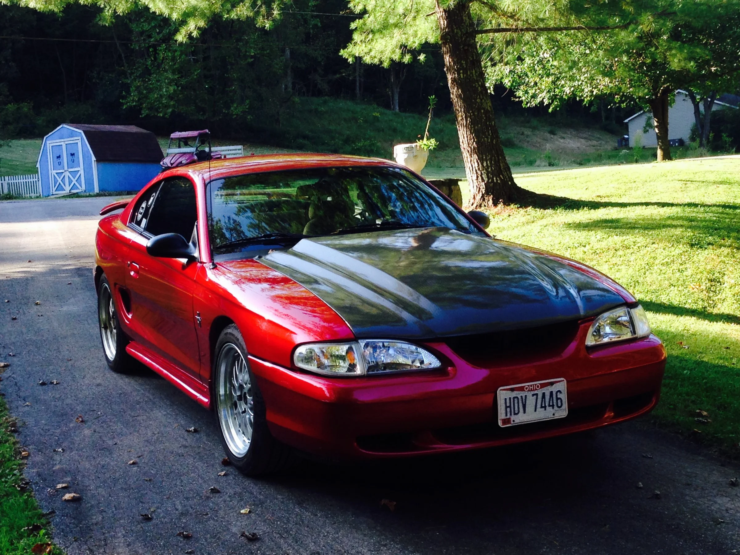

ive got a pretty clean and good looking 97' mustang 5 speed with 96k original miles buuuuuuuuut it's a 6 banger but I've also got a wrecked 97' gt 5 speed without a title. Looking for a few pointers of the easiest way I can swap the cleaned up and cammed 4.6 and trans into the v6 car. I figured drop it all out of the bottom? But what are the differences in the harness?
