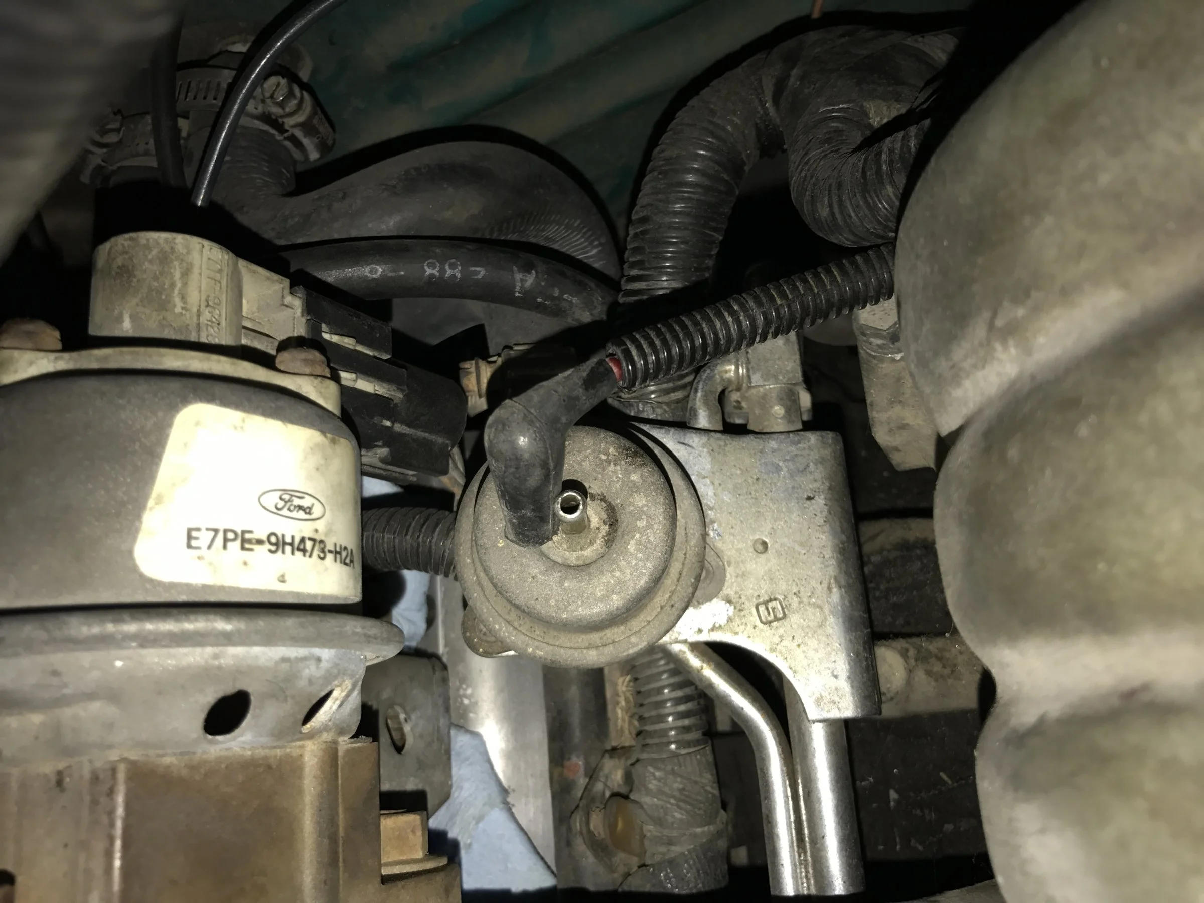

Not sure what you mean by pull spout. This looks like the fuel regulator so I unplugged the line to it and tried to start it no difference.

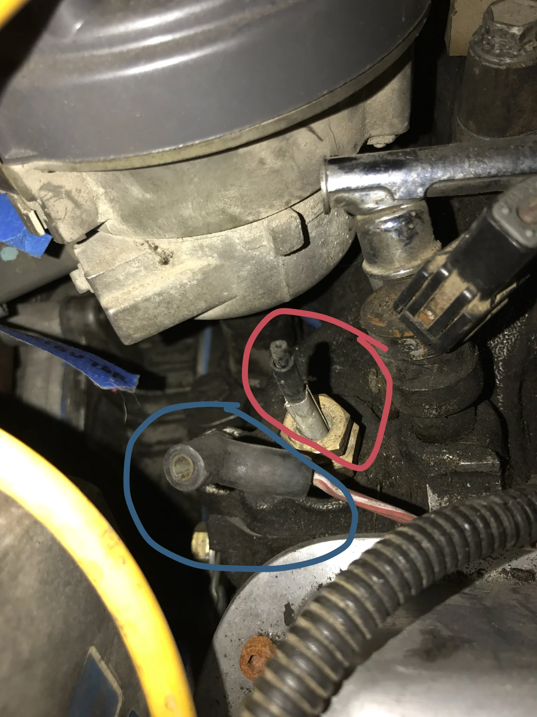

I know someone already said the one circled in red is the ect sensor but where does it connect to?
Also the one circled in blue what is that?
The red circle is the temp gauge sender location, from the looks of it that is the bulb to a aftermarket gauge, the blue circle is the wire that plugs into the stock temp sender, get a stock temp SENDER and put it in the hole circled in red, plug the blue circled wire into the sender.
The temp SENSOR (ect) is mounted in the heater tubing on the passenger side and has two wires connected to it.
It can be easy for a novice tow get them confused
Sender for temp gauge= 1 wire
Sensor for computer= 2 wires
