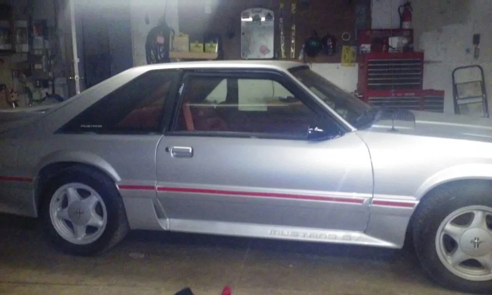

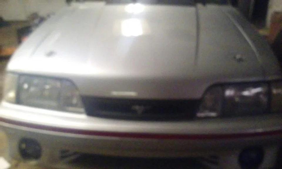

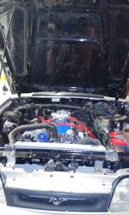

Hey everyone, New guy with a 91GT. I bought the car 2weeks ago needs some work to get back on the road.
It has been switched to carb and needs finished. Guy messed up the carb by setting the pressure regulator way to high. Bent a float needle valve. Ihave a rebuild kit ordered.
Next the throttle cable and tv cable where cobbled in. I also ordered Lokar throttle cable ,tv cable and the right bracket to hold cables of the carb bolt. Also a TCI corrector bracket for the tv cable.
Hope to get it running right this weekend when parts come in. I have a couple of pics not the best.
Looking forward to getting to know the forum and members.

The fuel pressure regulator probably wasn't the only thing the P.O. did wrong...
If the fuel pressure regulator failed and flooded the engine with fuel, it washed all the oil off the cylinder walls. You may have some cylinders with score marks in the cylinder walls.
I hope you like pain because the odds are you bought yourself a boatload of it. See the document below on what is needed to do a EFI to carb swap correctly...

I am having trouble picturing the needle being bent rather than the float arm tab. What kind of carb does it have and what CFM?
