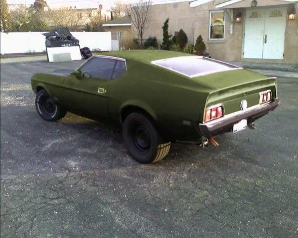

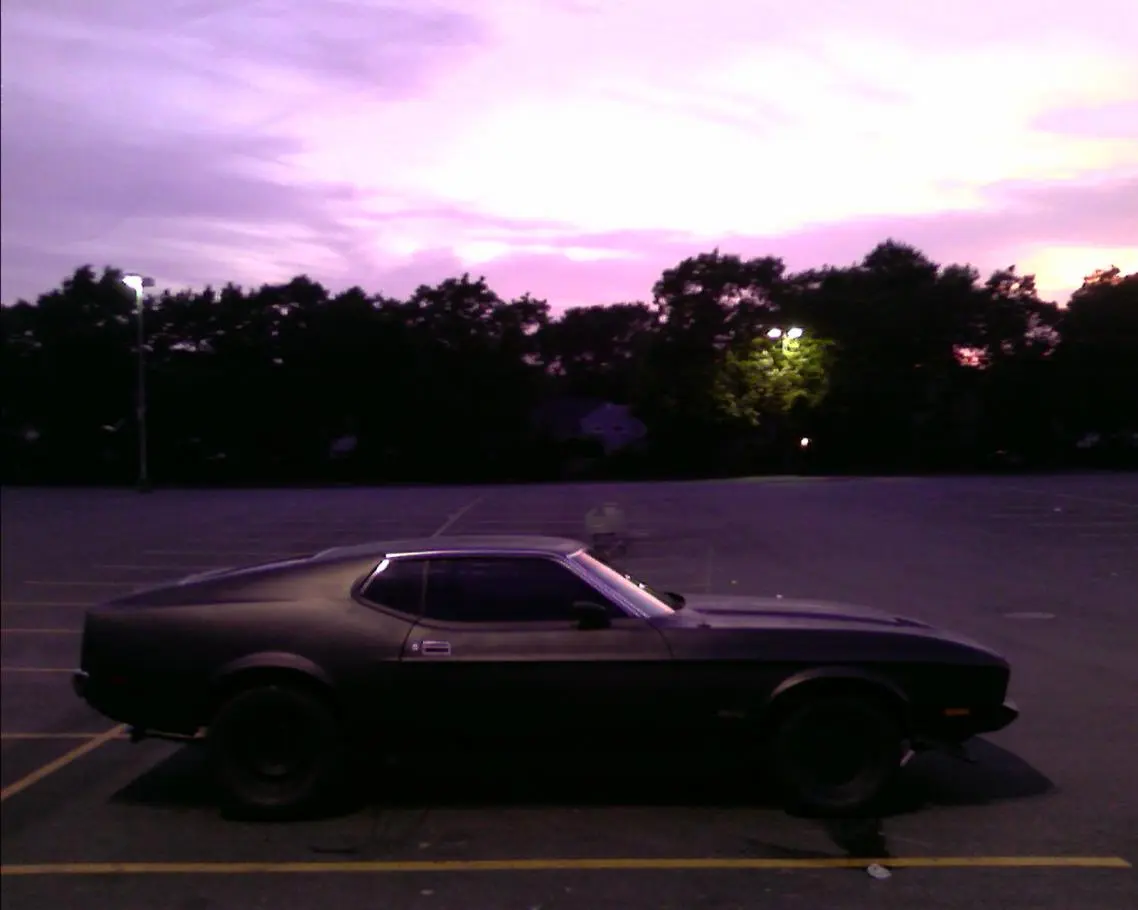

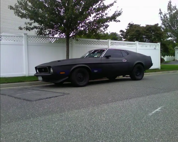

What's going on, I'm currently fixing up a 73 mach 1 with a 351c, 9" rear w/ 3.73's and a (burned out) trac-lok and a top loader tranny. It has an edelbrock manifold and carb, msd distributor + wires with a 6a box (that's getting dumped for a digital 6). I redid the suspension with new upper/lower CA's, 1" drop springs in the front and a 2" lowering block in the rear, new leaf springs, KYB shocks and slide-a-links (which I can't seem to set up right :(). I just bought a set of aussie heads which will bump up the compression (much needed) and I'm getting headers with a custom exhaust and a snotty cam in the next couple of weeks. I haven't driven the car in almost a year, and it started right up yesterday, with the dashboard apart note: the gauges complete the "ON" circuit! the car won't start without the gauges in place :p. I fixed my leaky heater box and am updating the gauges with LED lights, so I can see the damn things at night. I'm pretty excited to put this together and finally make some power with this thing. This was my first car and I daily drove it for my last year of high school. I'll get some pictures up tommorow.
maybe 1 or 2

4.) not nearly long enough, I bought a set a year and a half ago, and barely put 2000 miles on the car, oddly enough the passenger side is almost bald:rolleyes:
