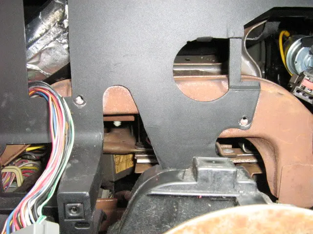

Pics from my article
Notice, over to the right. This is on the drivers side above the gas pedal right begind the gauge cluster.
You can find more for refernece here:
http://forums.stangnet.com/showthread.php?t=646250
Good Luck

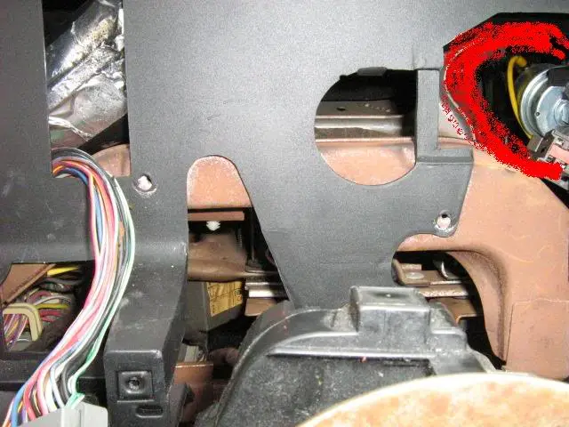

SO if i get under the driver side and look above the actual gas pedal i should see it or what? cuz in the picture i can see where the wire is but i cant see what it acutally goes to.
Good Luck
Look again
With the cluster out of the way, if you look at the gas pedal (from the drivers seat) and then look str8 up, you will see it. Got it? If you have a Chilton, it may tell you the exact name of the part.
Good Luck
