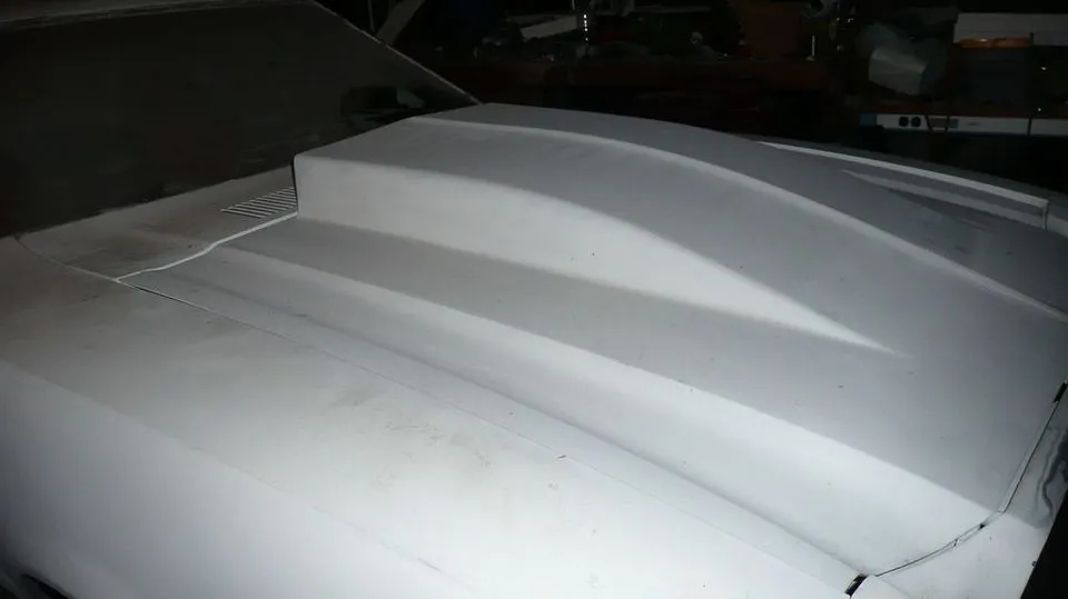

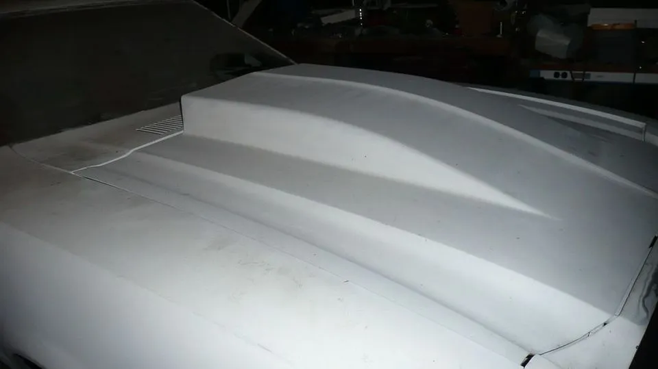

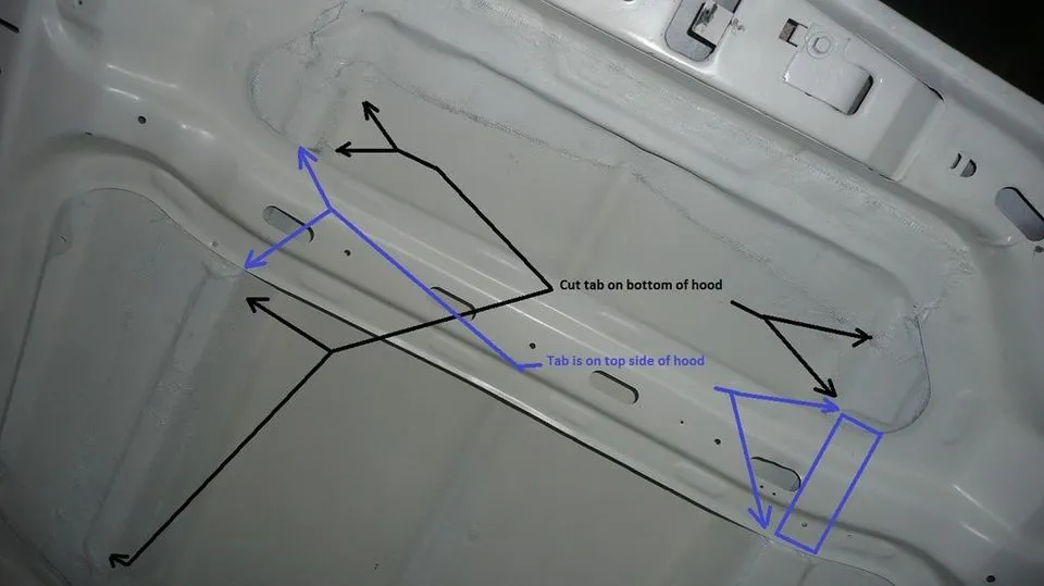

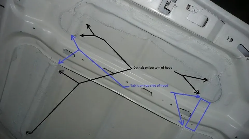

Howdy all, after installing the new engine, the top of the carb was flush with the stock hood, so I installed a 4" cowl:
I cut grooves into the sides of the scoop, creating something like "tabs", where it flattens out on the side of the scoop for about 3 inches and slid the scoop side tabs in between the metal of the hood on both sides. Then I resined it into place and a few layers of fiber cloth, it's going nowhere. I hope that it explains it, a pic:

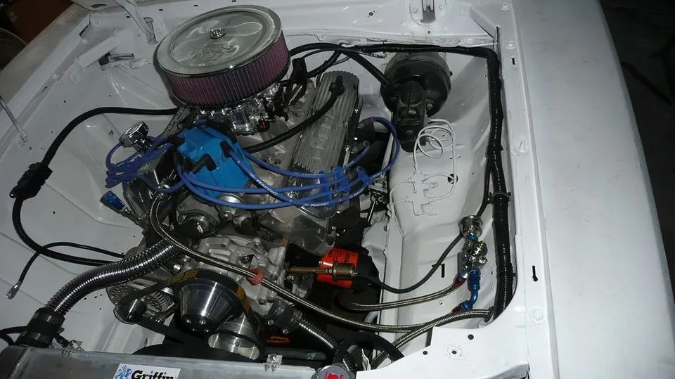

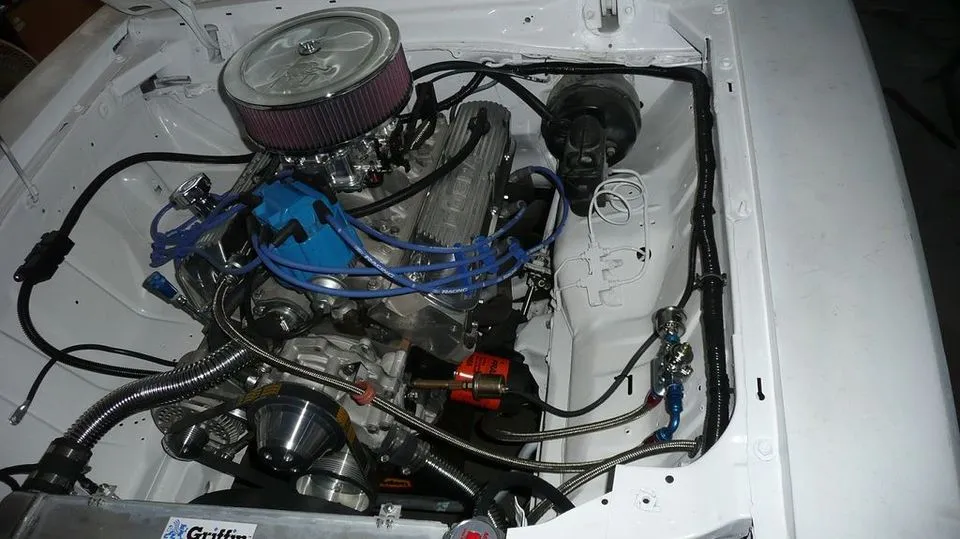

And the engine is installed and running:
Started right up and after fixing a major fuel leak it ran great, until...
My temp gauge steadily rose to about 200 degrees in about 3 mins of running, so I shut it off. Checked the water in the radiator and it was dead still and just about room temp. The heads and intake were hot to the touch. They seemed hot enough that the thermostat would have opened. I think I might pull the thermostat and run without it to see if I get a different reading. Or possibly the water pump I installed is wrong? I'm going to check it out as soon as I can find the receipt.

Looks great.
Are you 100% sure the head gaskets are in correct? Do you have the correct water pump (rotation) and the correct Timing cover for that pump?
If you want to clean up the look of the engine Compartment a little more even. A master cyl, from a 90 Bronco II with an adapter for the front port to change the fitting size will get rid of the nasty looking cast iron thing. It's the new style with the aluminum body and plastic bowls.
Tim
Tim

As Coyote, the correct Explorer master cyl. will do 4 wheel disks, the Bronco II is a drop in replacement for the factory unit (drum/disk).
That cover and WP look to be ok. It's not out of the question that you have a bad thermostat, or possibly installed backwards. I've also heard of people drilling a 1/8" hole in the "disk" of the thermostat to slim the chances of a air bubble getting caught behind it at the top of the intake.
Keep us posted.
Tim

I just got done fixing the water temp problem, engine cooling works great now. Turns out that the gauge was displaying the wrong temp the whole time. When I installed my Autometer gauges, I failed to install the water temp sender that came with the gauge. After swapping out the sender, the right temperature was being displayed on the gauge...duh...Oh well a simple fix.

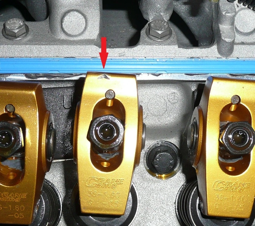

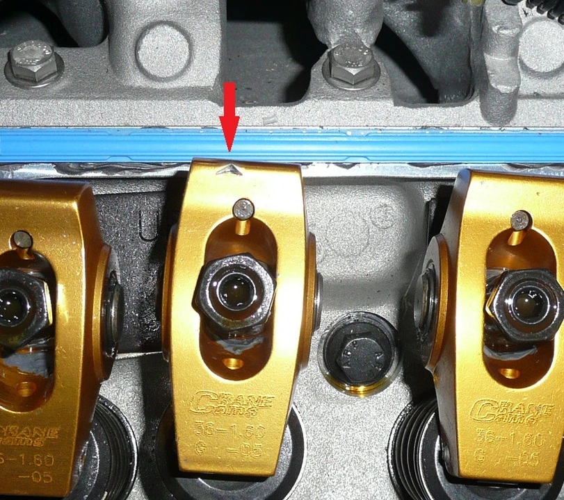

Now the next problem, I'm hearing some ticking from the engine, like a lifter isn't pumping up. These are new rollers and I suspect one or some of the rockers isn't adjusted right. Time to pull the covers and check it out.
Well I found the ticking noise immediately after pulling the pas side cover, not to happy, but fixable. The oil filler baffle screw was hitting one of the rockers and left some damage :(
I wont feel comfortable using this rocker and I'll keep it for spare, the good news for me is that Summit sells a single rocker arm for $26. And of course I removed that damn baffle.

Good to hear you found the source of your noise. Sucks about what is was though. We had a similar issue with my buddy's Monte SS. But it was just the corners of the outer 2 rockers on each side just touching the in the insides of the cast valve covers. A quick clearance with a die grinder and we were good.
Tim
