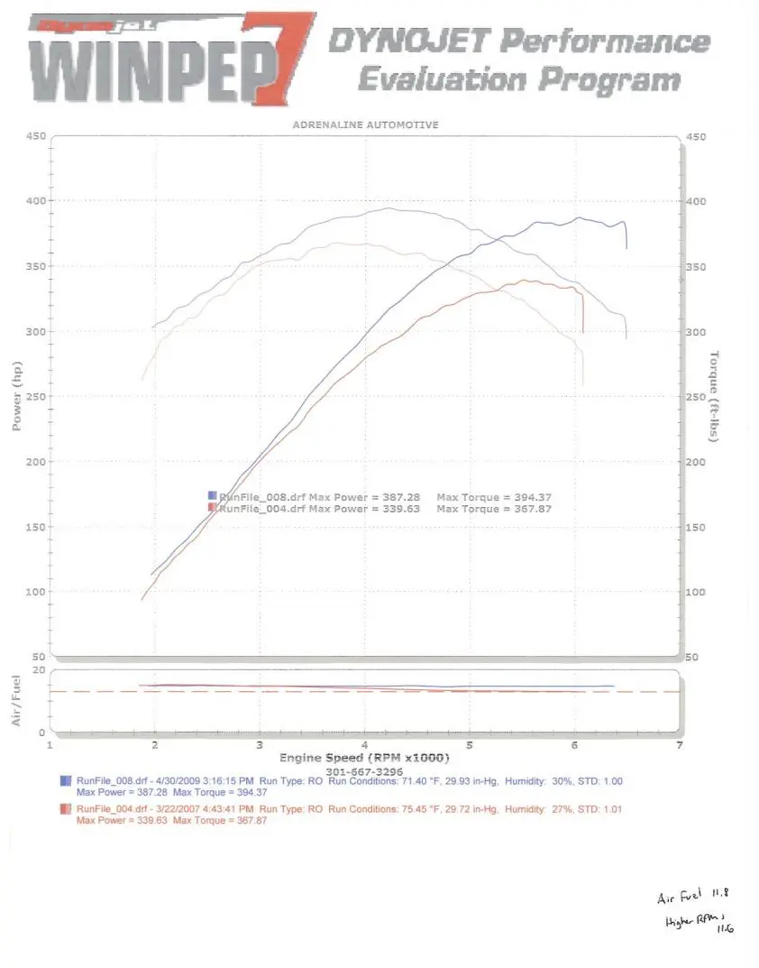

This is a very good point and why you can't necessarily compare results with what I have.
My timing was 14 degrees which is the stock saleen timing. That's a VERY important difference. I went conservative on purpose because I'm on stock internals. If I want a paper to read 400....then I'd increase the timing (or tune it for race gas) and go more aggressive. I'd rather keep my car safe and have peace of mind when I floor it.
The tech drove it 35 minutes to the dyno....strapped it down and then fired it up (no cooldown). We did it this way in order to compare results with the last time I had a tune. Why did we do it this way? Because we wanted to compare it to how it was done last time on the same dyno.
There were no tricks on my dyno runs. No race gas, no nitrous shot, no packing ice or letting it cool overnight on a dyno to inflate the numbers. Just increased the tune for added air and still left the timing at stock (14 degrees). The air temperature and humidity were almost exactly identical. Whenever you see people add an intercooler or a tork tech intake or a CAI.....shops typically increase the timing which increases the gains. I left HP and torque on the table in the interest of extreme caution.
It's pointless to compare a dyno sheet against someone else's because dyno sheets are very easily manipulated......but here you go. Have at it!
PS-potential HP of 500 with a KB system are a moot point for me. Like I said....I was looking for 390 on a safe tune and I have no intention of forging in the future.
PSS- The throttle response with the single blade oval throttle body is like night and day. I really can't describe how much quicker my car feels...even compared to my old accufab 75mm.

I'm not saying those gains suck or your car is slow. I'm just saying there was other routes you could have taken and ended up with more hp. If anything you can get maybe 400hp from that thing on a dynojet, but you wont ever see that on a mustang dyno. You'll blow the engine at that point.
Trust me that if you own that car long enough, and the engine decides it wants to head out and you replace it with a forged engine (because its only a little more than stock) then you will regret putting all that money into the saleen unit, and wished it had the upgrade capability of the kenne bell.
Just drive safe and remember that as long as your happy that's all that matters. I hope you dont have many miles on your car, if so and your car starts to feel slow i would take it to be checked out.
