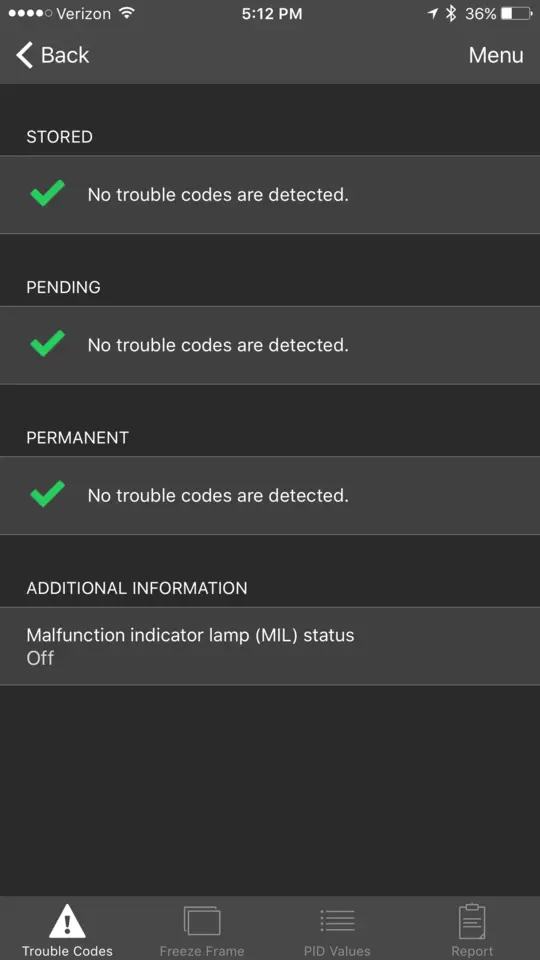

When I plug in my obd2 I'm getting "Malfunction indicator lamp (MIL) status Off", so I can not check for any error code, which is frustrating or a at least it seems that way.
Is there away to turn the MIL back on?​
I don't think that you understand what the ODB2 reader is trying to tell you. The message does not mean that the MIL light is disabled. The message means that as far as the PCM is concerned, there are no "conditions" that warrant setting a MIL status.

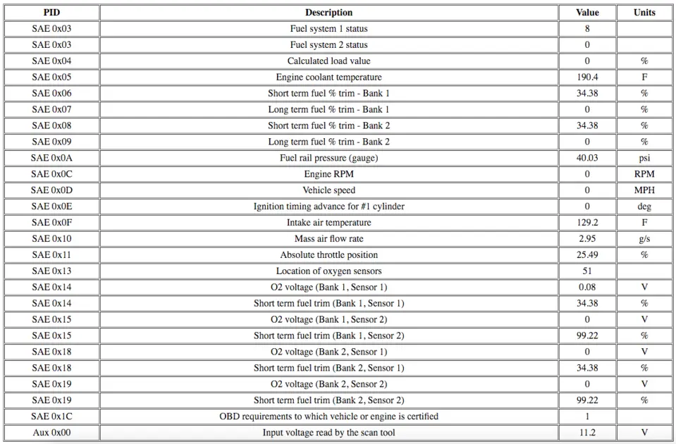

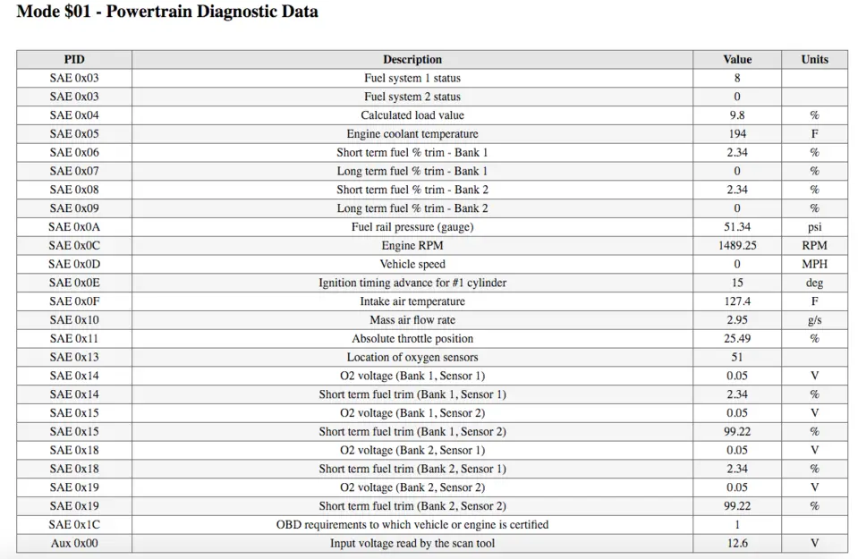

What does the PCM "think" the fuel pressure is? What is the actual fuel pressure as measured by an external gauge?
A: The odb2 software I'm using outputs a report here is my $mode 01 report, it seems right, but I could be wrong.
RPM's show zero. It sure would have been nice to have taken the report while the motor was running......................

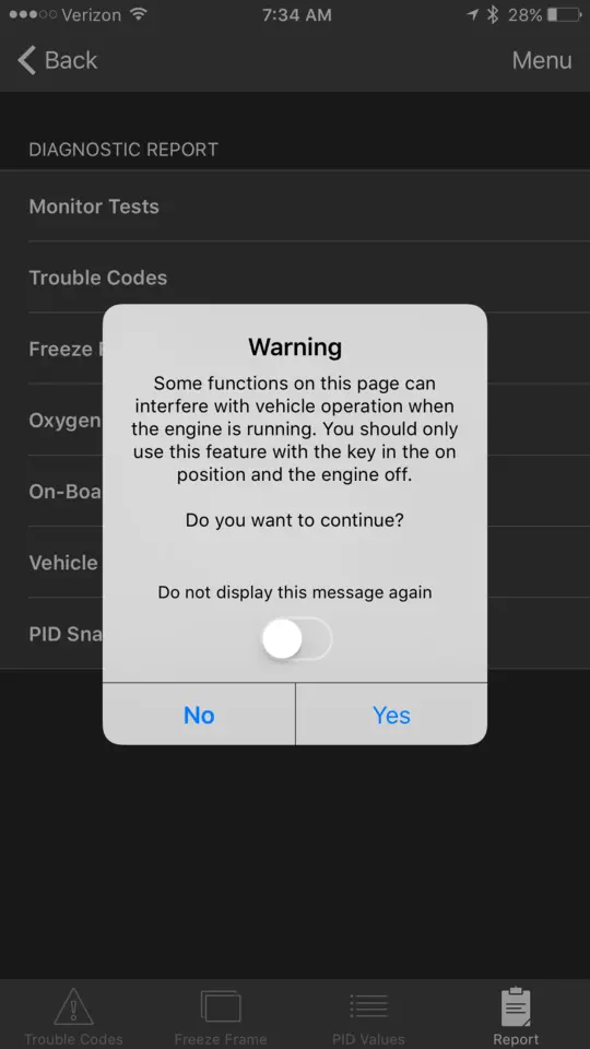

For some reason the app, makes strongly recommends to turn the engine off to do it's report. I'll give it a another run with the engine on.

This is the warning I get from the application when running a report;
Reports while running
Here is Mode $01 with the car running (after a 12 to 15 min drive to work);

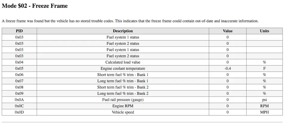

Mode $02

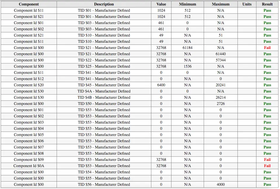

Mode $06 (also seems to suggest my cylinder 9 and 10 are misfiring)

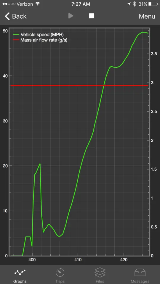

Driving the car here is a graph of speed and the maf reading (just stays flat);

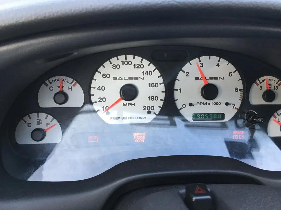

Just having the car on, not moving it turned off and this is what dash displayed;

Houston. We have a problem.
Take a look at the graph of speed vs MAF flow. Don't you think it's strange that has the car is being driven that the MAF flow stays the same?
Fuel pressure is 54 PSI which is too high. However this could be from the other DTC codes.
Why is the battery charge light on while the motor is running? Today's cars will not run right without a strong battery and charging system.
Regarding the massive vacuum leak. Perhaps. Or someone adjusted the idle stop screw in an attempt to fix a high idle.
@wmburns
Yea I always thought this was weird, and it seems kind of obvious, but this was my first new edge mustang and thought perhaps this is normal :(. I'm assuming the recommended fix here is to get a new MAF sensor.
What other DTC codes? Just curious if I missed something obvious here. What are something you'd recommend I'd take a look at?
The motor was not running; sorry didn't clarify that. The car had turned off on me at that point, and has turned off on me while driving it; in 2 to 3 instances (supposedly my alternator is good) and perhaps twice while parked on idle, on this occasion I just finished the test on the engine and a couple of minutes after that the engine turned off.
Do you think they did this to compensate for the damaged MAF? Should I replace the throttle or get the vacuum and screw looked at?
