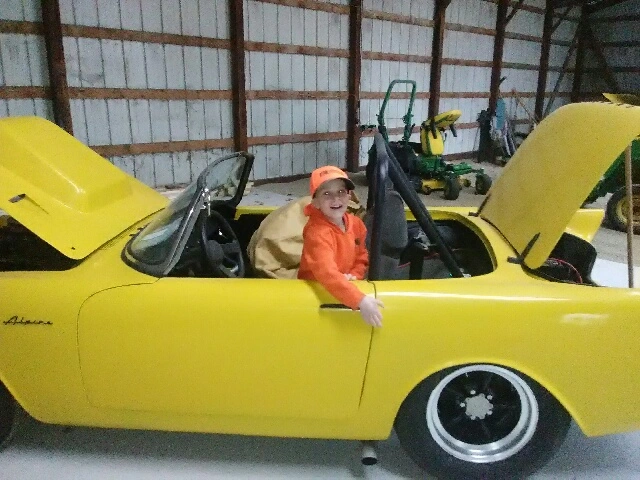

Just joined. Ford guy, from way back... Contemplating my first Mustang purchase for autocross and rallycross fun. Old road racer (formula cars mostly), from the Chicagoland area and moved to rural Iowa upon my retirement. My only current fun car is a Sunbeam Alpine with a warmed up 351w, 5 speed, narrowed 9" and MII front end.

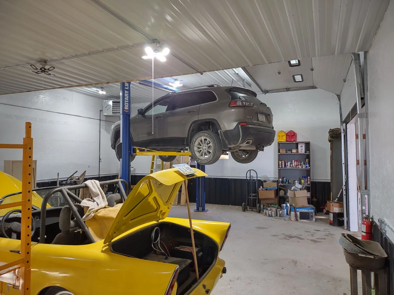

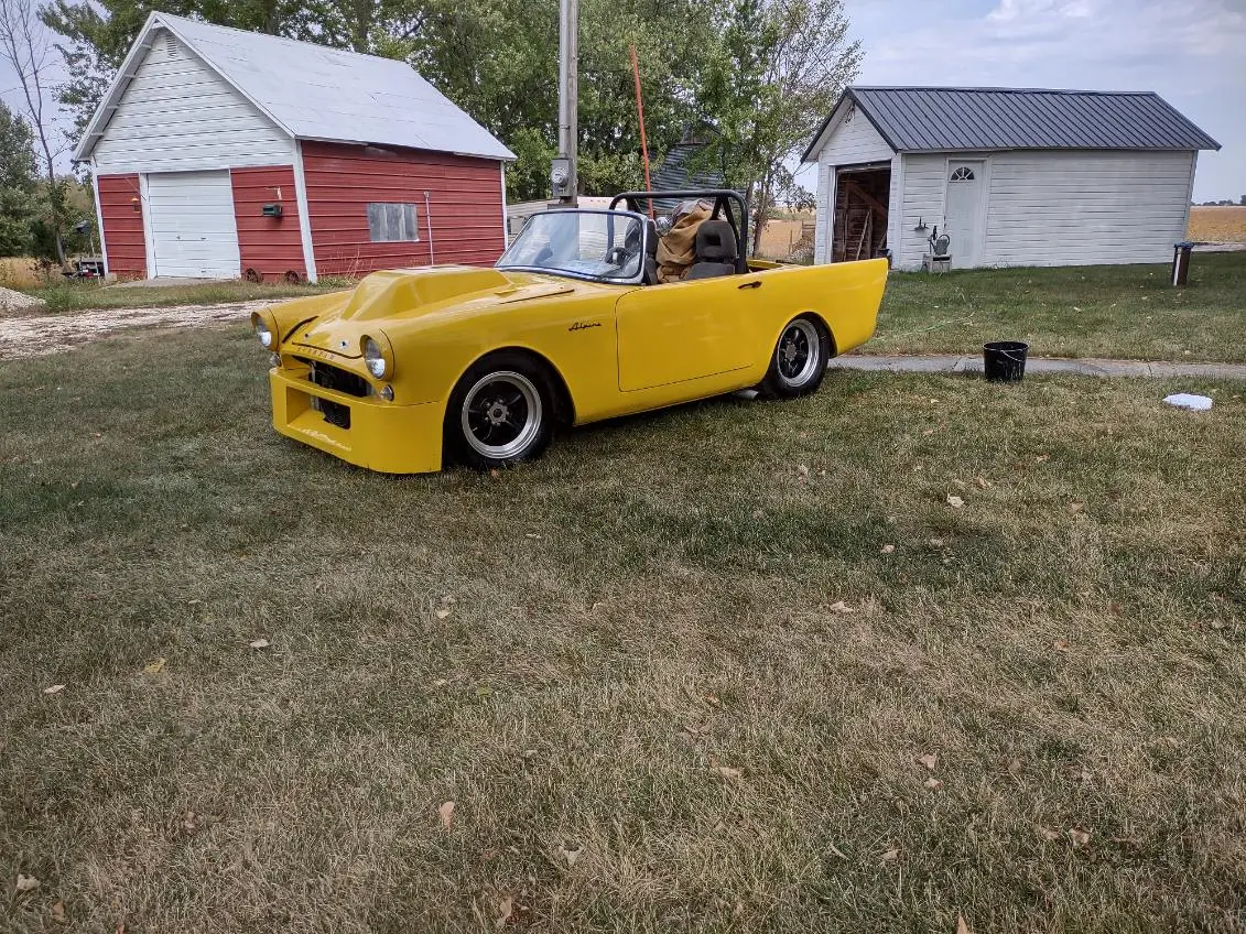

Thanks. I retired almost as soon as I turned 65. I just got done building a shop inside my pole barn. The yellow car is very squirelly on these gravel roads, and will destroy the lower painted body (even after I find some decent splash/mud/rock guards). I've yet to try it on a road/autocross course. It's a recent build and only has 130 miles on it...

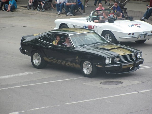

Welcome to the site! Are you originally from that area? I grew up in Waterhole - um, Waterloo - but lived in Kalona before moving to the Atlanta area. I lived on a gravel road and would have to drive my Cobra out to the highway at almost idle to try and preserve the paint job. Just for grins, here's a shot of my ex driving it through the 4th Street Cruise in Waterloo a couple years before I moved.
(I also run a MII front end.... :jester:)
