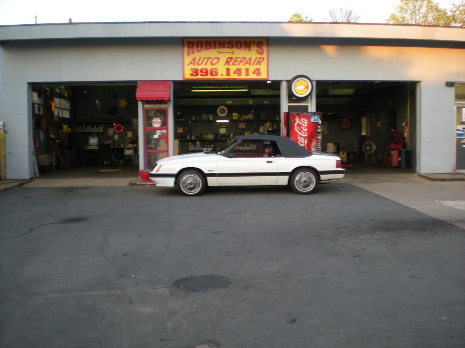

Just turned 70 today. Wow! Found this web page looking for a wiring diagram for my 1986 mustang l/x convertible with a 5.0 Just got it back from the body shop they really messed up a lot of stuff. When I hit the switch for passenger f/t window the door lock actuator makes noise window won't go down. It did before. They put a used door on drivers side and I guess the messed up the wires. Don't want it back in that shop so little by little I will figure it out. Retired mechanic.

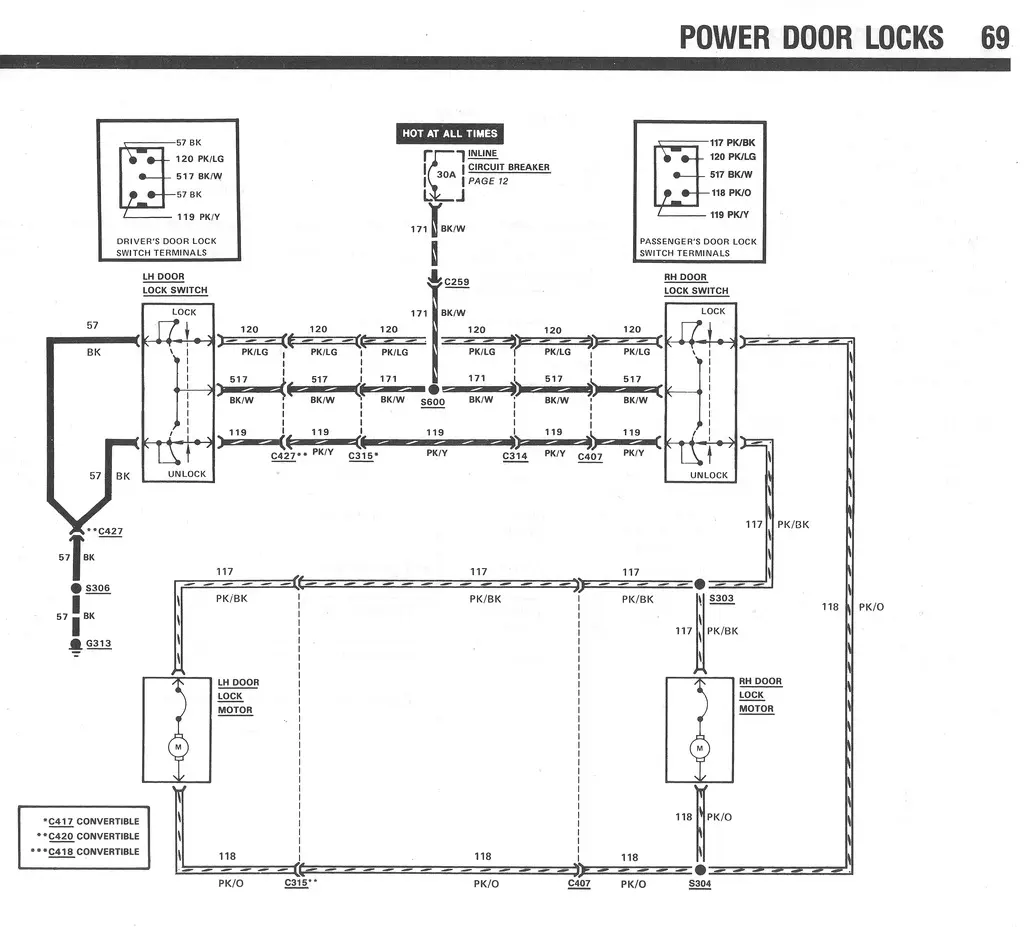

I have a 92 that I recently installed remote keyless entry on. I had install relays in the wiring harness. I'm not sure if the wiring for the 86 is the same or that similar, but I though this might help you out. Good luck.
A lot of wiring changes between 86 and 92.
