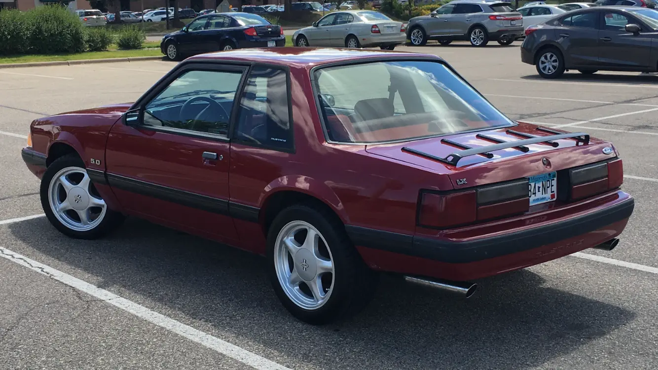

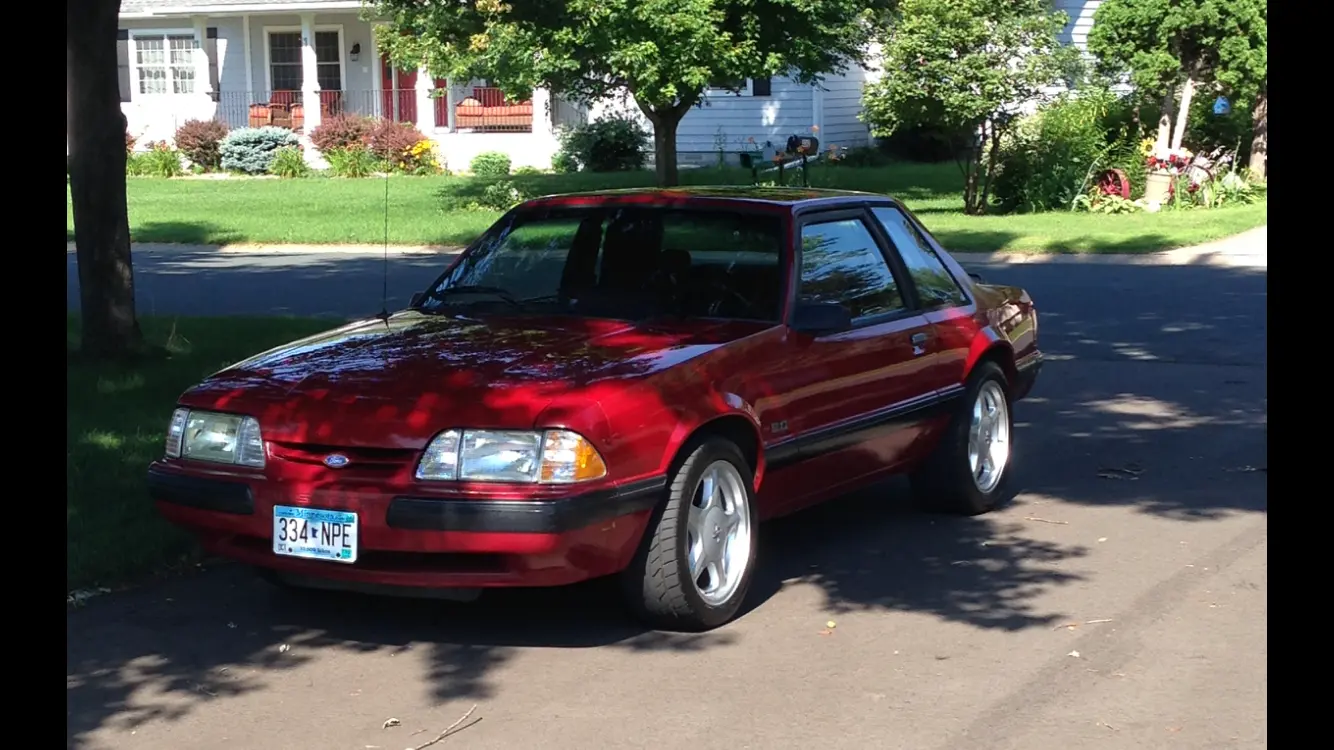

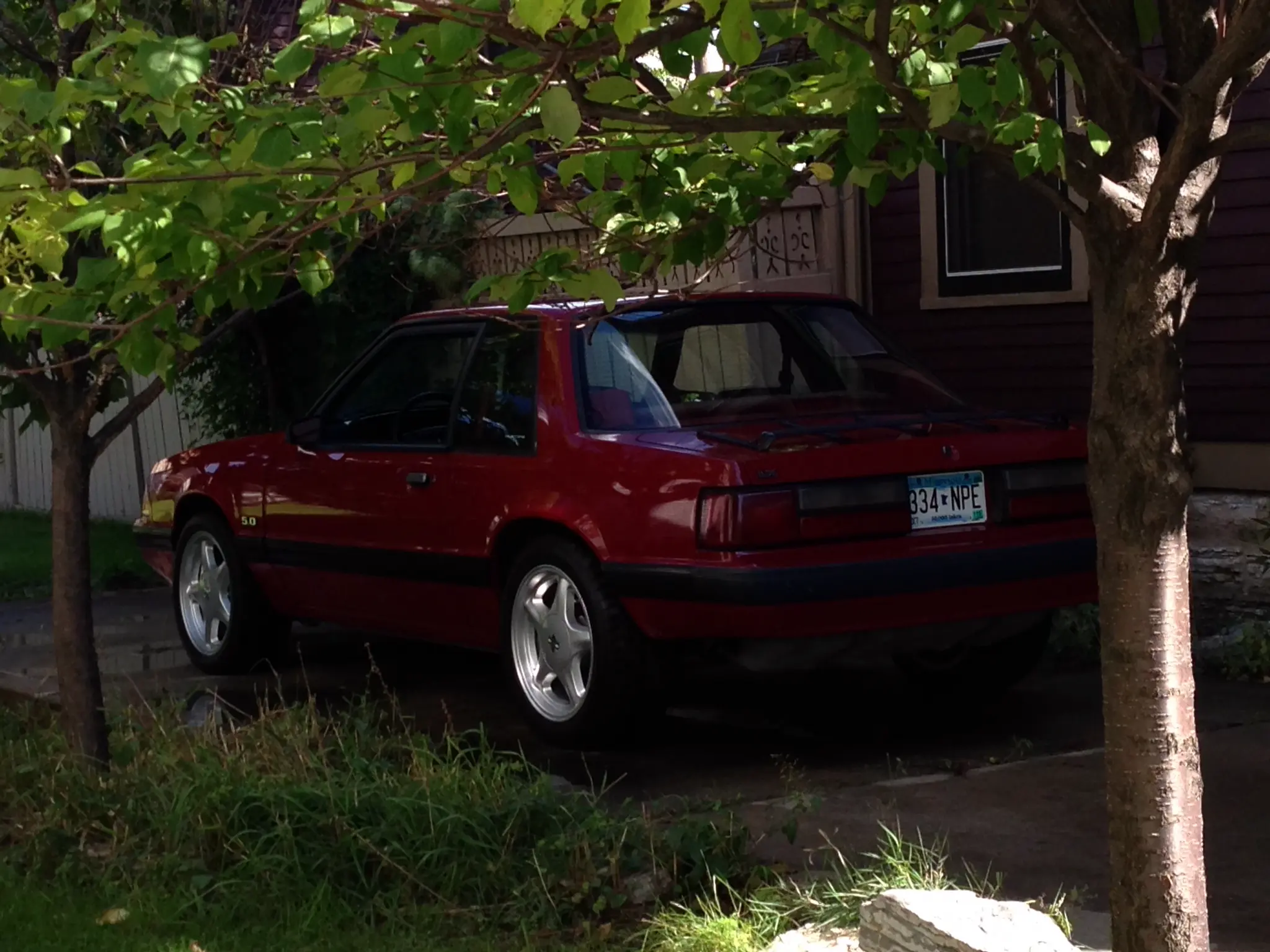

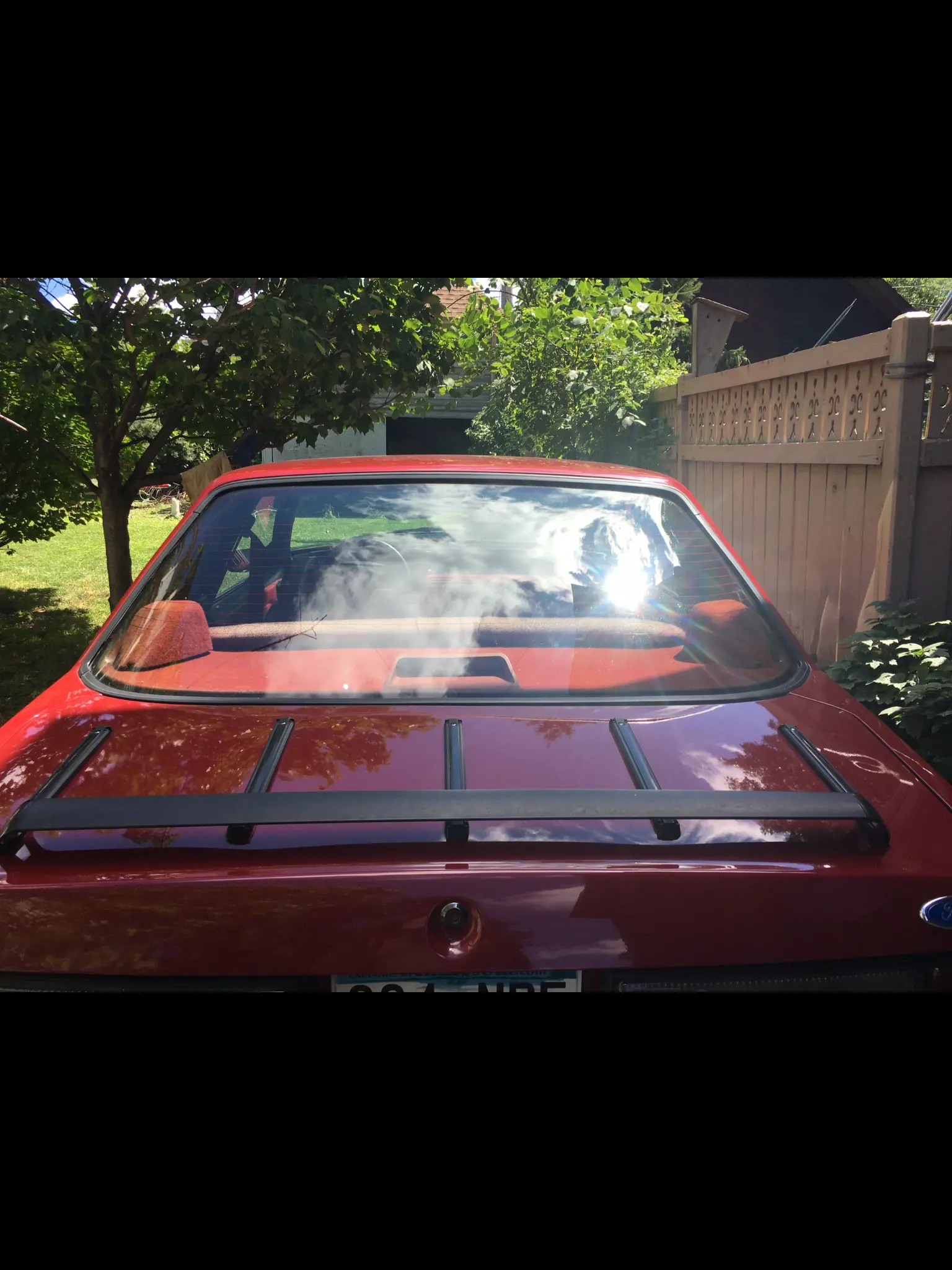

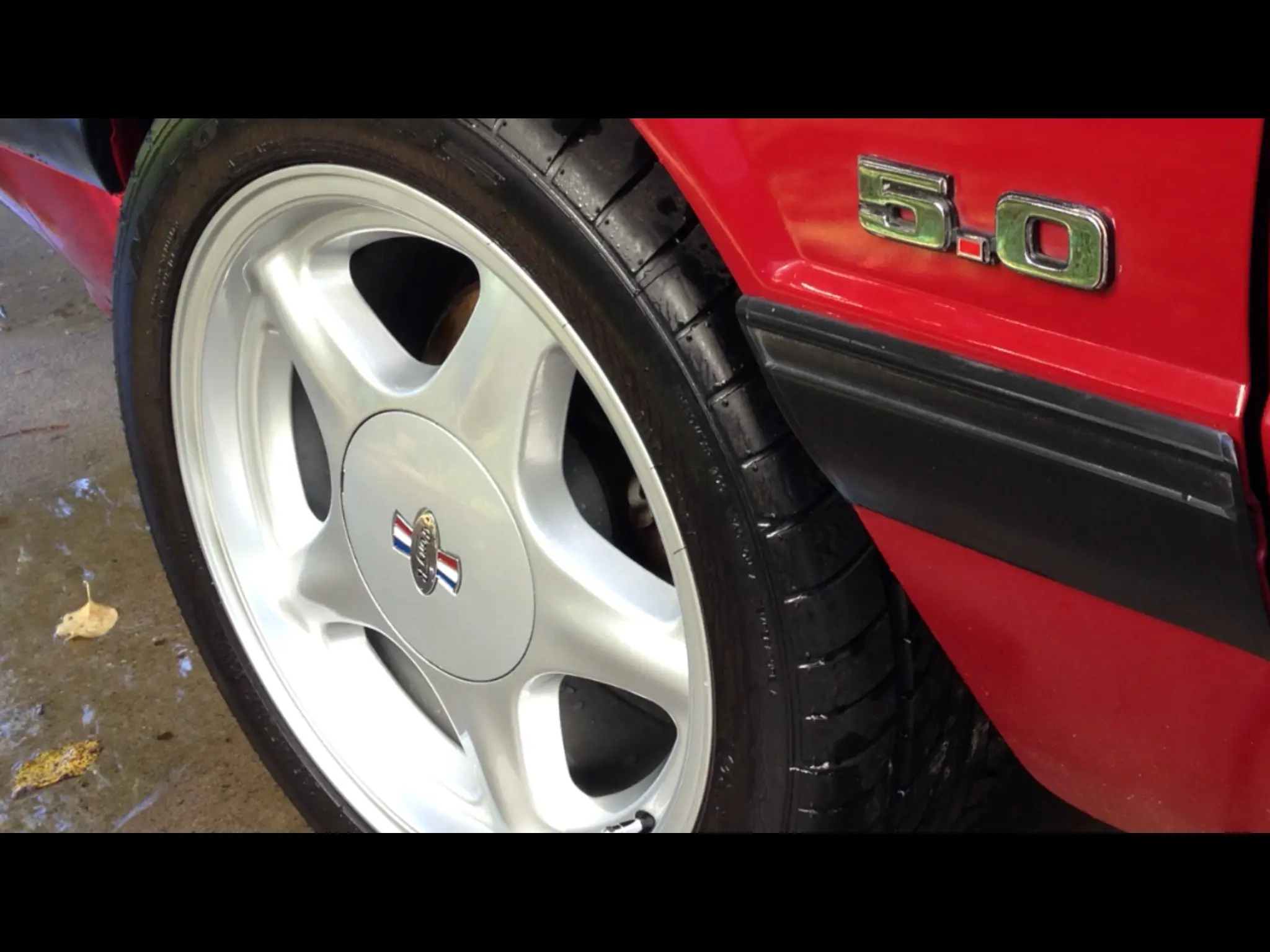

Hello Stangnet! New member here. Been lurking for awhile and figured I'd join and say hello. Two years ago I bought my second fox. It's a 91 notch, formerly an aod car swapped to a t5. Original paint, stock motor, 96,000 miles. Current mods are 17x8 and 17x9 Pony R wheels, BBK shorty headers, off-road H pipe, Mac caback, hurst shifter, 70mm SN95 Maf, and K&N panel filter. I've been doing things here and there to improve drivability and appearance. One thing you'll notice from the pictures is that it has a luggage rack. It really bothers me and I'm dying to remove it. However I have only seen 2 other notches in my life besides mine that have a luggage rack and they were both just pictures online. Has anyone else ever seen one? Is this a rare option or something? It's coming off regardless because it would look so much nicer without it. Just figured I'd ask. I enjoy following all the build threads on here and I hope to lean a lot from you. Thanks guys!

I've seen it and removing it will be a bit of a problem.
Assuming they riveted it on. You'll have to weld up those stinking little holes, smooth it, primer and refinish.
It was just an option is all.
Take a real good look what you might be getting in to first. might be a bigger pita than you want.
Nice car btw.

Thanks! The other option is just to get another deck lid and have that painted to match I guess. It just looks so out of place on a coupe imo.

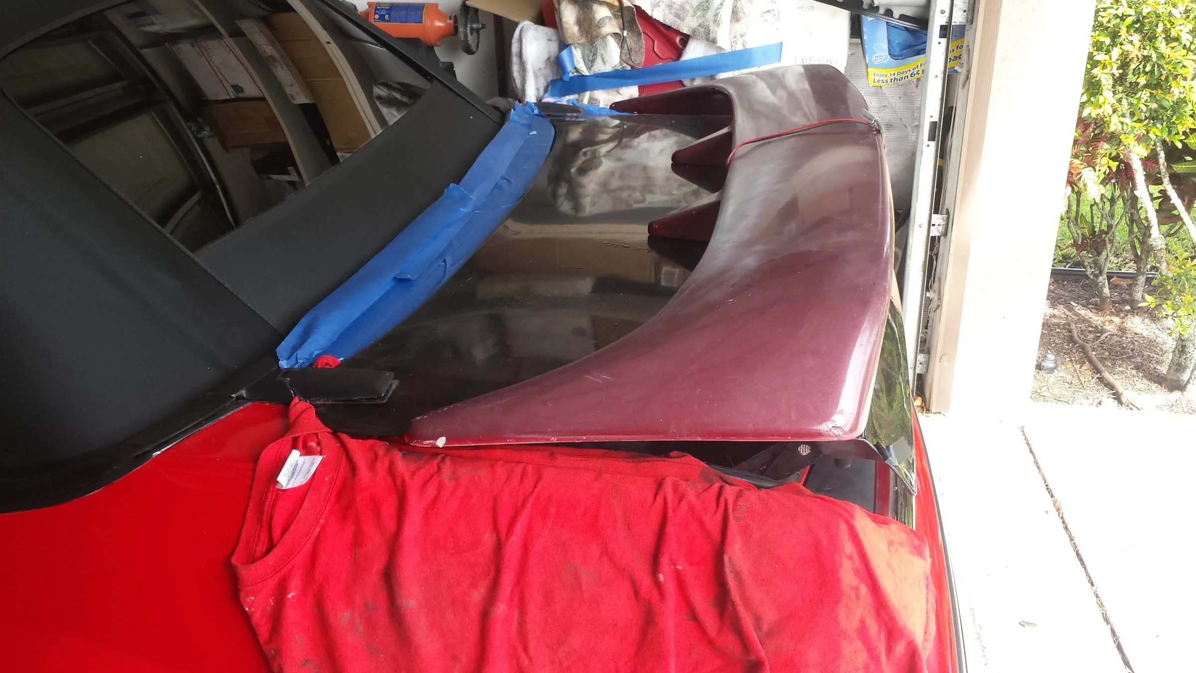

I would get a clean trunk lid vs. trying to weld up all the holes in the existing trunk lid. That's what I am doing now with my car. Waiting to get the trunk lid and wing back from the painter.

Getting a new deck lid would be easiest by far.
They're relatively cheap.

I never knew the coupe could be ordered with a luggage rack. That's a new one for me.
Has anyone in the history of the Fox Mustang ever even used the damn thing to carry luggage? How does it even work? Are there slots to pass a strap into and hold stuff on there?

We actually did, drove to Canada back in 91. Bungie cord x across a suitcase. worked great....
During my build the body shop welded the holes up, no more luggage rack, they did a great job looks perfect! No filler or anything! first we tried an aftermarket lid but those things fit like doo doo.

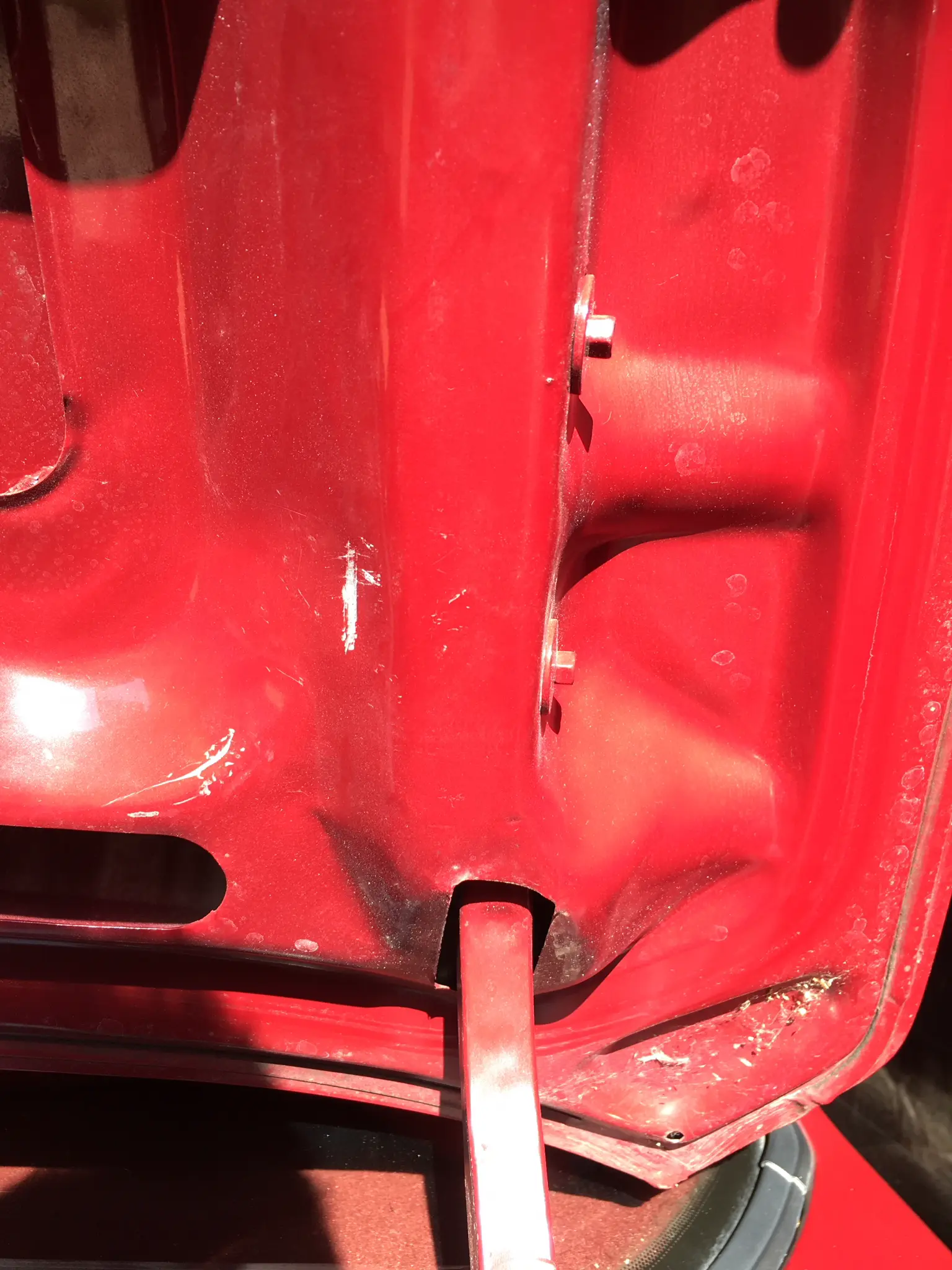

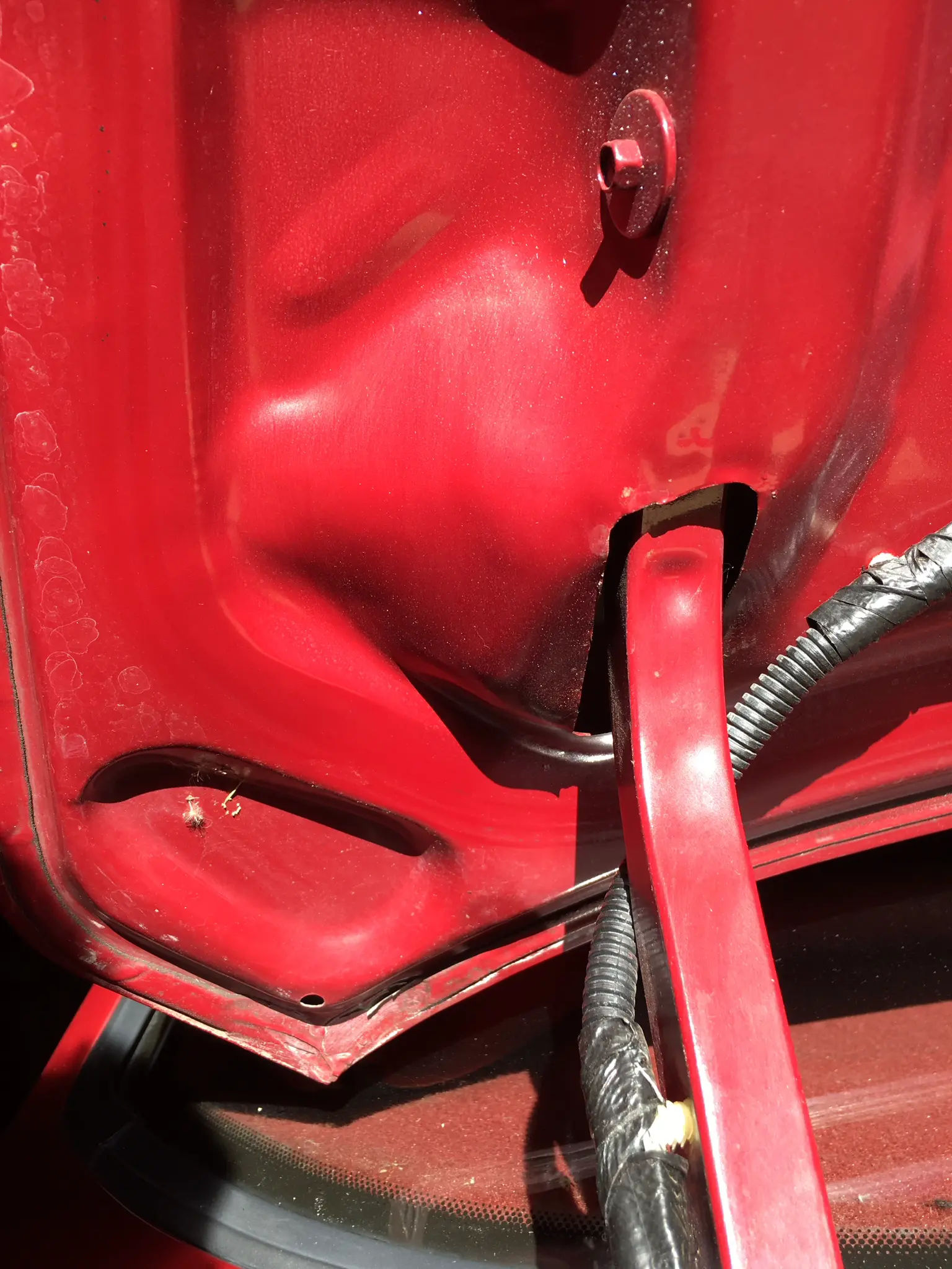

OP when you open the trunk are there bolt holes welded or fillered where the vert exterior hinges mount the lid to car? That would tell you if it was a lid swap or an order/dealer installed option Id think - no holes there then original to the car.....

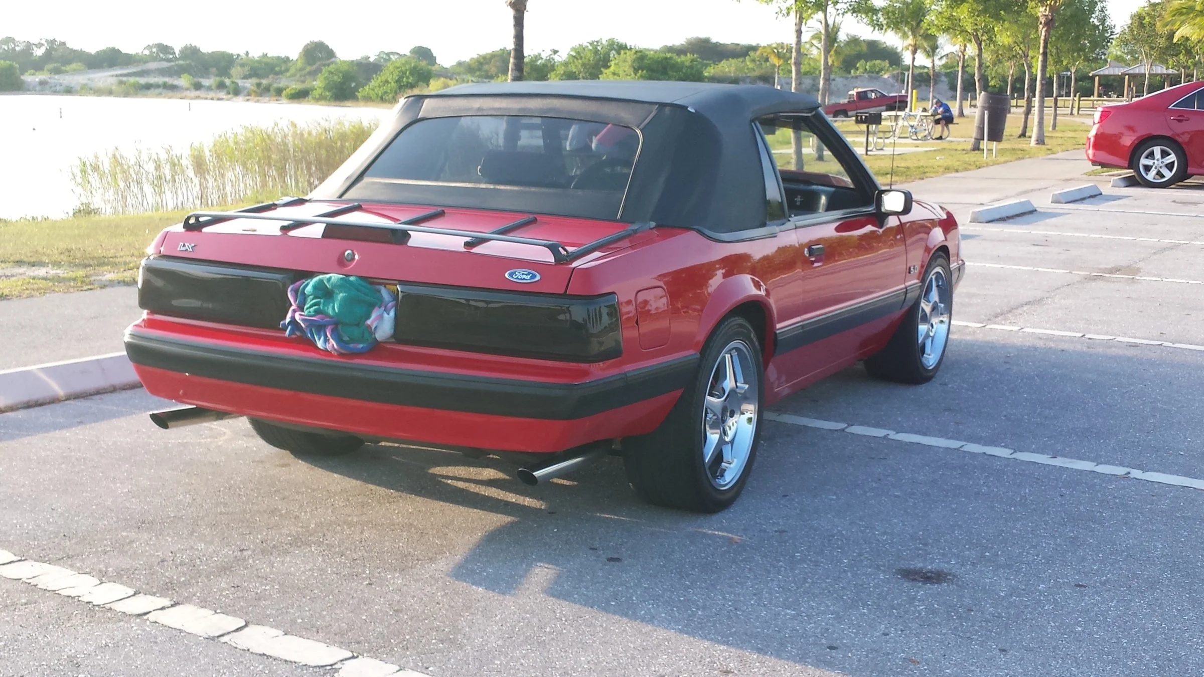

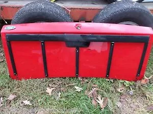

I think it's original.
On the verts, the center bar is shorter to leave room for the 3rd brake light
The bars on his appear to be all equal. Of course, that doesn't mean someone, like myself, would have just found another bar like the two on the side and mounted that instead. Definitely check the underside for welded up holes, especially for the convertible brake light
If that was my car, I'd find a second trunk lid from another north, paint it to match, and install that...saving this lid in a safe place. If you ever go to sell it, put the original back on. That's a clean car, and with Fox mustang prices up, originality is a huge factor. That's a pretty rare, and unique option.

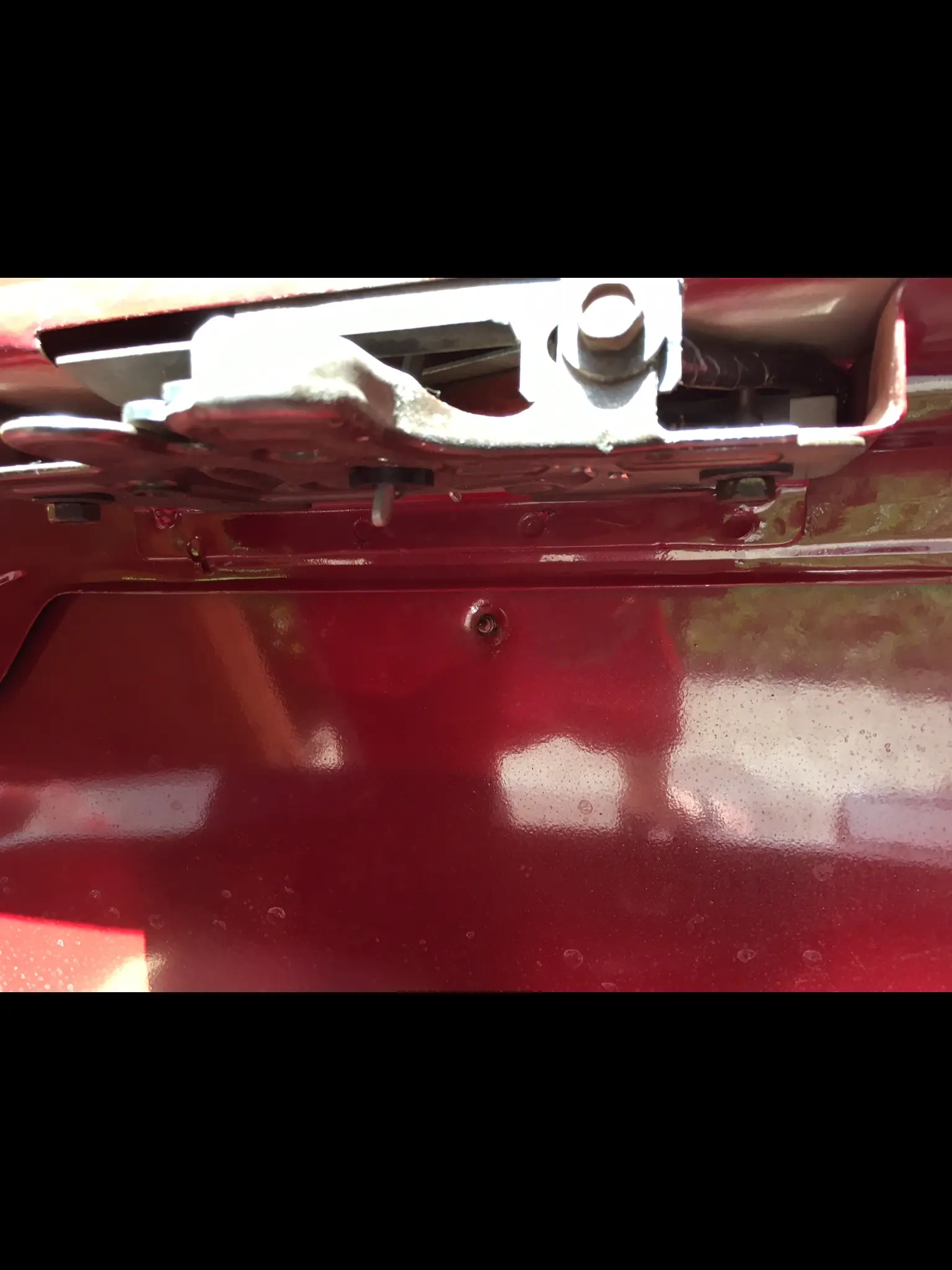

Notch-91
Jul 17, 2016
12
23
Twin Cities
Jul 18, 2016
#11
  • Jul 18, 2016
  • #11
Thanks for the input, guys. I took a look at the underside of the deck lid and it looks pretty factory. I'll try to find another deck lid, hopefully oem. I'm nervous about an aftermarket one.
Looks factory to me, and let me point out one more time, jeez! You have a nice car.
A salvage one won't be impossible to find, though being inquisitive with yard owners helps to locate good finds (trust me on this one).
Good luck brother, be persistent.

Thanks so much for the compliment! Especially from someone with such a nice ride!
I really lucked out with it. I had been casually looking for a clean coupe for about 2 years and I was willing to go a few states away to get one in the right price range. I happened to see the local ad for this one a few days after it posted and pounced on it. Paid $4k. Couldn't be happier!

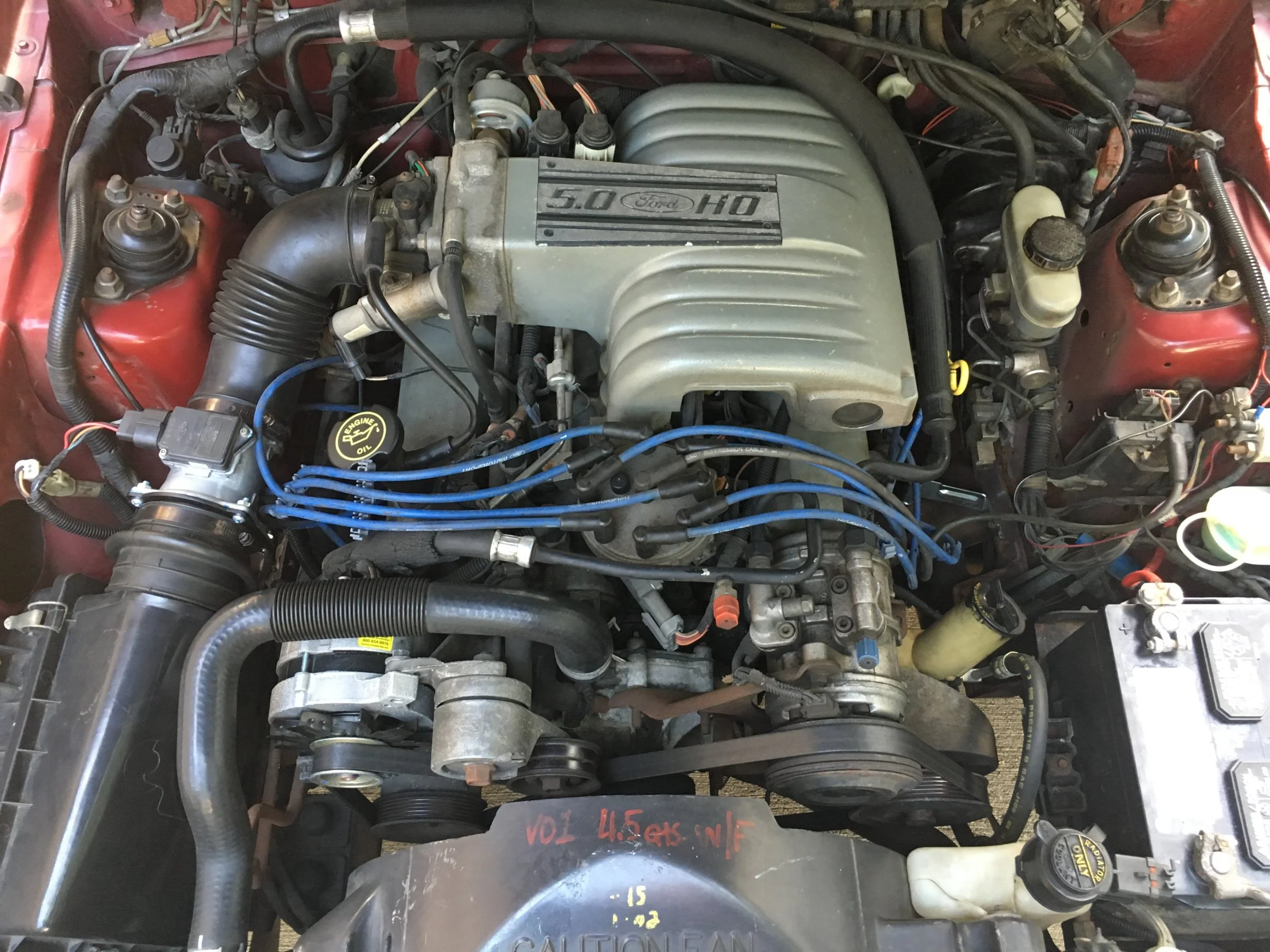

That's a really nice coupe! You got it for 4k? Seems like a good deal! Do you have any other pictures (Under hood, interior)? Would love to see more of your car!

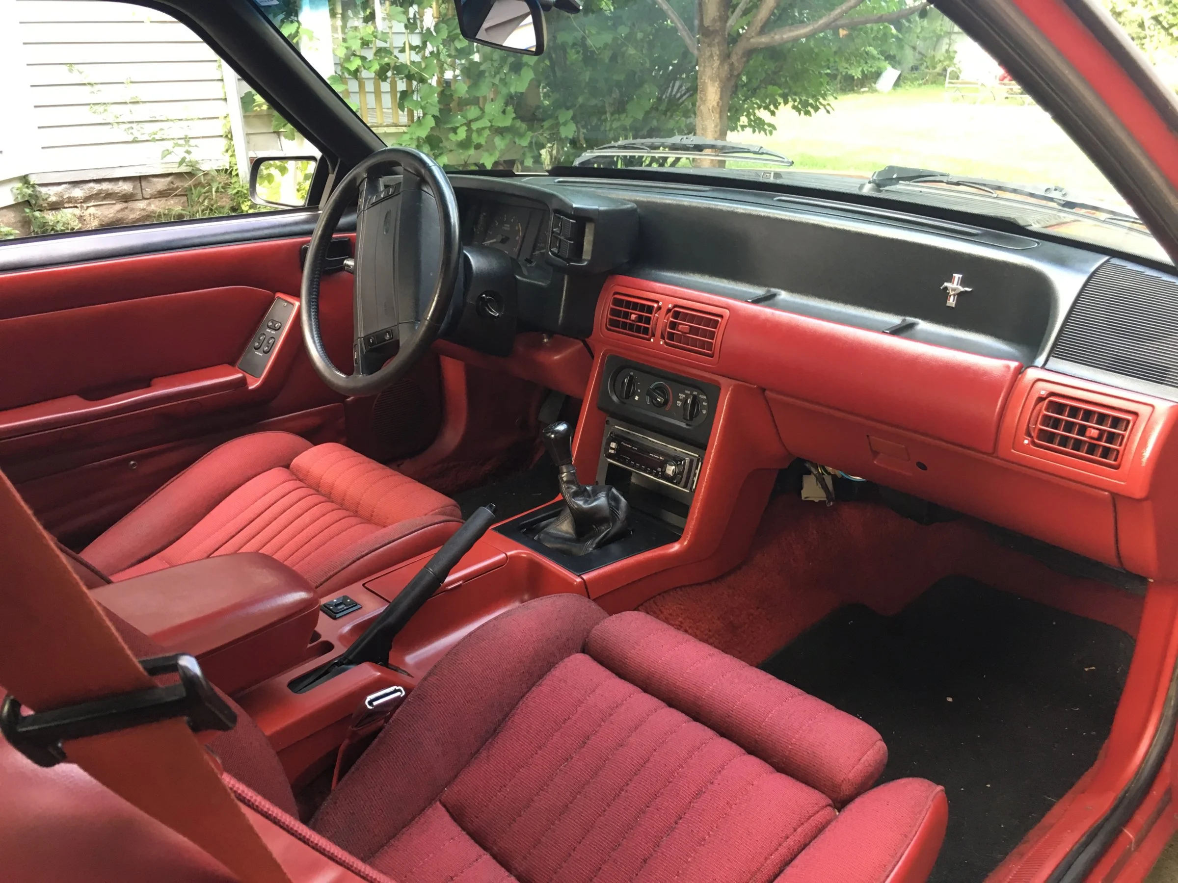

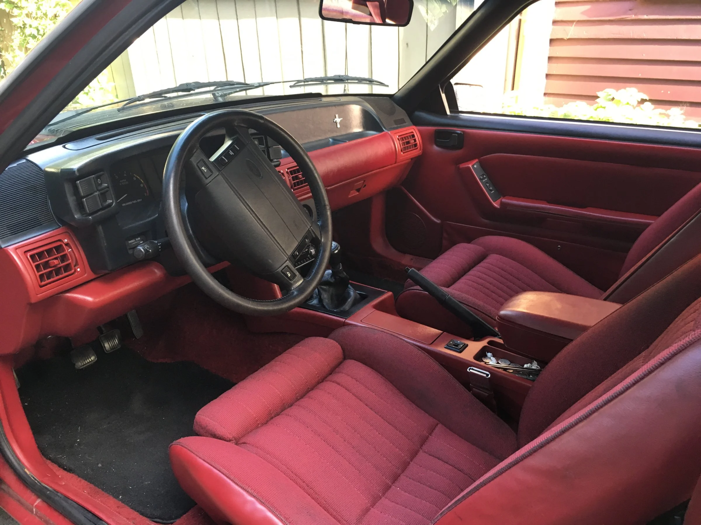

Thanks! I think I was at the right place at the right time and lucked out. It has a lot of little imperfections here and there but it's in really great shape for a 25 year old car in MN. I bought it in July 2014. Today I'd probably pay a lot more. More pics below. Unfortunately, it has red interior. Thankfully it's not full blown p*rno red.
Why unfortunate? It's clean!
I'd take a clean, factory original red interior over a pAinted, dyed, or dirty swapped black interior any day.
With the right mix of parts, they can look really good
Sent from my big ass iPhone 6 using Tapatalk
Reactions: krazedstang, Davedacarpainter and Notch-91
krazedstang
Mar 23, 2009
670
278
104
Streamwood
Jul 21, 2016
#19
  • Jul 21, 2016
  • #19
I love the p%rno red interior! I had it on my 84 1/2 GT350. When that was wrecked I kept the seat in my bedroom. I miss the high school days haha.
