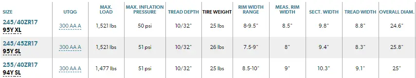

Thanks for the input! Going with the 300tw tires will definitely help the budget stretch a little farther. The used wheels I bought came with 245/45R17s on them so I was able to test fit them. The top of the front left tire rubs so it's a diameter issue, also the clearances elsewhere are tight. The sidewall is close to the strut in the front, and close to the quad shocks in the rear (I already flipped them). I got caster/camber plates installed in the front so I was going to get the alignment done first before I make a final decision, but I'm not sure the 255s would fit
The interesting part is if you look at the spec table the 245/40s look to be a step in between the 245/45s and the 255/40s:
Hopefully you can see that table from Tire Rack, but the tread width is 0.5 inches wider on the 245/40s compared to the 245/45s, and the 255/40s are only an extra 0.3 inches. The section width definitely depends on the measured rim width but the tread width shouldn't.
You're welcome! It's possible the 255s just won't fit. And, there will be much more hassle (and possibly cost) involved in getting them to fit. If the wheels are close on the inside, but not touching, a 1/8 wheel spacer can give you more room. Just check the "poke" on the outside to ensure you don't hit the fender lips.
You will find that tires vary tremendously, and autocrossers spend a lot of time obsessing about the right size, width, etc. I know I have. I looked at the Tire Rack specs when you mentioned the Sumitomos and the difference does seem minimal. I'm just programmed to try to get as much tire on the car as possible. I think you'll be fine with the 245/40s.
But, in the crazy world of autocross: 0.3 + 0.3 = 0.6. Over half an inch more tread width per axle. Not bad for $44, if they fit.
