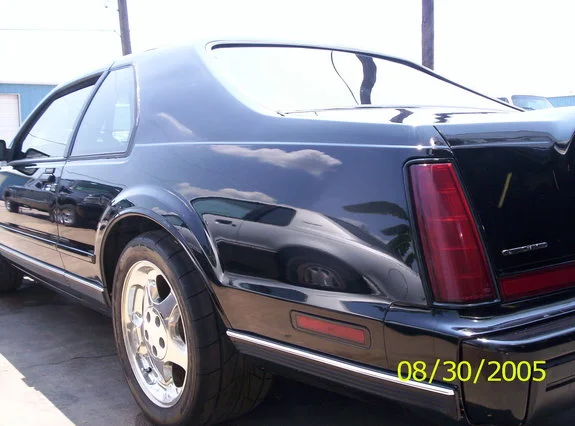

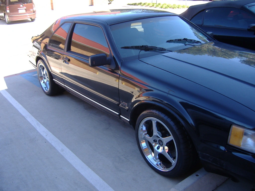

Thanks..gonna try and keep her on bags,I got T-bird swaybar in the front and the addco in the rear so she handles good for what she is. I was wondering if the 93 cobra wheels would fit, can’t seem to find an answer on those particular wheels.

Well lets see: NO
1990 Lincoln Mark VII LSC V8-302cid 5.0L FI VIN E
P225/60R16
Load IndexSpeed Rating
Front Inflation30 psiRear Inflation30 psi
Rim Size7JJRim Dimension16x7
Bolt Pattern5-114.3mmTRQ185-105 ft-lbs
1993 Ford Mustang SVT Cobra V8-302cid 5.0L FI VIN D
P245/45ZR17
Rim Size7.5JJRim Dimension17x7.5
Bolt Pattern4-108mmTRQ185-105 ft-lbs
1993 Ford Mustang SVT Cobra R V8-302cid 5.0L FI VIN D
P245/45ZR17

Well..hell that kinda sucks now doesn't it..always loved thos 93 cobra wheels..only ones I thought might look good on a Mark. I was always so caught up in backspace and tire size you forget the obvious sometimes. I guess my next question is I am looking to pick up a little power,with an intake manifold but I get a little confused with the entire EGR thing some have it inside some out. What is the simplest manifold for a little more torque for my 90 application.

Dont they make 5 lug 93 cobra wheels?
