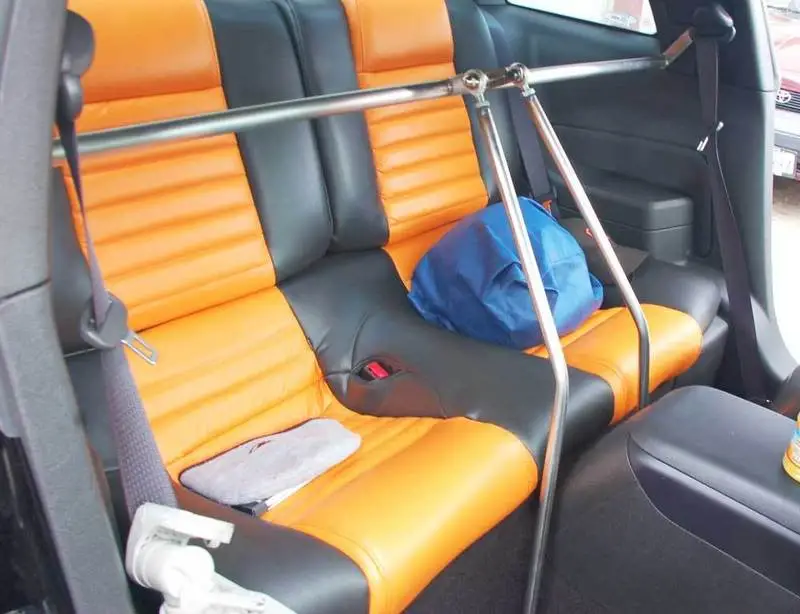

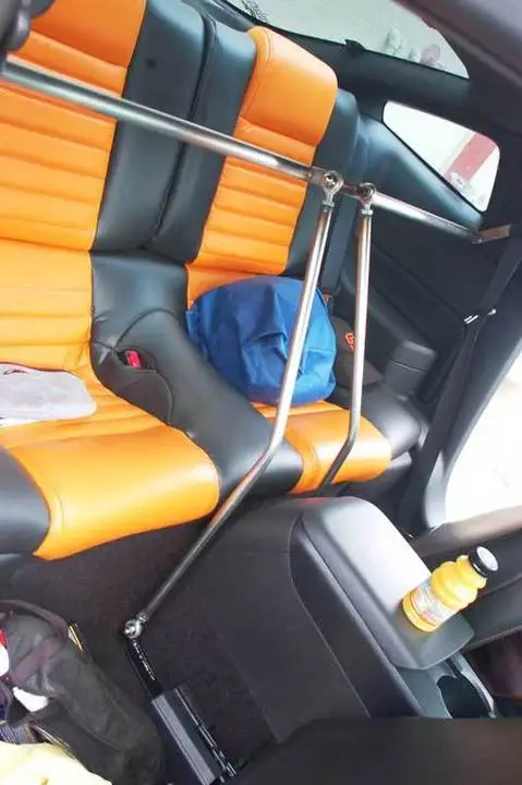

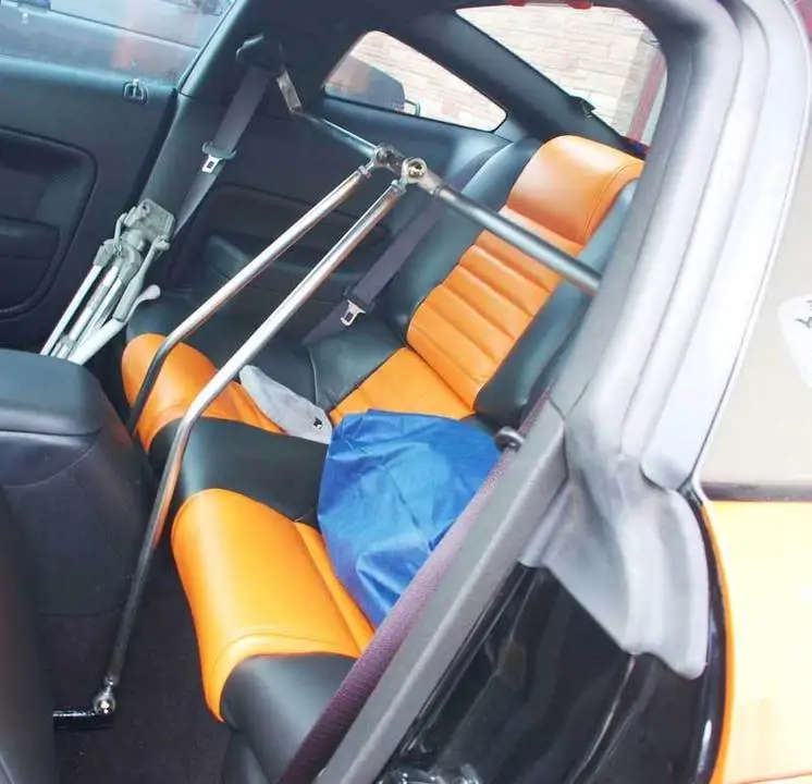

So I just finished my latest mod which is my harness bar so I can mount the shoulder belts for the 4 point harness. The tube that runs across the car is 1 inch round tube stainless and the two bars that run downward are 3/4 in round stainless as well. The bars that are mounted to the B pillar are 1/4 inch stainless flat bar. I ran out of stainless bar stock for the lower brackets that mount to the floor but those are steel. Support bar have spherical ends to all the harness bar to move at least 1 inch higher or lower. Right now they have a brushed look but I am thinking of polishing it all. Let me know what you all think. I did make this at work.

Is that safe ??? Looks pretty good tho.

Yes its safe, alot of other companies sell it for other cars but i didnt find it for ours and i really wanted to make one.

My only concern is the 1/4" stock going from the cross bar to the mounting point. That is the key structural component. It doesn't matter how big the tubes are, it only matters how they are attached. Also,are the floor mounts just bolted into the floor? Or do the have a nice rigid mount, like large plates or welded to a fram component?
It looks like nice work, but the devil is in the details. I just hope you did the right thing from the start, to save you from more headaches later.....
