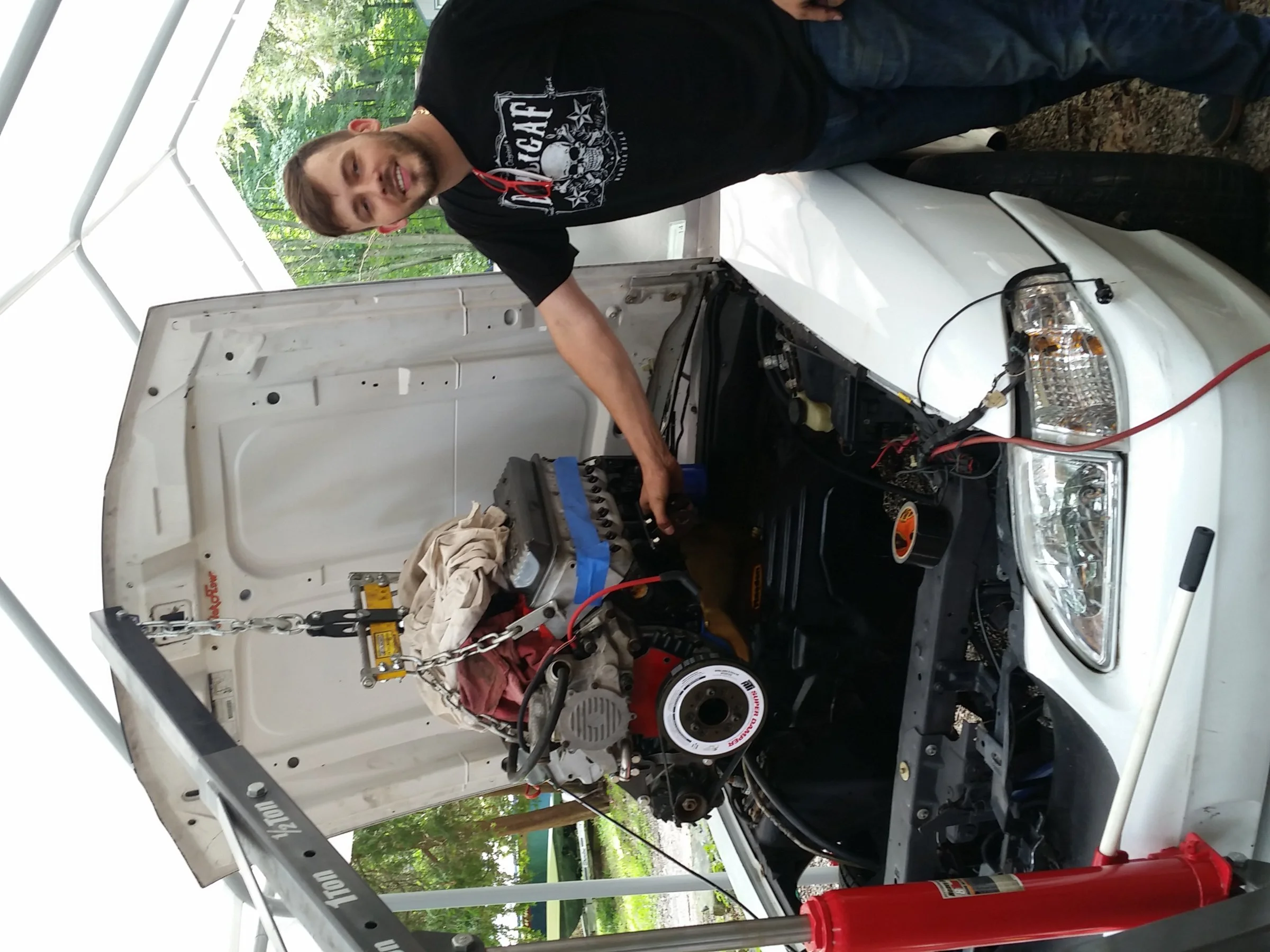

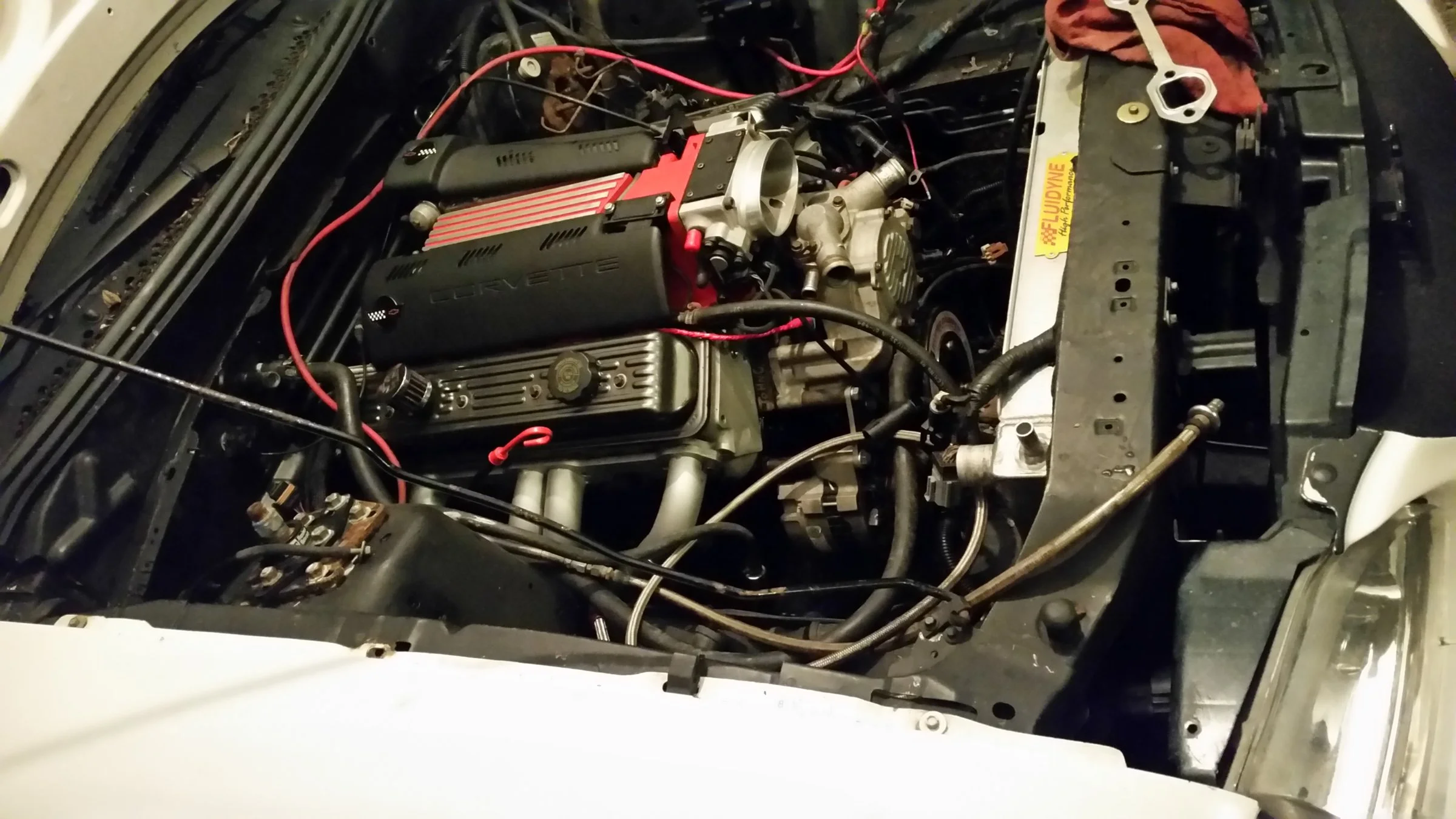

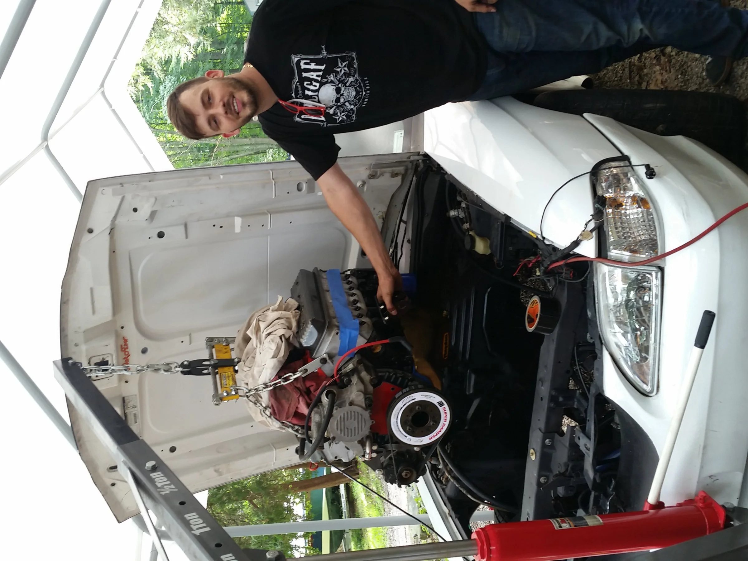

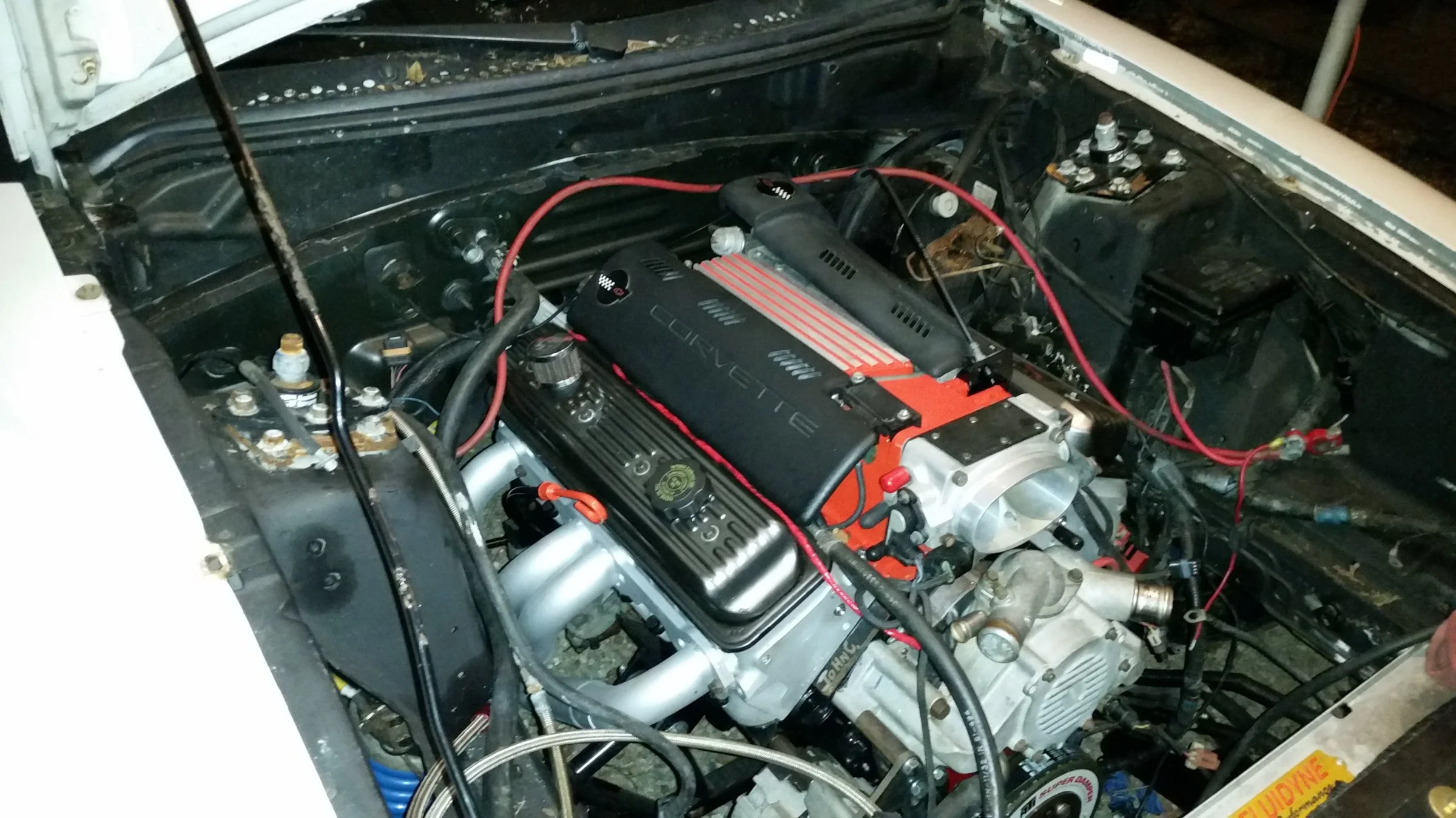

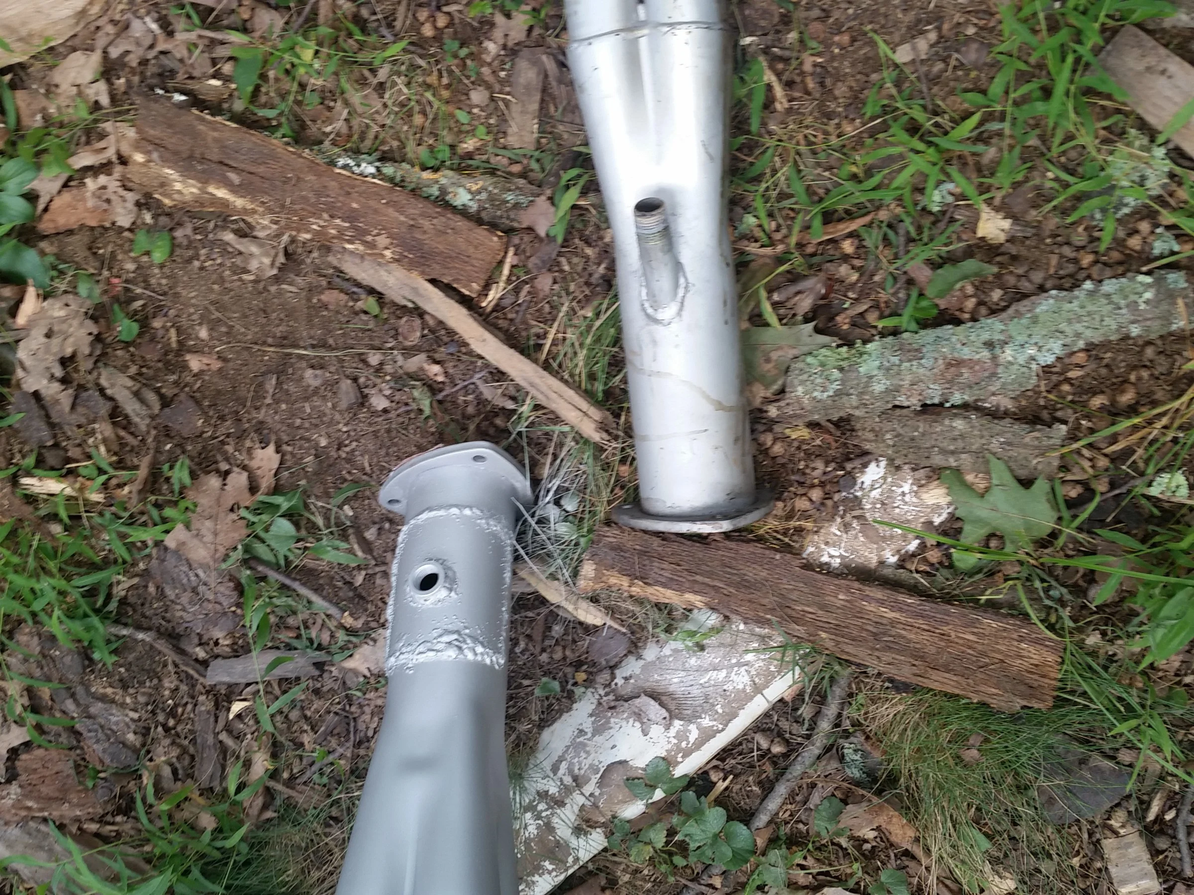

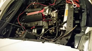

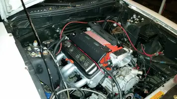

So, I put the aje k member in place with the spring perches without a hitch and reused the terminator a arms. Got my motor mounts on the engine, after a little cutting to clearance the lt1 knock sensor, and lowered the motor in. I ended up needing clearance on the passenger side a arm for the header, like I anticipated, and ground away at the flat protrusions on either side, and I cleared the headers... Headers I bought had an evac system welded in and no o2 sensor bungs, which I fixed although I'm not the best welder. I cut holes around the evac tubes to remove them, cut a 3 inch segment of 3 inch pipe, and welded it to each collector, drilled for and welded the o2 bung in place on each header, after mocking up and marking the location desired on each header. The 3 inch x pipe I bought from the fox body fit with longer rubber hangers. So far, it's a pretty easy swap. I'm having a lot of fun with wiring it up, and I am going to have more fun getting the lt1 t56 situated. I'm probably going to remove the clutch quadrant from the clutch axle and pivot that arm so that it rotates towards the firewall, and use that to push a master cylinder rod... I'll figure it out and post my solution... I wish I bought a mustang as a kid, so easy to work on compared to the f bodies I am used to.

I forgot to mention, I put a quantum fuel pickup with a 340lph pump and an fittings in place of the stock fuel basket, which required a bit of banging the tank to make room for the 8AN supply line. I also needed to put a good size dent under the car to make room for the 3 bolt flanges I welded to my dynatech headers.... My key take away so far is this... Dynatech swap headers will work with stock style A arms, with a bit of clearancing done to the passenger side A arm, and the AJE LT1 mounts need to be chopped up a bit in order to work properly with a knock sensor.
