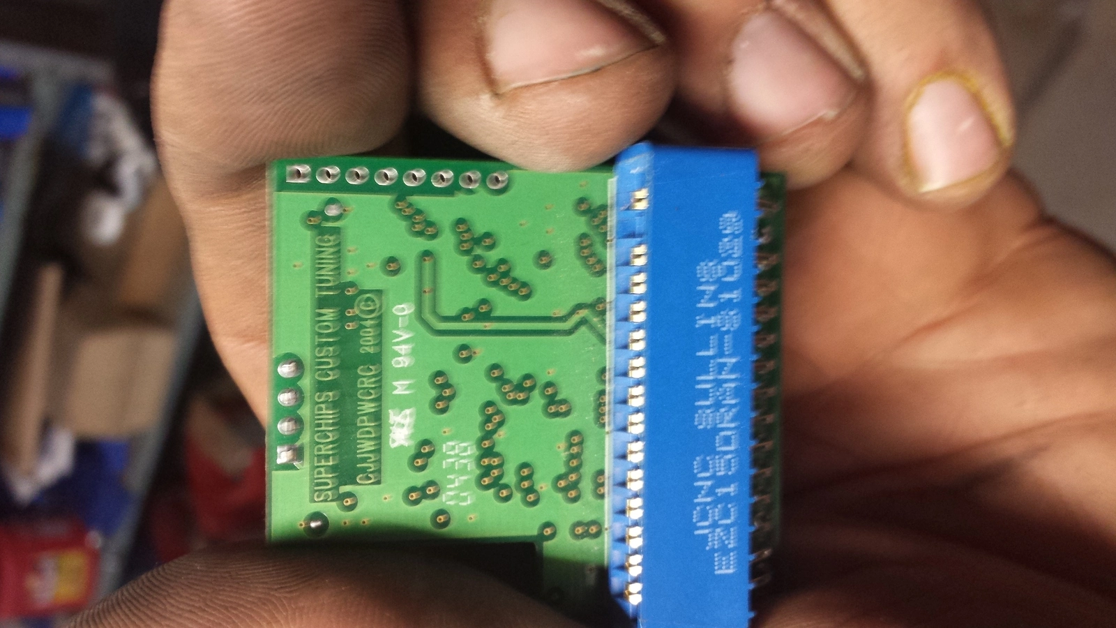

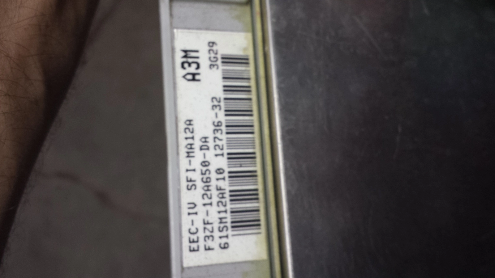

The computer is under the passenger side kick panel in the front. Pop it out, the chip is on the opposite side of the plug so you will have to remove the computer to get to it. Pretty sure it's a 10mm or 8mm bolt to get the plug off the computer, it does not just pull off. Se if there are any markings on the chip. If not take some pics of it. Someone might recognize it.
I uploaded a pic of the pcm and of the chip. We'll see if this worked.
I have been doing some researching on tuning myself. Haven't done it yet, but i do have a decent knowledge. From what i have read, i am going to go the rout of buying a SCT chip with a selector for multiple tunes. You can buy a chip with some tunes one it, or buy a blank one and go get it flashed at a speed shop. Most all speed shops tune the SCT chips. There are other chips you can get, but none are as popular as the SCT. If you get one, you will need to tell the guy writing your tune, exactly what is done to the car. They need to know everything, and i mean everything. You will be able to get a tune for pump gas, racing gas or whatever you want to use. YOU have to be careful tho, if you are in a race tune and use crappy gas, the result could be bad. But i would defiantly suggest the SCT because they are very popular. Goodluck
