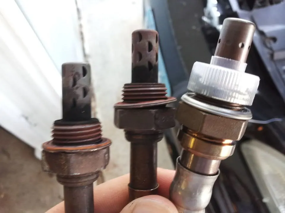

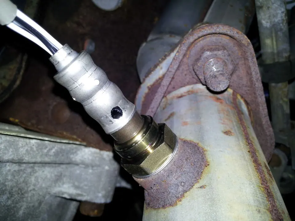

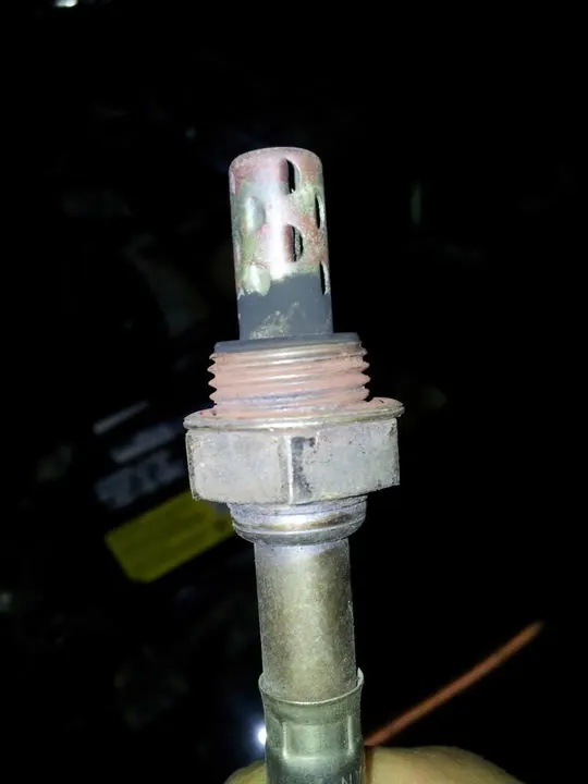

Just thought that I'd post some pictures I took while installing some new o2 sensors.
So far so good. I took it on a little drive after the install and no CEL comes on now. Hopefully, this solved my issues.

What were the issues that were solved?

Were you getting lean codes?

Yes I was getting lean codes. 176 for KOEO and 136 for KOER.

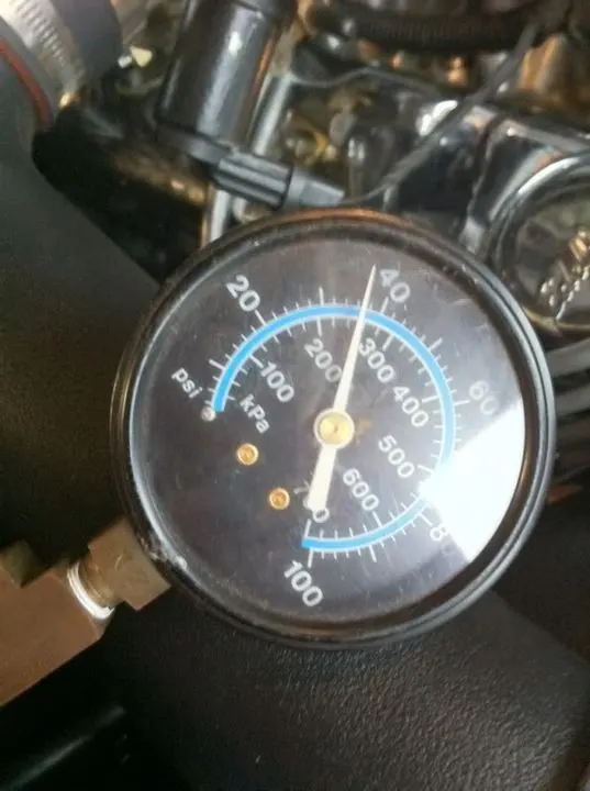

That's why I asked, from the pictures they are white colored which means lean. If they were caked black you will get codes for a rich condition. If you have an adjustable fuel pressure regulator you can turn up the fuel pressure a few psi. Should take care of your lean condition. Have you checked your fuel pressure?
Set to 38psi. I bet yours is lower than this.

No I have not. Does this require an adjustable fpr to do? I also what to check my timing to make sure it is set right.

Yes, you'll need adjustable fuel pressure regulator. Check to see where it's at first. The schrader valve in on the fuel rail. You'll need a timing light to check timing. I'd set it to 12 degrees. Do you know how to do this?
