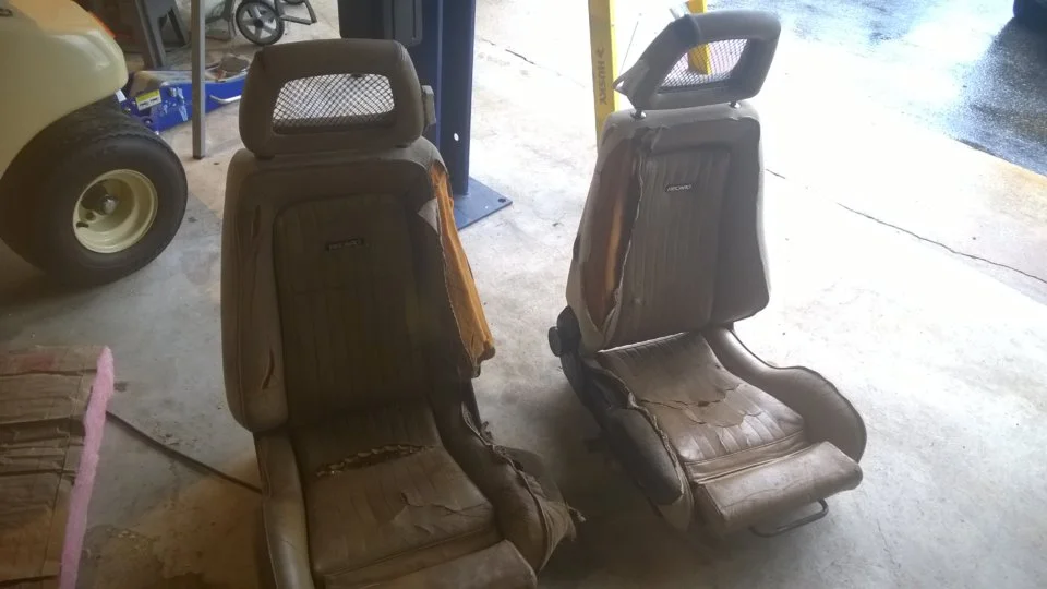

So I saw some 80's recaro edition trans am seats on craigs, beat to hell. Recaro lx's were used in a lot of cars, including 79 pace cars. So I went and bought them.

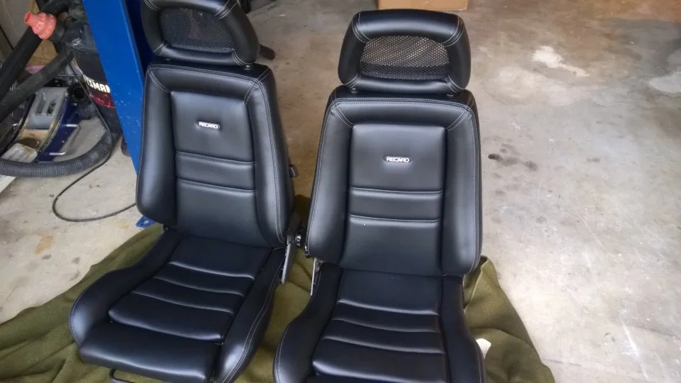

Sent them out and had them redone. Wasn't my cheapest project, but I did only go 30-40% over budget, so that's a plus. German vinyl which is used in many bmw's. The price for the real stuff (I can't tell the difference) was astronomical.

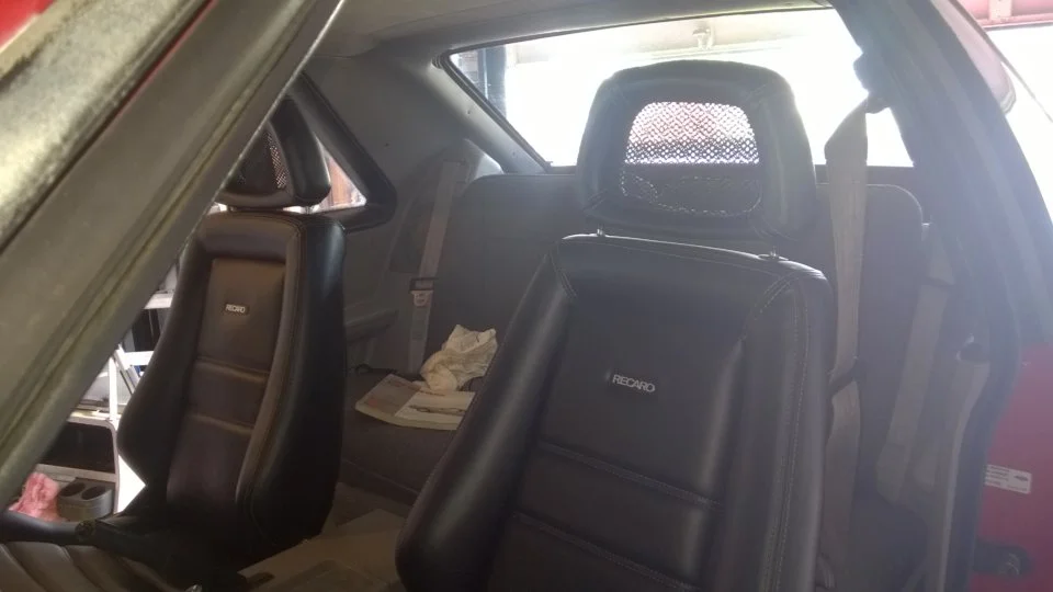

Wedge brackets and recaro sliders. I used recaro pace car adapters, but I was too tall and the thigh bolsters are too thick causing my legs to be too close to the steering wheel (i'm 6'1). The recaro sliders let these seats go wayyyyyy back and keep the seats much lower. Nice change. Much more comfortable than my 25 year old stockers and much more supportive.

Before and after.
Thanks guys.

The good news is that almost all recaro lx seats will fit in a fox with the right brackets and sliders.

I expected a lot obviously, look how they originally looked, but since there are so many variations, I truly didn't know what I was getting back in the mail.
I'd call what this guy does, art.

The key do doing a set of these is finding them in the worst condition possible. Because if the look, material or color doesn't work for you, they have to be redone completely regardless. So if you were to say find a $500 set in decent condition wrong color, they aren't any better than a set for $200 that are destroyed. A lot of fair condition sets out there, but the foreign patterns don't exactly go in a fox.
