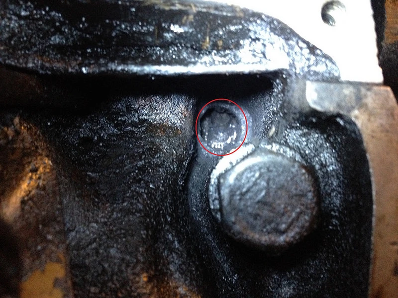

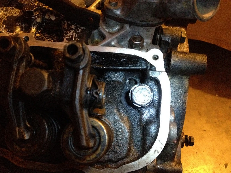

Hello all! I picked up a 1974 MII project that someone else wasn't going to finish, and I am cleaning up the 2.8L that came with.
After pulling the valve covers and finding some 'significant' build-up of oil/dirt, I began to clear out the oil runners in the head. One side dumps into a pushrod hole, but the other side was filled and clogged.
I dug it out, but bottomed out at the block. The hole goes a bit sideways, and appears to have a slot in one side. All I can see is a manifold bolt in there...
Should it be clear for oil to flow back into the pan? Is it worth pulling the heads to make sure it is clear?

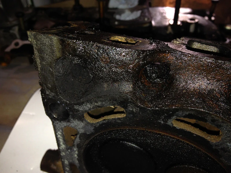

Any time I'm dealing with an engine that has been sludged, I always prefer to tear it down to at least the short block for cleaning.
The pictures you've posted don't make things look that bad, but I have no idea how much cleaning you've done.

I was thinking button it up and run until it croaked and put in a late model engine/trans combo. It was a runner, but I do not want an oil flow issue ending it's life early. It's pretty cruddy, and I may as well since it's on the stand.
If I pull them, they'll go in for seats, guides and springs.
I also don't have experience tearing down or rebuilding the 2.8, but generally the oil return holes are toward the bottom of the heads since oil will flow downhill. I dunno what this hole is really meant to do, something for crankcase pressure maybe?

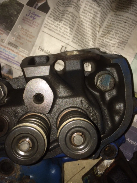

I have my 2.8 tore down at the moment.
I only have the heads here at the moment as the block is at the machine shop.
Here's what mine looks like.
Definitely clear.
And I haven't touched or cleaned this up at all.
