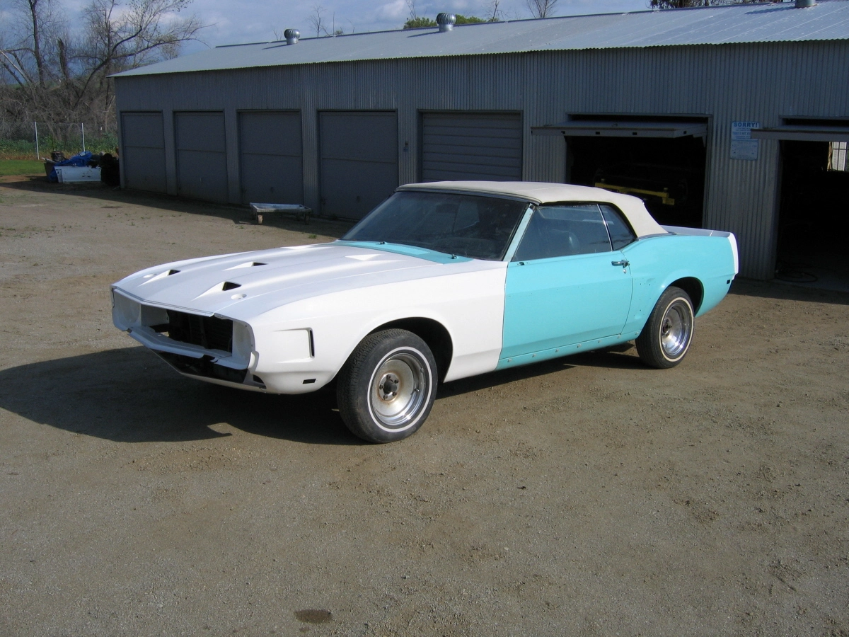

:stick: just a couple of this could be you pics to make you drool

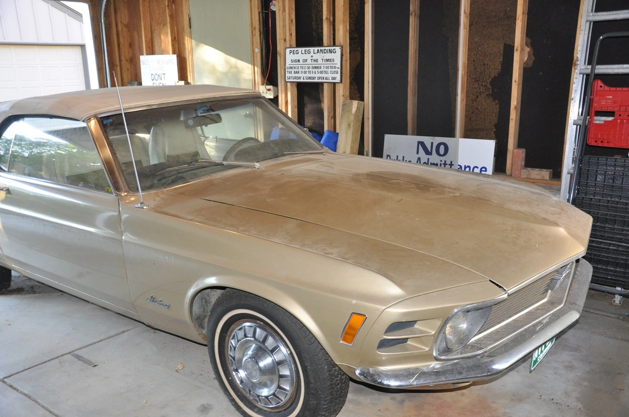

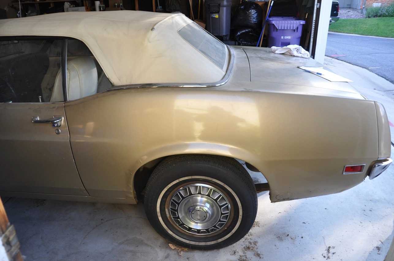

my .02 sense....

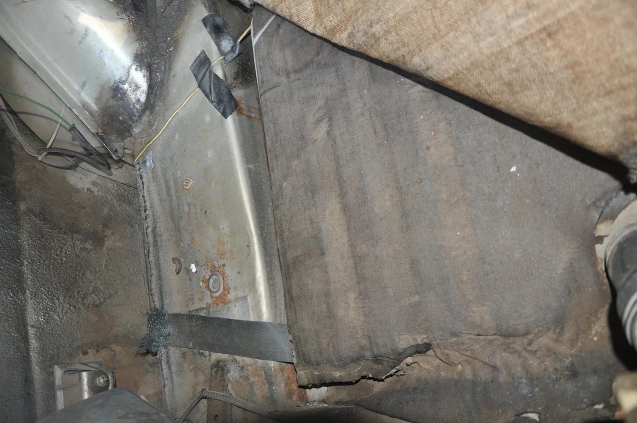

oh you have a very nice start, is that sunlit gold? find a body shop that will butt weld the patch panels in nothing looks worse than over laped panels,or holes drilled and bondo squirting through like spaghetti especially inside the trunk, all the lines look good every thing fits well, you got a keeper

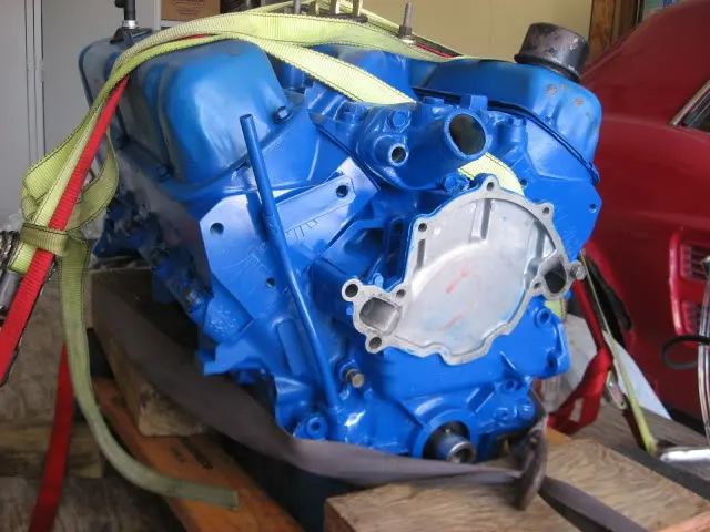

Just getting back to it, really busy work schedule lately. I have a week of rest so back on the project. I have the motor and tranny out, sending it out to the shop next week for inspection and work.
The transmission is a C4, I mostly plan on short trips around town or some cruise nights. I was orignally thinking of just doing the valve job but decided to get it all done at once. with 240000 miles, I feel more confortable with a complete rebuild. Money isnt really an issue, I will get a good price break from my frinds shop. I squirelled some cash away before for a project car and will use it for this. I plan on getting the bodywork taken care of later in the year.

horse sence, the paint color is Medium Gold Metallic /s/, that is what is listed on the windowsticker

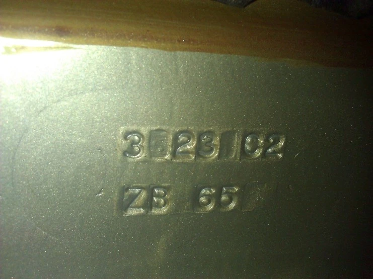

I found these numbers stamped into my trunk deck lid 3 23 c2 zb 65 any ideas?

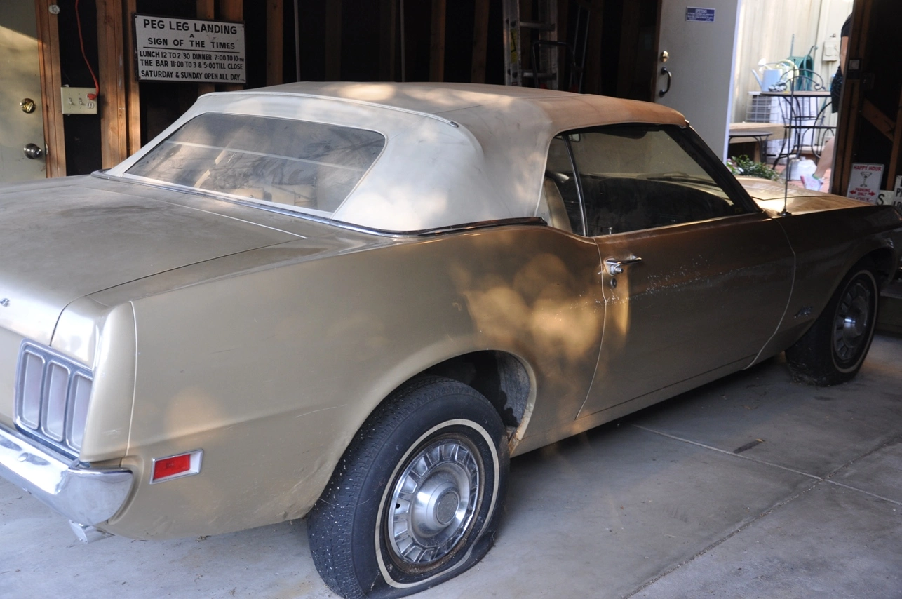

@ The Dude, thanks, Im really bummed at that flat, that was OEM air in that tire :cry:
nice ,had a 70 that was sunlit gold , no clue on the trunk #s
