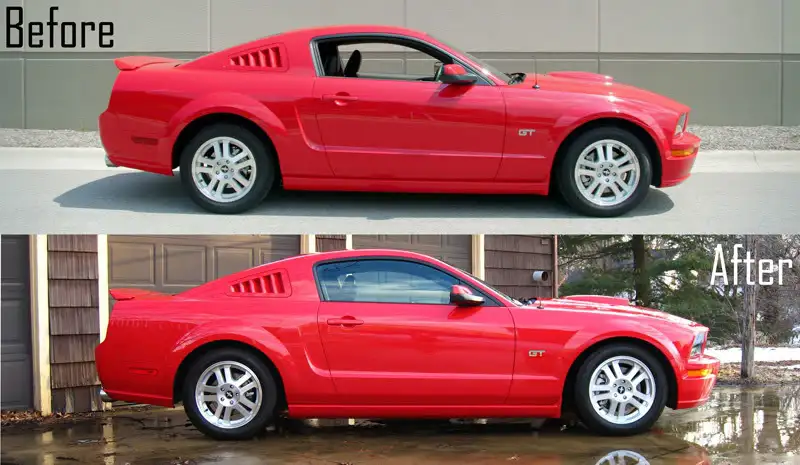

Yeah, that's not going to help. I posted this picture before, and it still wasn't enough of a noticeable difference to him.

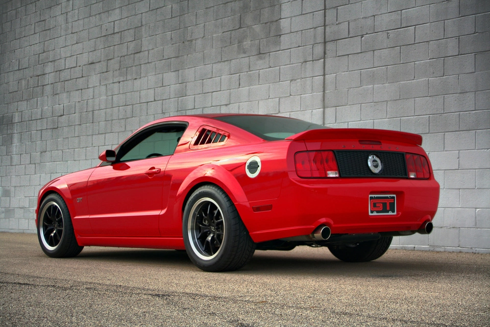

From the factory, these cars have about a .3-.5" or so rake. The Eibach Pro Kit removes .2" of that rake. To further get rid of the rake, I went with taller tires out back. If you look at my comparison picture, you'll notice there's more gap out back (also the springs had not settled, that was 20 minutes after lowering). Now if you look at this picture, the gap is the same, but I'm running a taller tire in the back.

I am running the same size rim/tire front and back.
I am guessing that must be it! I would go with larger tires out back, but my tires are only like a month or so old!
I just wanted to make sure it wasnt only me!
