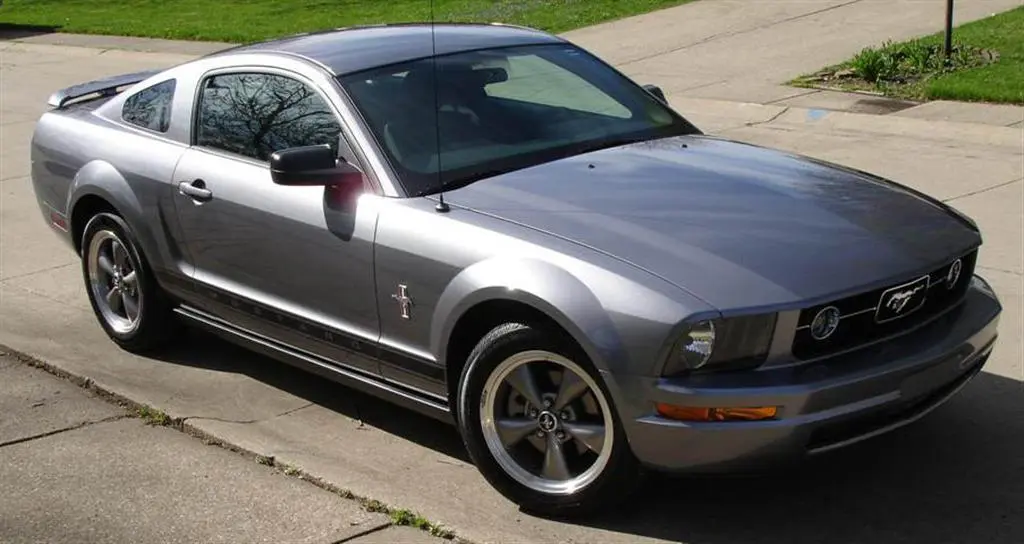

P.S. That would be my 2006 Mustang V6 with the pony package. :D
