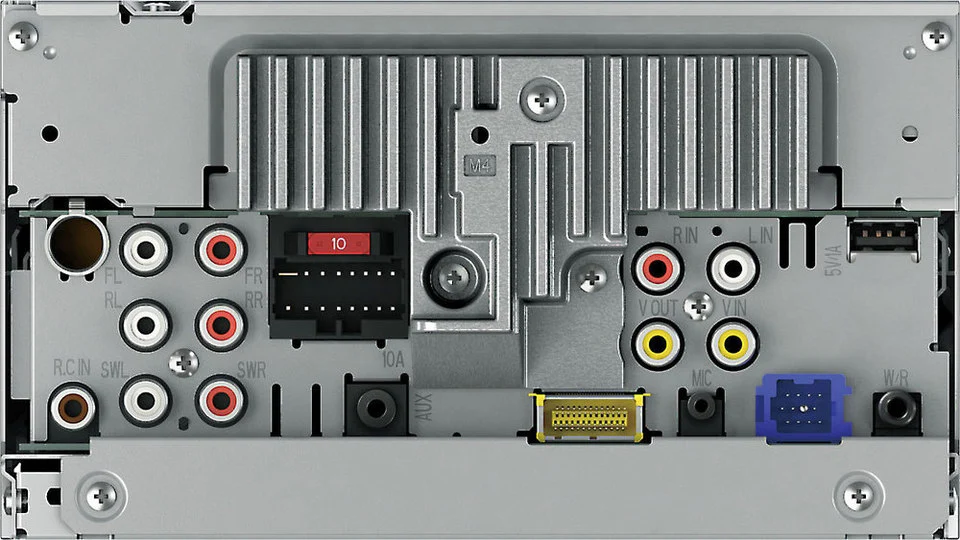

My next question is regarding the 2nd piece of the wiring harness they (Crutchfield) provided. It's the smaller of the 2 connections and has 2 RCA jacks and 2 blue wires coming out of it. It's unclear whether I need this for the factory Mach 460 amps to function. Any (more) advice?
Here is a pic of the wiring harness...again, I am talking about the smaller of the two...the one with 2 RCA jacks. If I do have to plug this into the car's existing harness and into the stereo, what do I do with the blue wires?
DISREGARD - issue resolved. A quick call to Crutchfield told me that the harness connects to the SWL and SWR RCA jacks, and the blue wires tie into the blue/ white striped wire from the Pioneer harness. I'm now rockin'!
