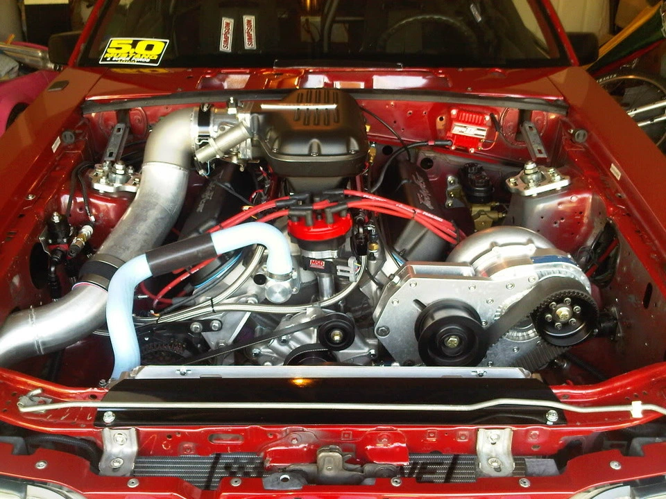

That's the route I went. (stroked 351)
What water pump set up do you have on there? Is that so the pump flows counter clock wise? I ask because Im in the process of changing the water pump set up I have because I think the previous owner has the rotation wrong and the cars over heating. would that work on a 302 based set up?
On cars with a serpentine belt set up, the water pump is supposed to spin counter-clockwise. If not serpentine, it's supposed to rotate clock-wise. The serpentine style water pumps are aluminum and the non-serpentine ones are steel(if I'm not mistaken). Find whatever style your engine is SUPPOSED to have and put that on there (if it doesn't already have it)
Also, there's many reasons for over heating. Bad fan clutch, stuck closed thermostat, bad water pump, even the radiator cap not holding pressure.
Edit: this was in reply to Old Skooler
Yeah I know about the standard and reverse rotation. I'm actually changing out the radiator and electric fan set up now which I feel is contributing to the problem. This is a long story that involves an idiot PO. I was wondering about your water pump with the additional pulley to make it a reverse rotation (I'm assuming). That's exactly what I need right now my water pump is spinning clock wise. I don't have a/c or power steering so I'm just looking for ideas.
I have the reverse rotation Edelbrock water pump. The standard EFI 302 HO water pump is reverse rotation as well. IIRC, it may actually be the same Edelbrock part number.
