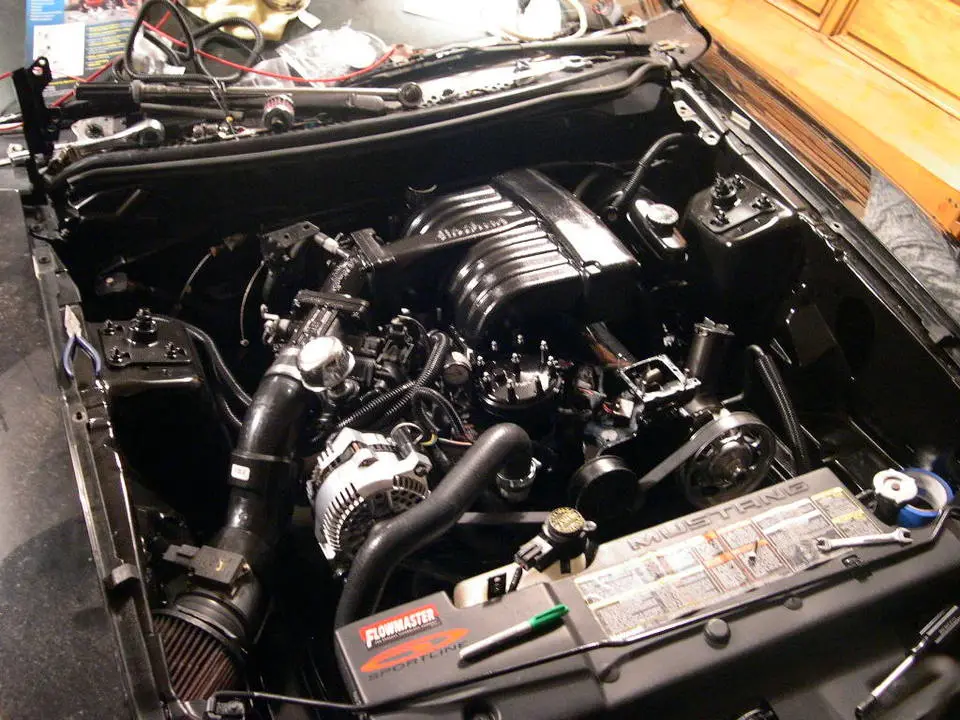

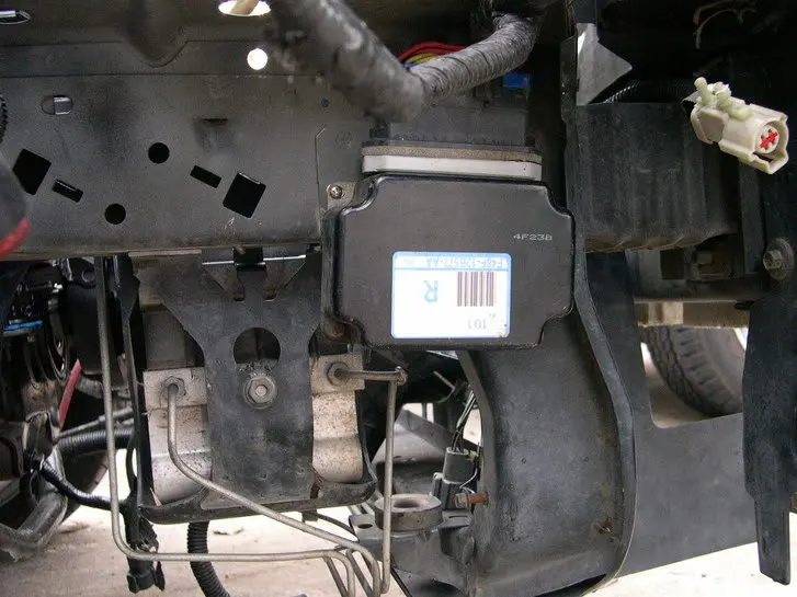

You have more than enough to move the ccrm. Then route your fan lines around behind the headlight and then behind the overflow, then to the fan. It keeps it clean and you don't see any of the fan wiring. Then you can cut the braket so you don't see it under the plastic radiator cover. Heres a few pics.
