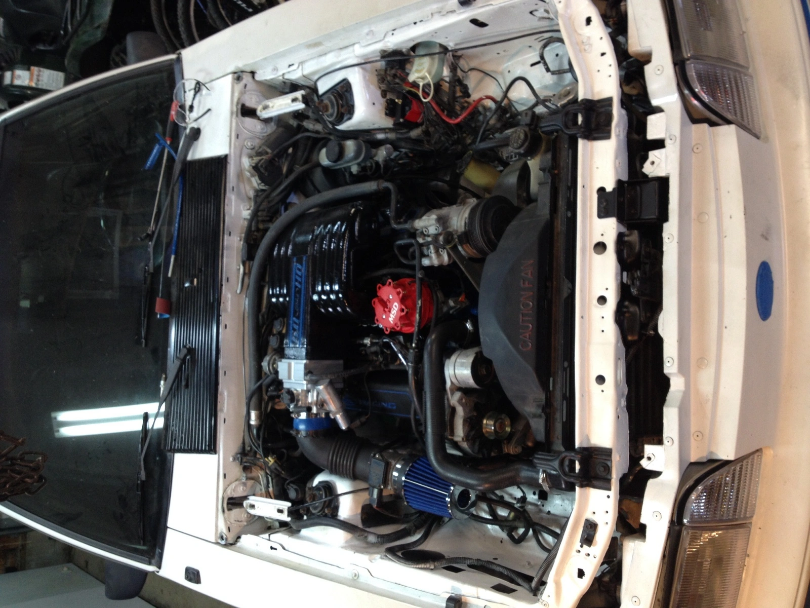

My first EFI rebuild just curious on thoughts about a no idle I have. First its a 1990 Mustang 5.0. t5, 8.8 upgraded from 3.08 to 4.10, engine- .40 over, .01 shaved deck, .510 roller cam, ported gt40 heads, new valves and dual springs 190I, 160E, ported intake, port matched upper to lower intake and exhaust to 1 5/8 header, 70mm t body and intake(intake tube modified to fit, 24lb injectors, MSD ignition w/9.0 wires, motorcraft platinum plugs, 1.6 roller rockers set to resistance on push rod then 1/2 turn and locked down. 3/4" intake spacer portmatched to clear tall rocker covers. runs and sounds good(besides a rocker arm tick) over 2000 rpm. release pedal or linkage and she stalls. idle air is new, TP is new and set at .92-.93v but the MAF is stock for a 55mm intake and 19lb injectors. Lets hear some thoughts on what is causing the no idle out of my 2 choices or something else I haven't thought of.

Unless you gave us bad info, this is a big problem. You can't run 24# injectors with a MAF setup for 19# injectors. Get an aftermarket MAF calibrated for @24#
All info is correct. I just moved TP sensor to 1.0volt and problem remains. I thought cpu would relearn the overage of flow but after reading a lot of posts I am also thinking the MAF needs to be upgraded. Seems to be a common issue with injector upgrades.
Unless you get a certain type of tune that eliminates your need to use a MAF, you have to calibrate the MAF to your specific size injectors or it'll run like crap. I have a ProFlow (ProM) and most people recommend them as well. You want it to be bigger than your throttle body, so 75mm would be good for you.

Thanks for the Tip. Do you know of a decent place to purchase? I don't want some china pos off ebay for $10. LOL
Fix you MAF problems first: get a quality MAF that is matched to the 24lb injectors.
The OEM Ford MAFs are not calibrated to injector size. The injector sizing is done in the computer’s internal programming. Aftermarket MAF’s “lie” to the computer in an attempt to fool the computer into changing the injector pulse on timing to match the increased airflow.

I love the "NO NO" picture about the cone filter and then you look at my engine picture where i set it up for the picture and it looks the same. LOL mine is NOT set up like that it actually is in the fender area to get cooler air. Lots of good tips on that page. I didnt know about the Fusible link in the O2 wires. Thanks!

Like I said, fix the MAF problems first. A good Pro-M MAF will get the mismatch fixed.

Pro M 75MM MAF for 24lb ers and call it a day. For the Rockers, what do the instructions for the ones you have say. Are they high rev anti pump or stock lifters. Sometimes you need to have them looser, sometimes tighter. Depends on the cam, lifters, and manufacturer. On that video, those rockers did not have poly locks- do yours?
